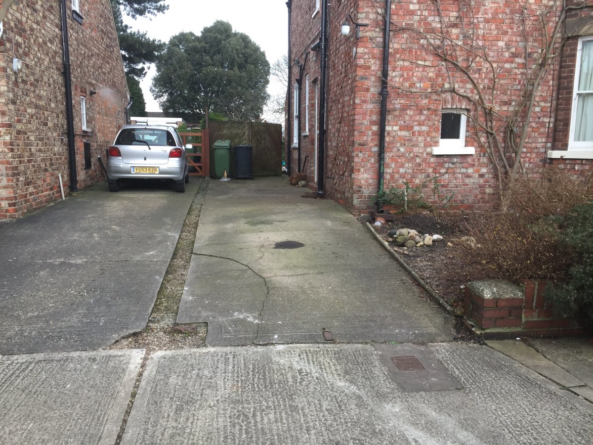

Do i need planning to replace my concrete drive with a block paved drive.
The block paving will not be porous, just std BP.
I understand this type of change is not being enforced by councils.
I will check with BC, but thought i would ask here.
Ok, but from reading about it i think i might need it. It was brought in during 2008 i think but not many councils are enforcing it. I just don't want to be in a situation where i rip it up and then get done for not complying.

I have read what you have detailed and it seems if my area are bothering enforcing then i will need PP. My drive is over 5sqm. It also drains onto the pavement and then road. I need to speak to BC to see if they are enforcing it.
If you speak to the council they will tell you that you should either apply for PP if it won't comply or pay for a LDC if it will (which are a waste of money). In reality most LAs will not enforce non-PD drive replacements unless you obviously take the micky by installing a carpark that drains onto the highway. They just don't have the staff resources. You can't guarantee that yours are like that though.
A reasonable guide would be to be to look at neighbouring properties that have replaced their drives recently and if they are not PD ask the homeowner if they applied for PP (or search your LAs online planning portal for applications). If neighbours have been non-compliant without receiving enforcement then you might find the risk acceptable. Personally if I had a straight border at the lowest point I would just put a linear drain in as they are cheap, easy to install, and give you a neat edge to start your block pattern from.
I do have a garden at the front and suppose i could put drainage in where the drive meets the pavement.
Is this all you need to do to meet regs then ? Seems easy and yes it will give a nice finish for the block paving.
I also intend on extending the drive about 700mm into the border as it can be a bit tight when getting out of the car parked on here.
The drain channel would then deposit where my little wall is. This will be coming down and rebuilt as well. The channel seems a bit difficult to accommodate though.

With a front edge like that I'd put one narrow-edge row of grey concrete edging stones set level with the pavement (the sacrificial edge that would be disturbed if the pavement is ever resurfaced) then a linear drain, then start your block pattern/border. It will give a neat transition between the surfaces.
You can just run the water from the drain straight onto your flower bed to comply, but given the size of the area and that the fall is away from the flower bed it might quickly get saturated.
If your downpipe at the front goes to an existing soakaway rather than a combined sewer you could just run a length of plastic pipe to that location via a suitable trap and a tee. If not then dig a little trench behind where the new wall footings will go and run a length of land drainage pipe (or if you are patient cut slots in normal plastic drainage pipe), wrap in a bit of the landscaping fabric you'll use under the paving and chuck some pea gravel around it. It will be cheaper than using aquacells and less digging if you are doing it by hand. If you are going to replant behind the new wall the plants will get free watering during the summer when you wash your car. Make sure you have proper edging between the blocks and the garden so the sand doesn't get washed out from the edges.
If all you need is 3m of linear drain + a 3m length of drainage pipe + a trap + half a dozen bags of pea gravel it would only add about £100 to your costs, and you'd save £20 of block paving against that. You've got water or gas entering your property at the end of the drive so be aware the other services may enter along a similar route.

Yes i know where the services come in as i am redoing drains as well and will be tapping into the combined sewer/water where that downpipes is going. Has a camera survey and i have my own connection which is great as doing extension round the back and would prefer to have my own outlet. Hence new drive (plus its awful).
Good idea about the paving stones next to the pavement. This will allow me to also set the drain a bit higher up the drive, so missing the wall.

I meant more the narrow concrete edging you often find at the perimeter of tarmac finished pavements. They provide a nice firm front to the drive which helps to prevent the bedding material migrating under the pavement and forming ruts where you drive on and off the drive. You could have the drainage pipe exit the end at whatever angle you wanted to clear your new wall footings.
