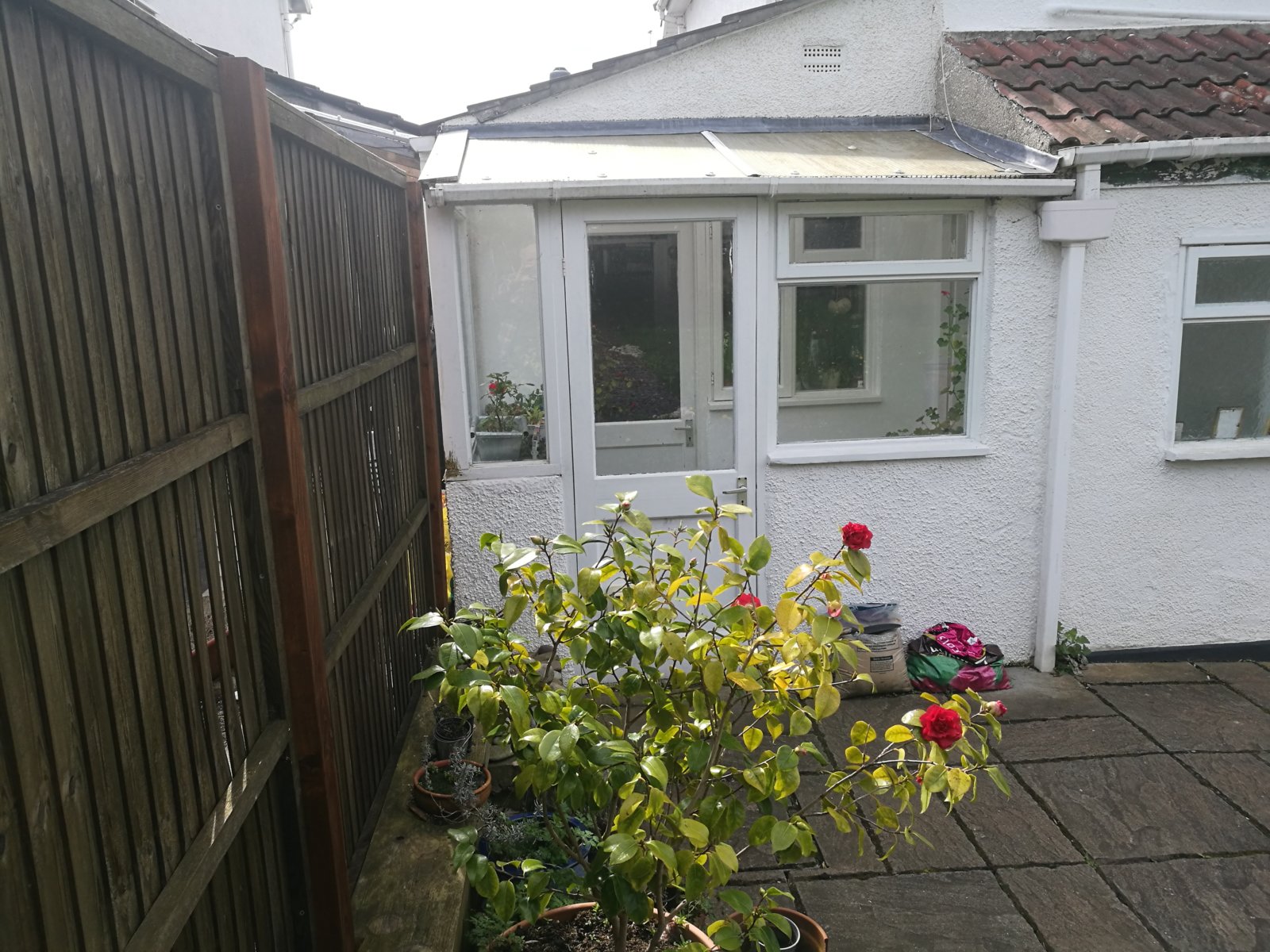

The obscure window she mentions is part of a lean-to and about 1,100mm from the proposed extension.

I'm wondering if that side was more like a conservatory with glass?
This is the other side which has the obscure window but is only a lean-to

Sorry are you referring to the adjoining house or the nieghbour with the obscure window?
This is the adjoining house with kitchen extension which she says would cause an alcove

I can't work out where the obscure window is or the issue with it.
