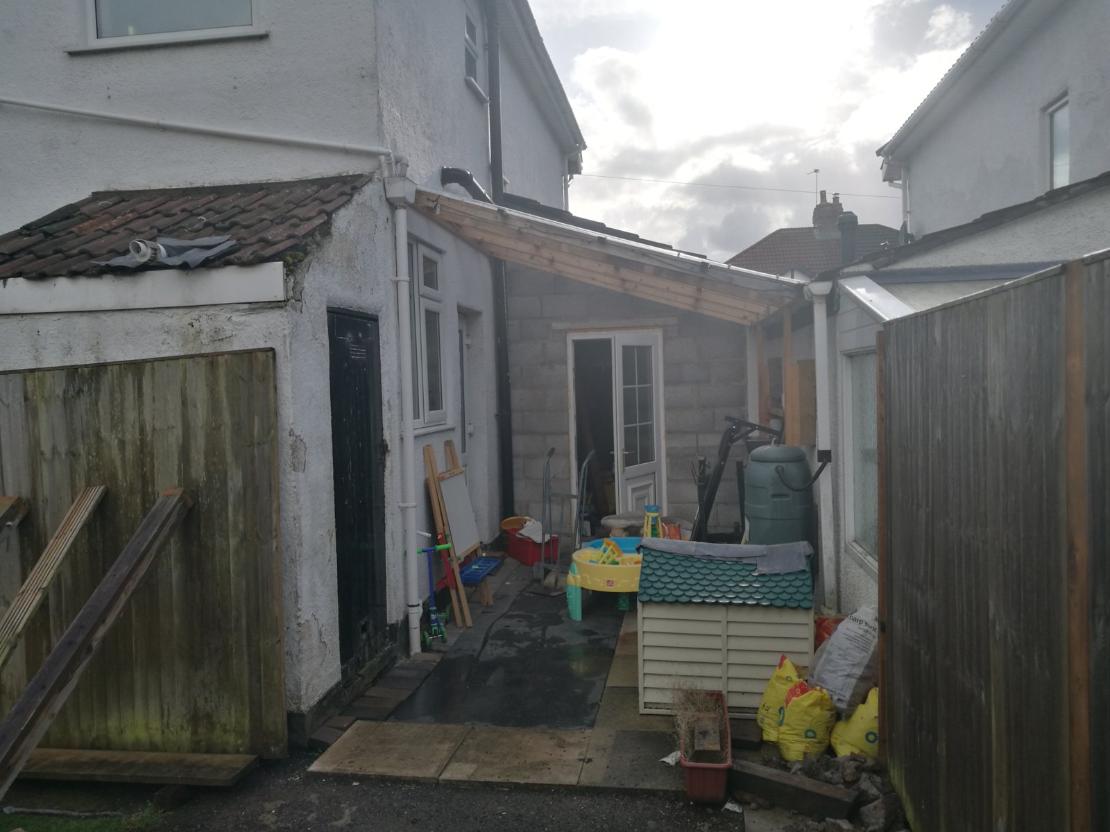

Thanks woody, the obscure window is the other nieghbour, you can just see it on the right of the photo.
Do I understand you correctly? I can build the left side, the dining room, under PD and then add to it? So I could build 3 metres deep from the border? If so how close to the border before I could step it out to 3.5 metres or should I take it from the 45' angle as you mentioned?
Also as you can see there is a shed, could that be included in the PD? Do I require PP if I build it as I mentioned above?
That neighbour should not have windows on the boundary. That's a fire risk straightaway.
A planner may be a bit unrealistic in refusing permission, if so what you can do perfectly lawfully, is construct a single or cavity wall on your side of the boundary 1.8m high without any planning permission. That would block those windows. Then add the rest of the extension to it.
The planner will know this, but it may not be enough to persuade then to be practical. Which would mean that you would withdraw the application and then do your enabling work (build the wall). Then reapply.
Generally what you will need to do is determine what are the contentious parts, and then see if you can build those under permitted development or even without it, and only apply for permission for the non contentious parts.
If building under PD the 45° rule won't apply.
The above is an option to get something that would not otherwise be allowed if applying for planning permission. But it may require some of it to be built first. This should not be the case, but some planners seen to think it is, and you need to be assertive with them to help them understand.
On that side I'm going to reposition the door into the garage similar to the photo to give me access from the front to the back without having to traipse through the house, there will be at least a metre between the kitchen wall and the obscure window.

The idea off PD is that you can do certain work without bothering the council. There is a Technical Guide which details the criteria.
However there is also an option to apply to the council for them to confirm what you think is PD actually is - Certificate of Lawful Development.
What I normally do is clearly mark on the drawings what is existing, what is gong to be built as PD and what is being applied for. But you really need to be sure that you ate correct and ready to defend your assertions. Otherwise it's a risk.

Thanks Woody, your comments have been really useful, i looked at the PD online and can see what you mean, before your last comment I thought I would stick the planning application in for the kitchen and then just add the other bit.
So if I do as you suggest I will keep the kitchen at 3,500mm and the dining room at 3,000mm, could you tell me how far back from the border i can increase up to 3,500mm please, I read somewhere 900mm but would the 45' angle come into force?
You can build up to the boundary. But you need to allow for any roof overhang, so step the wall in according to the soffit and gutter width unless there is no overhang (internal gutter or parapet). Allow 150mm for a half-round gutter and plastic fascia on a timber backing board
You need to accurately measure where the neighbour's patio door is and mark out the 45° line on your plan. But if you are doing this part under PD, then you don't have to worry about the 45° line.
You need to be clear though about what can and can't be done under PD, and what you may need to apply for planning permission for. Speak with the planner first. If she is definitely not going to approve your application and you can't agree a compromise, then unless you don't agree and are minded to appeal a refusal, then its best to withdraw the application and submit a revised plan - it will be at no cost.
