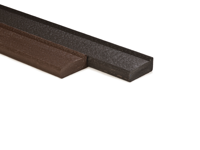

I've read people using skids, and as long as they are PT, the chemicals should prevent the wood from rotting as quickly. What product do you recommend for shimming or spacing the wood from the concrete slab? I am not finding much online as most just lay it down.
i used part slabs and slates or bricks for my shed the exact size you are building

If you're making a concrete slab, I think the best option would be a dwarf brick wall that the shed can stand on, with a DPC.
This will prevent any wood being in contact with the damp base, and give you a void that can be ventilated to reduce damp.

If so I suppose you could wrap the undersides of the timber in DPC

rather than wrapping, you can put DPC over the supports/under the bearers, so any damp from underneath cannot rise up, and any water from above can run off.
