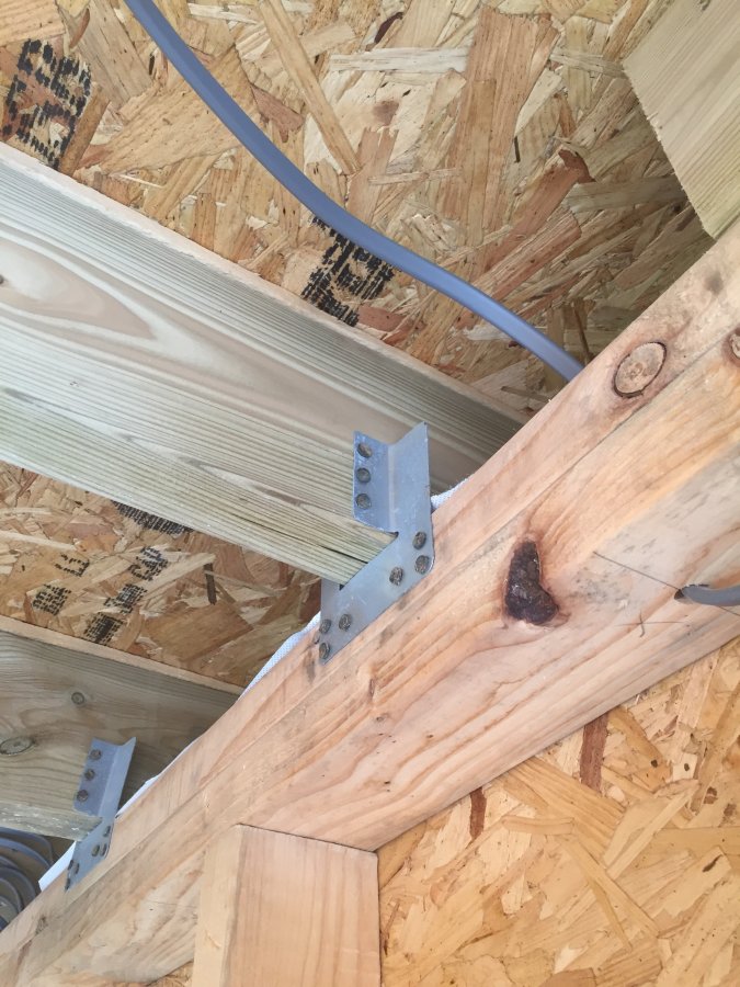

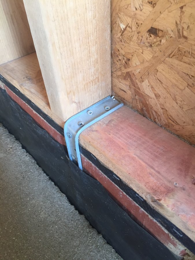

Hey guys,
Soon I'm going to be plaster boarding my Timberfre garage.
I'm not too sure how to go about the boarding over the various metal brackets/tie down straps.
The only thing I could come up with is to use the thermal plasterboard, where it will form around the metalwork rather than make plasterboard not sit flat.
Any other ideas apart from this?

Cut out notches in the board where underlying objects interfere, then fill with bonding and tape over before skimming.
I'd just cut the paper, and scrap the back of the board to form a recess. You don't need to do anything for those joist clips, it wont affect the board
