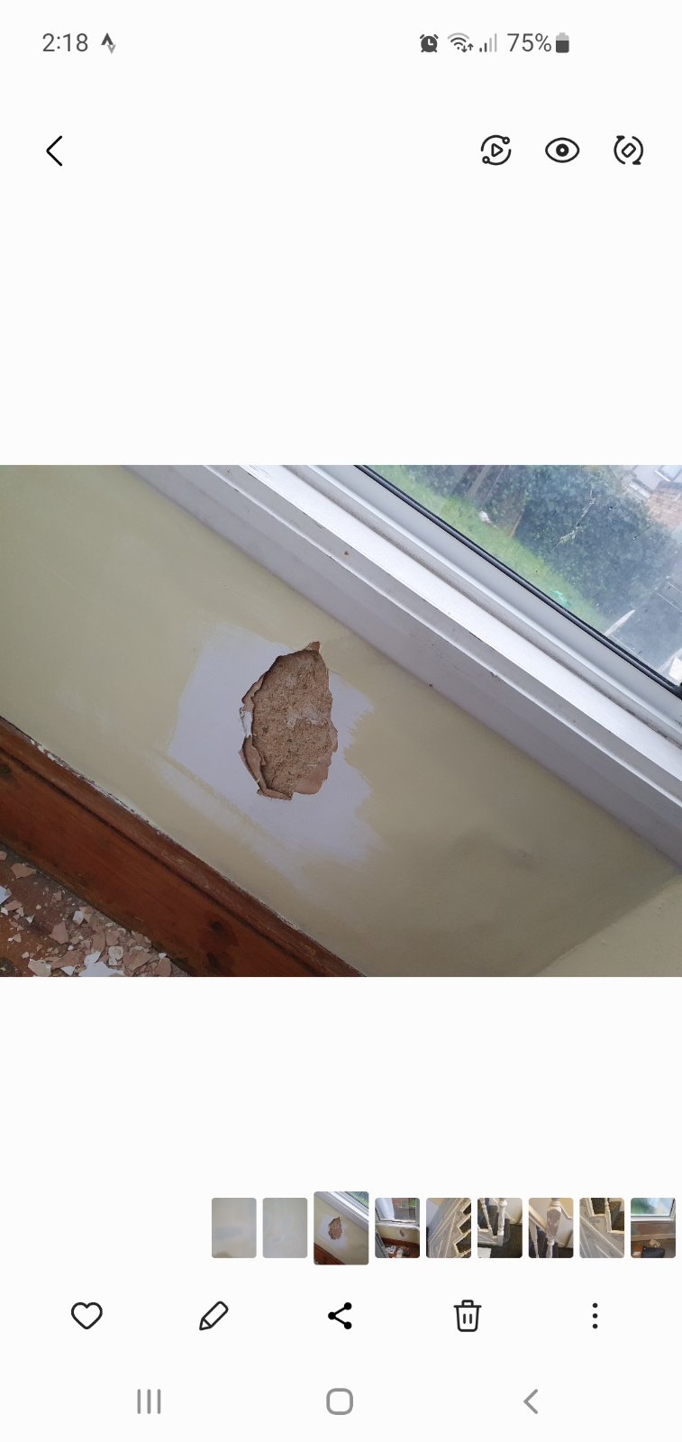

Hello folks,
Alot of plaster fell out... is this hole too big to fix with polyfiller or should I use something else like ready made plaster? I have no idea sadly so any help would be appreciated

Patching plaster , remove loose debris first , don’t try to fill in one go, I like to wet background and edges with thinned pva .
