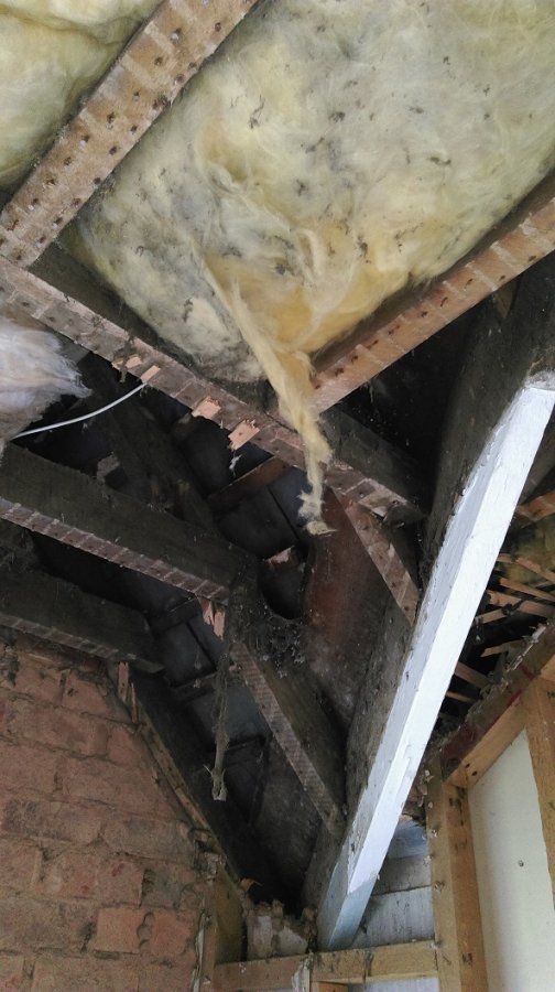

i have also been thinking should i put up some new insulation in the hard to reach places in the loft while its exposed. we have angled ceilings in our home they are common in UK houses. previous loft insulators obviously couldn't get into some of the areas!

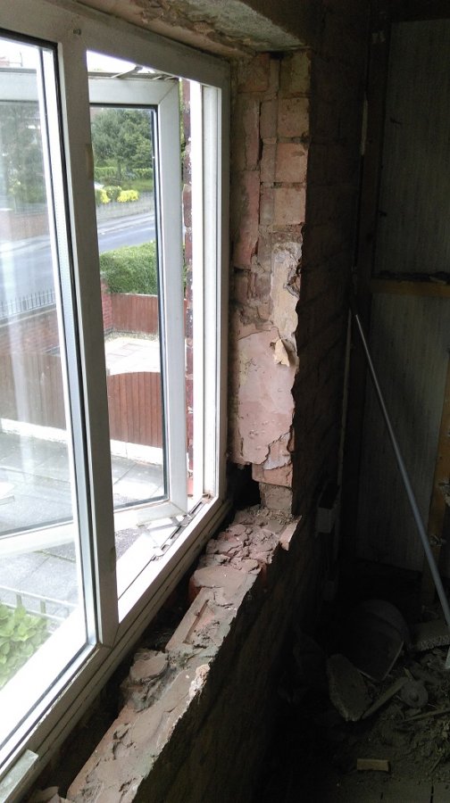

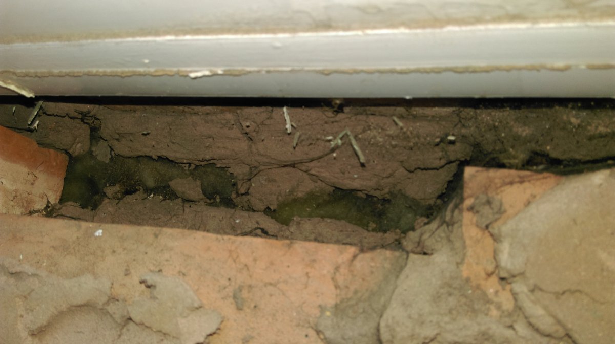

Heres the pictures. you can see where there is no insulation. if i should put any there, do you think i should use the rolled up stuff or insulation board? as i understand you dont want any insulation touching the tiles or stopping air getting through?
also you see the window cavity. bricks are blocking in the sides and down where the window sill would be there's just mortar in there bridging both courses together like it's just fell in there and gone off. should i clean it out?

Anyone point me in the right direction with my insulation querys? Looking to move onto boarding but not sure what to do. I'm still thinking silver backed foam board in the tight gaps in roof. Not sure what to put in the window cavity.

Make sure you put a VCL under the glass fibre, on top of the plasterboard.
FWIW The angled part of your ceiling is called a "sceiling".

oh pants. theprinceofdarkness,
i have just seen your post regards the VCL. i have already got the board up onto the joists in the ceiling. wich means i have not done this!! what options do i have now? have i got to pull it all down? its not plastered so i could take each board down if theres a way i could foil it and put it back up?
25 Feb 2005
1,416
204
If you used foil backed plasterboard you should be OK. Else its just a risk that condensation will gradually occur in the void and drip down. This will saturate your glass fibre so it is not insulating any more so the effect will then appear as mould on the inside. The drips would also rot any wood work. Depending on your roofing, if it is old fashioned and drafty it will dry it out. if it has a felt sarking cloth, then its very dangerous as these sweat profusely as they are not permeable to air.
If you have not plastered I would take it all down and install some VCL, its cheap but a s*d to use because it is so flimsy, seal the joints with tape.

hi again prince, thanks for posting to both my threads. i have taken it down bit by bit and done it with celotex stuff between the board and lagging as i didn't have the foil backed type. but in the sloped parts i wouldnt of been able to get both lagging and insulation board so i opted to just put the celotex in. i was worried the loft lagging would press against the tiles in those areas. There was nothing in those parts originally anyway
it is indeed the old type of cold loft (slate and no felt)
So thanks for stopping me there.
