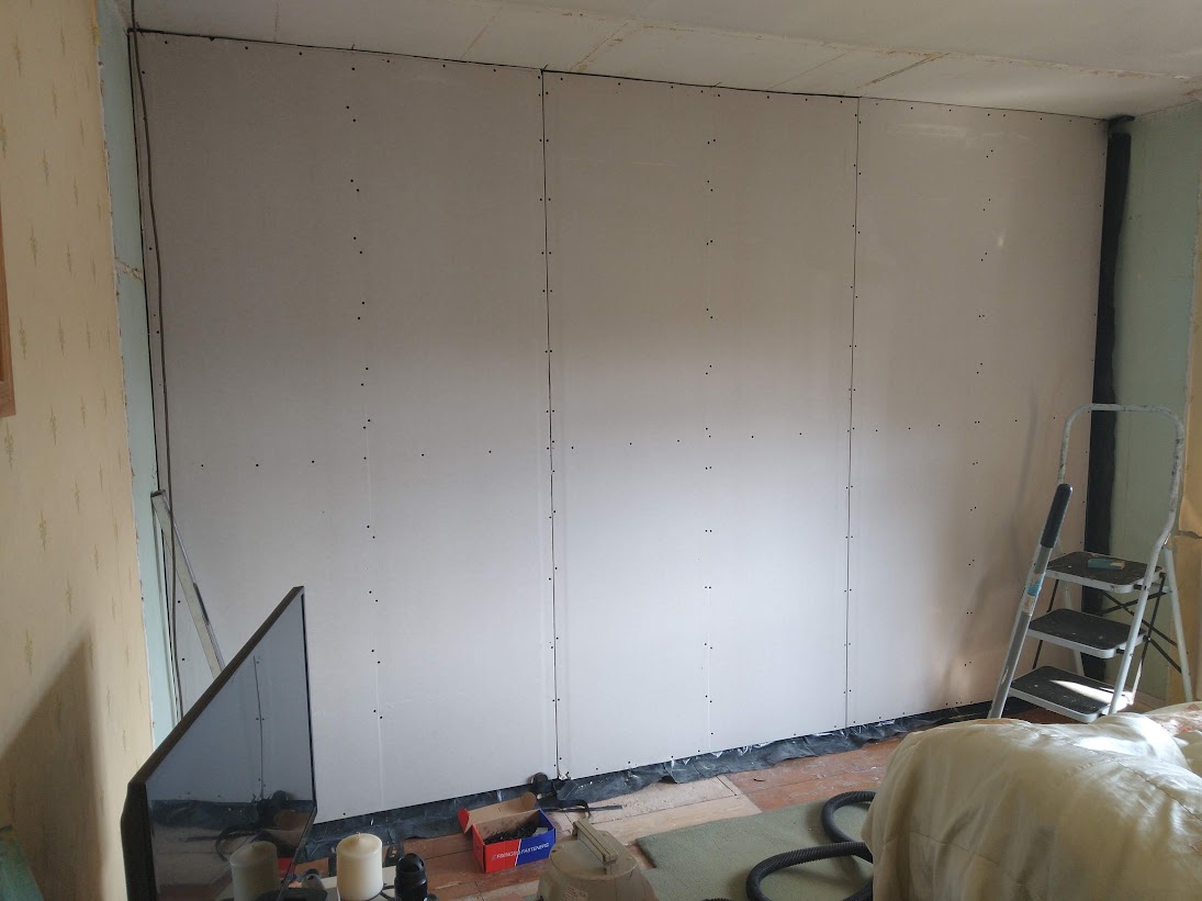

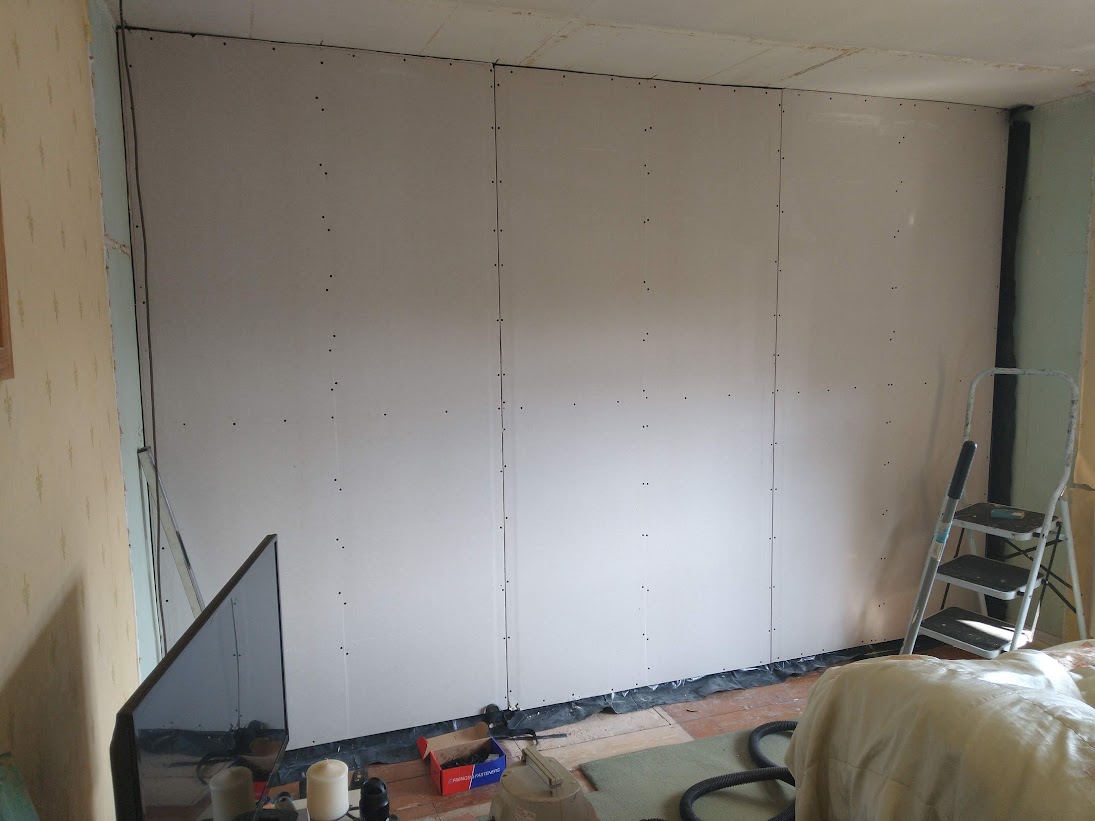

Did the exact same thing with some polystyrene backed plasterboard a few weeks ago in Wickes car park on 3 boards to get them in my Nissan. Laid them on the ground, scored through the polystyrene and into the plasterboard and then folded them in two. Had the wife there to help me to do the folding and easing into the car. Couldn't see the folds when erected.
