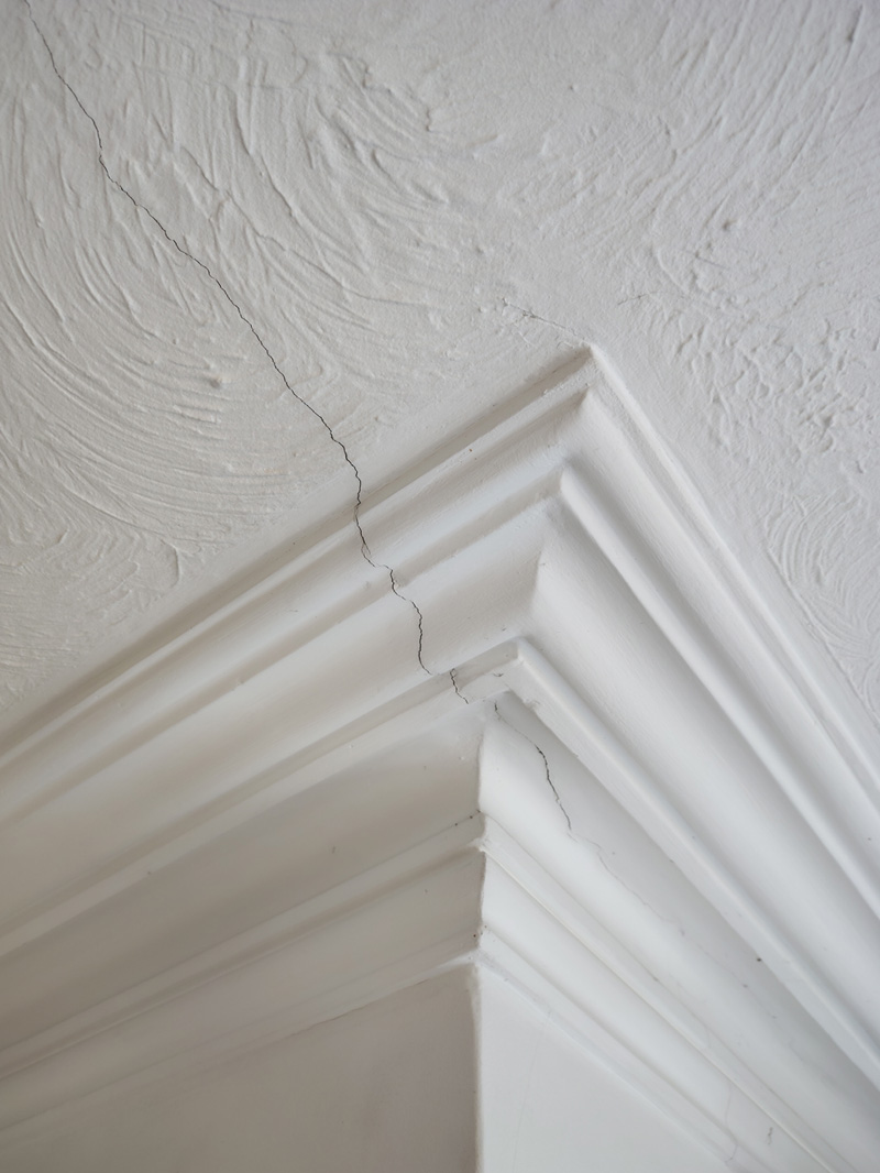

I have a ceiling that I want to plaster over the Artex.
It has nice coving that I wish to keep, and in other rooms I was able to cut around and remove the lathe and plaster before re-boarding and skimming.
However the coving in this room has multiple cracks, which I intend to fill/glue with Soudal Fix All, but I'm not sure if it will withstand the ceiling being pulled down.
The ceiling itself is crisscrossed with many hairline cracks, and there is slight flexing at these places.
I was thinking of doing the same glueing with these cracks, but would that suffice?
Would it be better to sand back around the cracks and maybe tape over?
Finally is PVA sufficient for bonding, or is there something better?
Or is the ceiling simply doomed to crack again!
See below for pictures.
The Artex has been tested and came back negative for asbestos.
Any advice appreciated.
Could you not overboard it and butt 9mm board upto the top nib on the coving?
I'd prefer not to change the appearance of the coving if possible.
But if skimming over isn't a good idea I might have to rethink.
Fair enough just an idea I had, not sure about the plastering (y)
Cheers.
The finishing is not a problem as I'm quite good at that.
Just trying to work out if what I'm trying to do is literally just plastering over the cracks!
Another similar option is board it as said, but leave a shadow gap of say 15mm-25mm between board edge and coving, and bead it. So you end up with a really sharp plastered edge, a rock solid ceiling, and due to the gap the coving looks better/more original than it would if you boarded and skimmed right up to it, as you don’t lose the top lip on it
Edit: altho you’ve probably done it by now
Our house was an artex palace when we moved in, in 1990 - ceilings and walls plus it looked like a coving/niche/corbul/ceiling rose/dado rail shop. It was the 90’s though and it was the fashion at the time. I’m waiting for my plasterer mate to come round and skim over our one remaining artexed ceiling. All the others have been done over the years. What he does when he plasters over mine is to PVA the whole ceiling and scrim over the cracks before plastering. Never had any of the cracks come back. You could probably knife out the coving and fill before painting.
