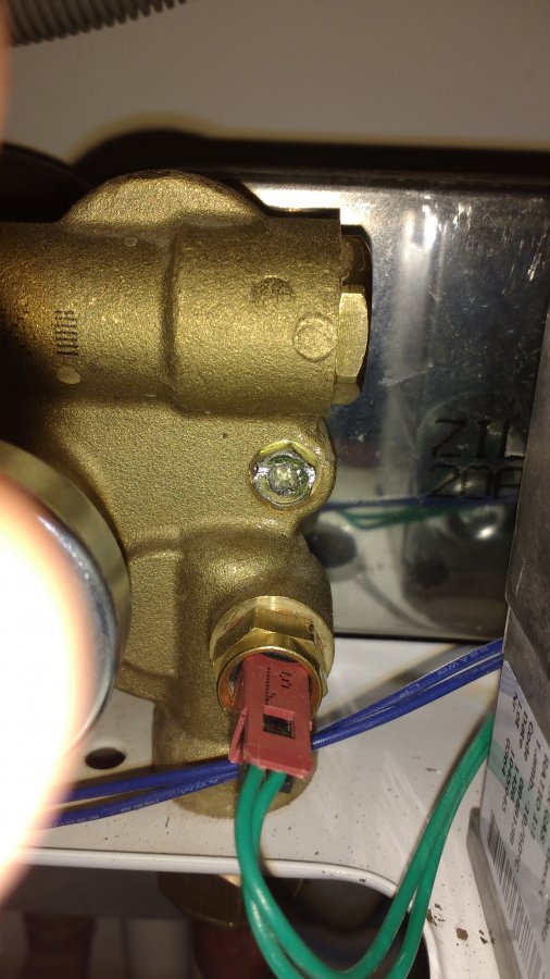

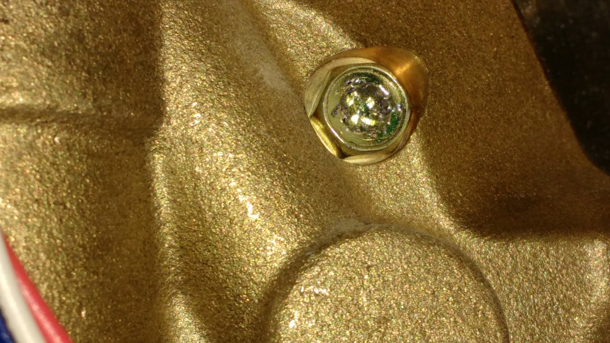

Hi there ,
I recently run into trouble while trying to remove a plate head exchanger from a Baxi duo tec 33 he. I had removed this successfully in the past to clean around 2 years ago as it was blocked with dirty inside I did a nice cleaning put it back in place and hot water start to work consistently again. Yesterday I tried to have this removed again as one of the showers was not getting enought hot water, but the head of the 2 screws from the heat exchanging plate that holds it in place got completely worn out when I use a hand screw driver. I was surprise how these screws got worn out so easily! Now I got no grip at all to use any screw driver as the screw head is completely gone. These screw are also flash inside the boiler so there is not room at all for me to remove this using any pliers or any other type of tool that I can think of. I am wondering if anyone would have any suggestion in how to remove these screws? And if I manage to do so I will definetly need new replacement screws as these are completely useless now. Photo attached.

Screw extractor is a possible option. Obtain replacements before removing the existing ones.
Screws get destroyed like that when people use the wrong type or size of screwdriver. Using a Pozi driver on a Philips head will destroy it very quickly.
petit_pablo. That was exactly what I thought to do but I am still in doubt between do that or use a screw extractor. If I do what you sugest there are 2 considerations:
1- I assume that the screw thread is only at the half end of the screw at the plate heat exchanging. If that is the case is fine but if the thread is all along the screw I will not be able to have it removed. I believe the thread is just at the end of the screw but I am not sure.
2- I have removed the heath exchange plate in this boiler before. The heath exchange has to come out at back and then at the right side of the boiler a very narrow space. If the screws would still in the plate I am not sure if the heath exchange plate will pass trough the boiler in order for me to get it out.
I will definetly try to outsorce a bettar quality replacement screw perhaps allen screws. These were PH2 screw. I was using the right screw driver but perhaps it was my mystake 2 years ago if I have overtightened the screws.

Drill the heads then remove the plate. You can then remove the threaded part of the screw.

fook me did you try using drill . your next step is to use screw extractor i expect or as pablo has said
I am very inclined to try this option first
does anyone know how can I figured it out the meassureaments from these screws before I have it removed?
Is this a job you are competently qualified to carry out?
yes i am
In that case why are you in this position now? Had you used the correct tool the first time you took the plate out, then you would not have had a problem this time around. Don't blame the manufacturer and the quality of the screw.
Get a screw extractor on what remains of the head and have some new screws on standby.
