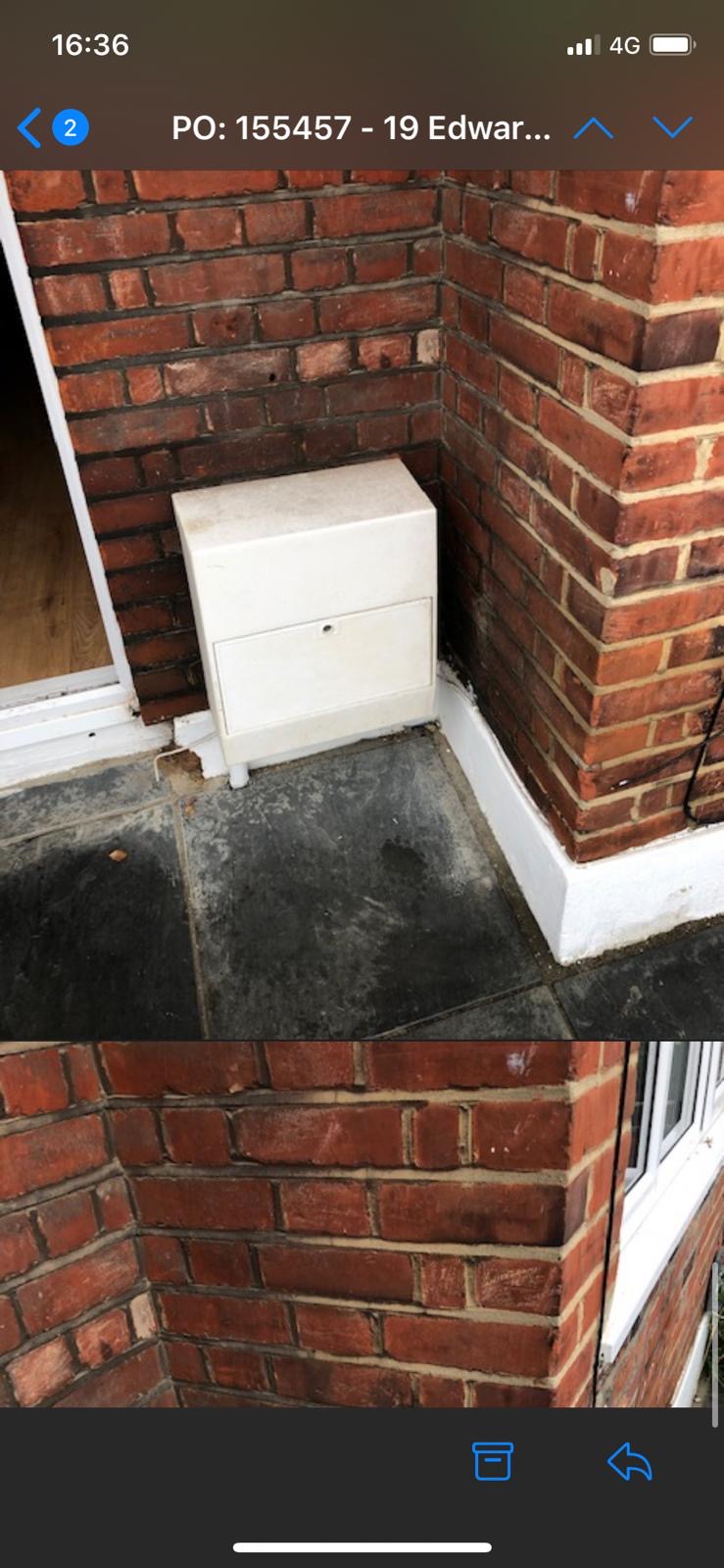

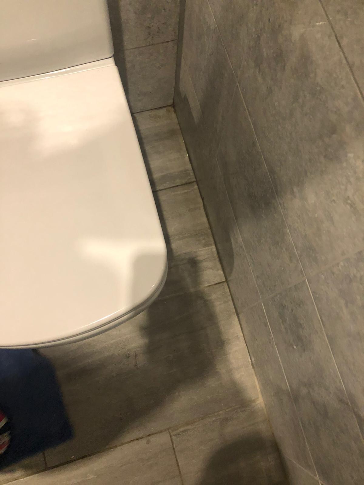

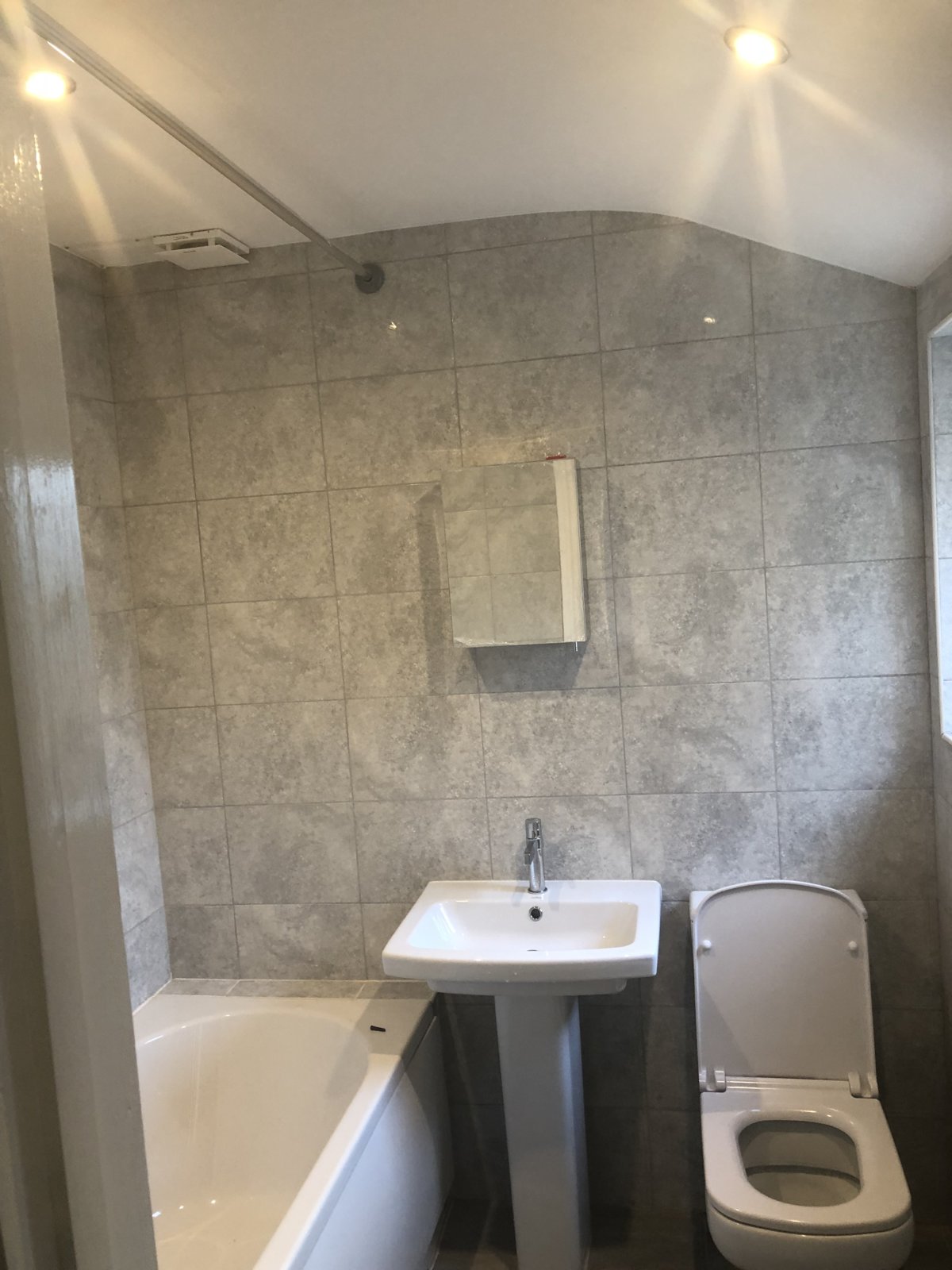

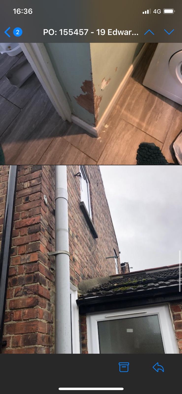

Hi All,
please advice damp appearing around the house, water coming into the bathroom damp appearing in the front room, bathroom. we did fit an extractor fan but will be getting a stronger one. Water appearing on the floor in the bathroom don't know where from has anyone experienced this. Any tips will be appreciated. I have attached some pictures to thread post.
The house was recently renovated new bathroom, tiles, paint, electrical, etc
I thought it might be when it rains as it rained a lot at some point last year but water appearing on the bathroom floor even when it does not rain.

Bathroom floor water appearing after toilet flush? Is there any sign of leak in whatever room is below toilet?
Hi The water is not after toilet flush, there is no room below the toilet. The terrace house is in Belvedere, toilet is downstairs after the kitchen.

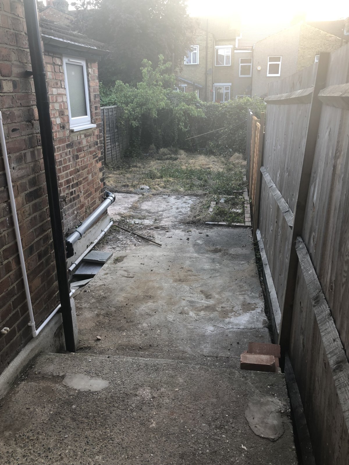

Any chance of some better pics of the single storey extension roof tomorrow?
Tiles don't appear to be sitting correctly and the ridge looks odd (might be the pic though )

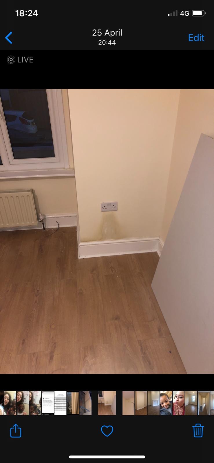

This are some old pictures i have will try and take more recent ones.

Ah from those pics you have lots of potential issues
The underground drain could be leaking or the waste pipes going into it
The outside tap could be causing penetrating damp
Waste pipes not discharging into the waste correctly
Thanks for the heads up, Need to get a plumber to have a look again because i had the British gas home care insurance and the guy that came said he could not locate the source of the leak and the bathroom walls are tiled all the pipes are inside. thanks for the observations.
The plumber came to inspect to try to find where the water is coning from. Said it is possibly condensation. The British Gas person that came in October also said the same. I have informed tenant to leave the doors and windows open sometimes. Also the extractor fan should be left on think she is trying to save electricity/gas.
