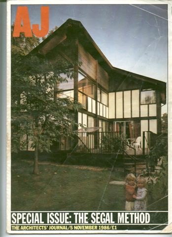

Excuse my ego trip but this is the Walter Segal designed house that my wife and I self built in 1980 / 81
Totally by chance, I know the son of Walter Segal.
He is quite keen on his father's work and often gives a short presentation about it.
But he designed houses during the 1900s !
Tony

[QUOTE="bernardgreen, post: 3623546, member: 411576]
His concept about houses and homes is still valid.
[/QUOTE]
I mentioned your comment to my friend and he actually remembers "The Greens".
He even thinks he still has the plans.
Tony
