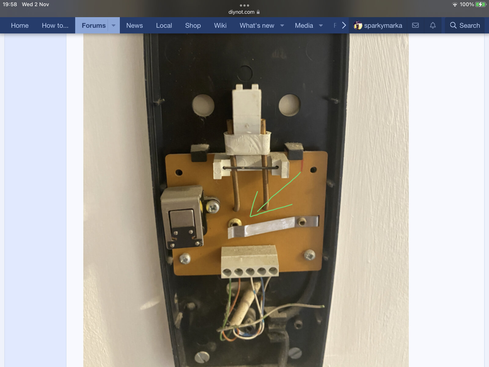

Hi
I hope someone can please help me.

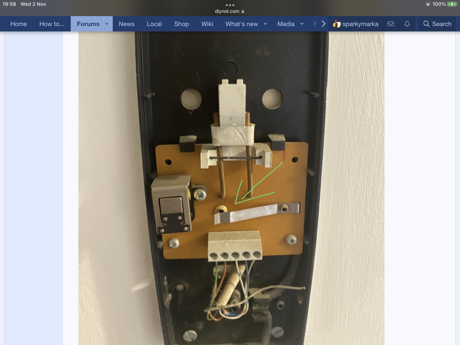

The button on my entryphone has stopped working and won’t release the front door of the building anymore. I have checked with neighbours (there are 6 apartments in the building) and everyone else’s are working ok so it has to be a fault with the handset.

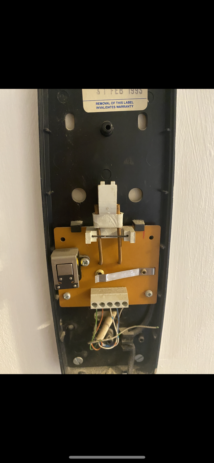

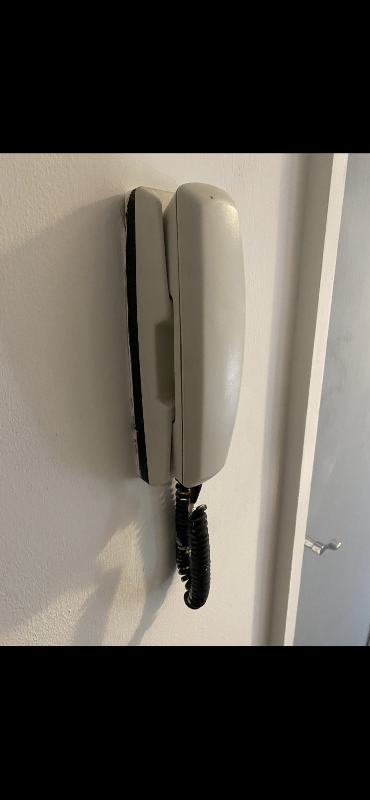

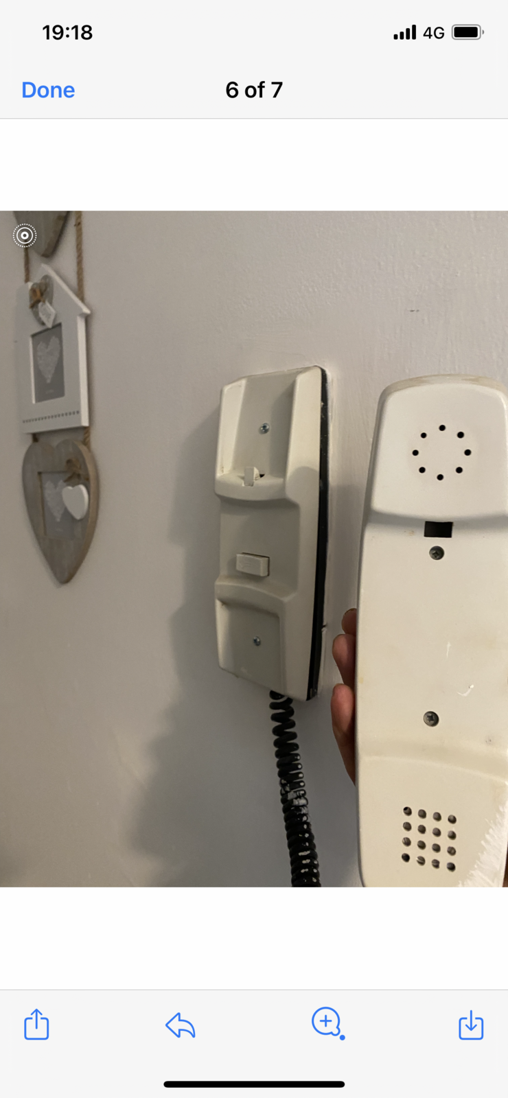

Does anyone have any idea which entryphone this antique might be? I can’t see make or model anywhere and it is from the 90’s! (Pics attached)
Any help is greatly appreciated!
Jen
It’s a bell systems handset the replacement is a bell 801 , does it work if you press the metal leaf down onto the rivet on picture 2 ? As that is the release switch ….

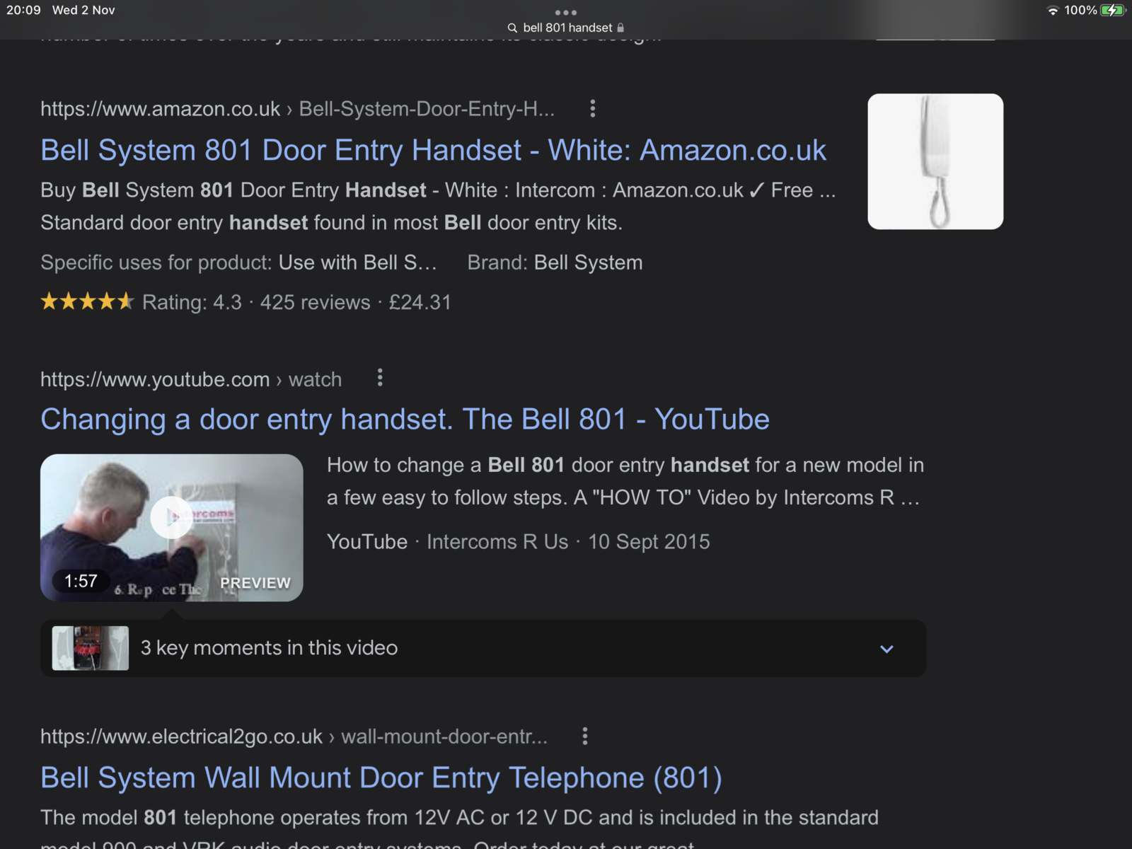

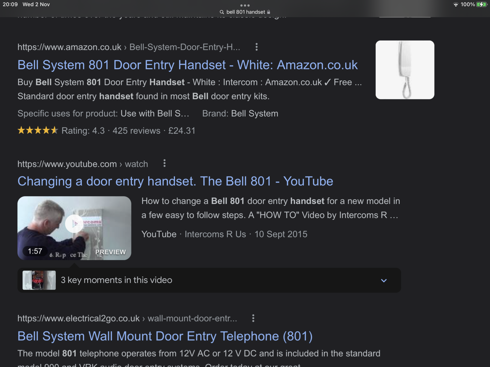

There is even a video on youtube……
Oh wow! Thank you sooo so much for your help, you’ve no idea what a headache this has been lol!
