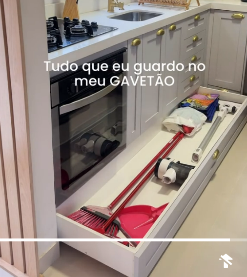

This is one of those "the Mrs saw it on the internet, so can I make it happen?" posts.
I am not sure what country this is but they seem to have made a full-width plinth drawer:
Do we think the cabinets are hung off the wall? The worktop looks a bit shallow.
UK kitchens have legs under all the units so hard to see it a full width drawer working here, only way that could work would be for all of the cabinets to be made to hang off the wall. Alternatively you could fit a structural member under the front edge of the units spanning the gap but it would have to be pretty hefty and would eat into the height of the drawer. Or you can get individual under plinth drawer kits in the UK. But seems like a ton of work for not much gain.
Looks like a holiday home galley kitchen, no visible struts to side so draw may be on wheels.
You could make individual draws but can’t see them being useful.
I use behind the kick panel as overflow booze storage as it's usually pretty cold under there. I'd rather have the space usable than not, but it's more effort than I can be bothered with.
You could conceivably have multiple drawers between the cabinet supports, with the kick panel fixed across the front of all of them.
It will be IKEA stuff, hung off a rail at the back, not ideal for a worksurface with the heavy worktop, but doable. The base units are usually 80cm top to bottom, so a smaller leg than uk usual cabinets.

i have done a few plinth drawer
problems are 5-6" max minus drawer base
12mm ply or other thickness requited to lift drawer bottom off the kitchen floor and to slide on
nothing heavy in the drawer because you need to support the drawer as it comes forward to not scratch the floor
you overfill the drawer it can get "locked in" and you cannot gain access to free it easily
whilst the space may look tempting is the extra perhaps 5-8% storage space worth your knees your floor and your back
loose plinth and plastic storage boxes keep all the crud off what is underneath and allows non scratch occasional access
