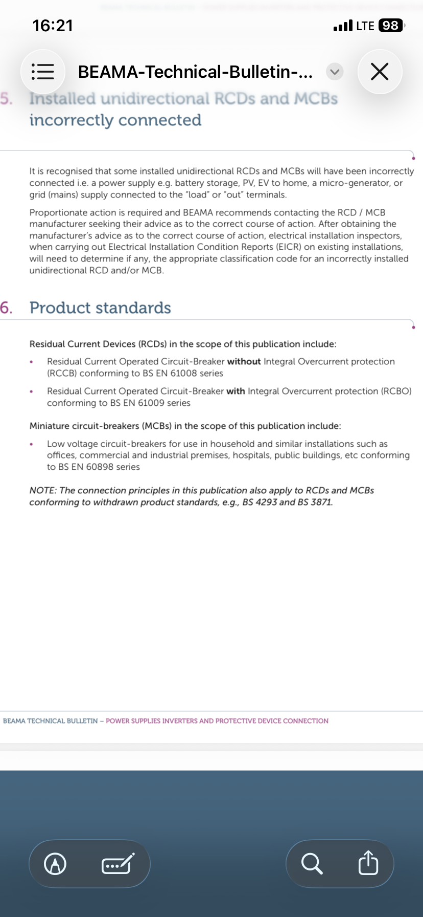

https://electrical.theiet.org/wirin...-march-2024/bidirectional-protective-devices/

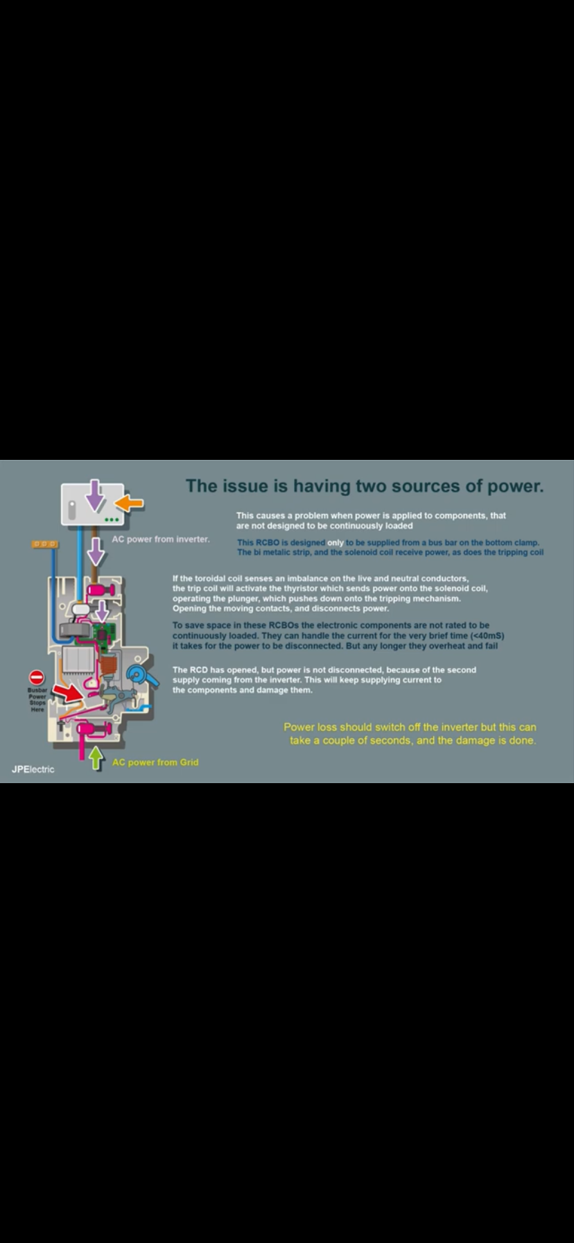

“The concern highlighted by BEAMA is that a voltage present on the outgoing terminals of the protective device, either due to the device operating in the event of an earth fault or by use of the functional test button, could cause irreparable damage.”
That’s where i read about 2 issues with unidirectional rcds ,whether true or not

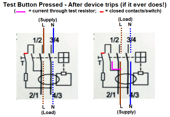

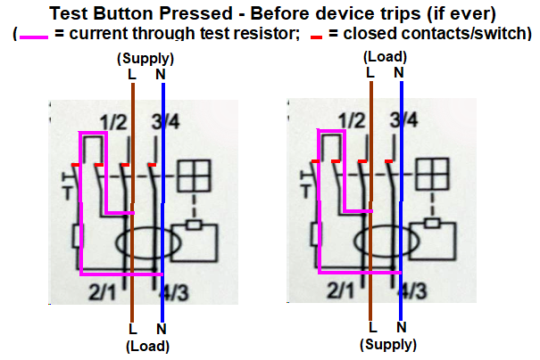

I'm not at all sure how an RCD could suffer as the result of it operating because of an earth fault. For a start, that would merely mean that (if it were a unidirectional RCD) the electronics would remain powered after the trip (which is the situation which the devices normally happily live with for years or decades)and, in any event, the device tripping (hence disconnecting inverter from grid) would presumably very rapidly result in the inverter shutting down, wouldn't it. ... but, as always, maybe I am'missing something'!
The second issue, relating to use of the test button with a unidirectional RCD during export, is the one we have been discussing at length in this and other recent threads - and would seem to be an unavoidable potential risk, albeit far from quantified.
I didn’t understand it myself ... What that second issue if any could be
That makes two of us, then ... but it would be a little worrying (and would make us rather sceptical about anything which came from BEAMA) if the 'experts' at BEAMA were imagining an issue which doesn't actually exist - so, in some senses, I might hope that you and I are both 'missing something'!
Thank you, @mikehammer69 the report states
The product standard for RCBOs states that if it is necessary to distinguish between the supply and load terminals, they shall be clearly marked, for example.
So with RCBOs, we can, it seems, identify between the two types.
The 'typical' residual current circuit-breaker (RCCB) is an electromechanical device, however, electronic RCCBs also exist. RCCBs for consumer units are in the form of a two module-sized device. These devices are not usually marked in and out, and therefore are bidirectional.
So it seems this also covers the RCD, so all we need is like when we get a meter change, and they mark the fuse size on the DNO fuse, we can have the RCD/RCBO type marked on the CU. So from date of this instruction, it will take 5 years for all rental accommodation in England to be marked up.

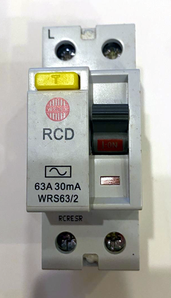

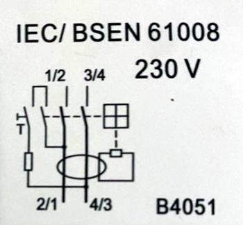

".... RCCBs for consumer units are in the form of a two module-sized device. These devices are not usually marked in and out, and therefore are bidirectional."
I also have serious doubts about that statement. The vast majority of RCCBs in-service in CUs are, indeed, 2-module-sized devices which rarely, if ever,have 'in'and 'out' markings - but it has always been my understanding (reinforced by the diagram usually on them) that they were unidirectional devices. Is that not the case?
