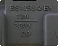

The IET Wiring Regulations (722.55. 101.0. 201.1i) specify that 13A UK sockets which are installed to charge an EV must comply with BS 1363-2 and be marked 'EV' on the back of the plate.

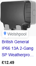

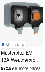

I think marking were the user can't see the mark, is daft, I look at the cost of a BS 1363 EV socket
and just wonder at the price. Compared with a normal outdoor socket
and wonder at the price OK RCD protected so add cost of RCBO

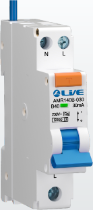

does not show in and out, I found the data sheet by entering the AMR1 into google, so it would be so easy to make an error.Isn`t this the same issue?This video talks about a second issue with newer rcds
There appears to be 2 issues with unidirectional rcds is what im saying not just a test button problemIsn`t this the same issue?

Quite so. Although some of the documents being waved at us suggest (indeed, state) that the presence of in/out markings mean that a device is not bidirectional, that is clearly not the case - and, as I've observed before, in the case of an RCBO, a neutral'flying lead' also effectively constitutes such a 'marking', even if the device is actually 'bidirectional'.This advert shows the problem it clearly says "Live 6A 30mA Double Pole Bidirectional RCBO Mini B Curve AMR106B-030" but picture shows <image>clearly marked as out, so how does an electrician opening a board with one of these, know if bidirectional or not?
