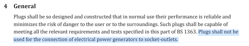

Has plug and play solar now been passed, I see adverts?
this has got bizarre, all thats missing is bsi changing sockets to be bi-directional...
Bi-directional sockets already made, and two-way transfer already permitted, with a plug and play portable battery pack, more commonly called and EV.
So yes you make a good point, and I can't think of a reason why you can't plug in solar panels and battery into the same socket. I will wait and see the answers given?

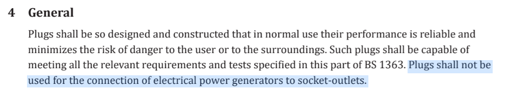

View attachment 414405 Bi-directional sockets already made, and two-way transfer already permitted, with a plug and play portable battery pack, more commonly called and EV.

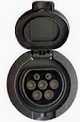

To use the terms of another: Non compliant junk as they are not shuttered
I had assumed the two small pins tell the EV charging point when to turn on power? Are you saying all EV charging points are non-compliant?
We have repeated had comments on here that CEEform sockets are not permitted in domestic situations as they are not shuttered, even those with interlocked switches or other mechanisms. I dont see EV connectors are any different. In fact having worked on several I'll go further and say they appear to be identical construction. I'll leave others to argue why one is non compliant but the other is.
