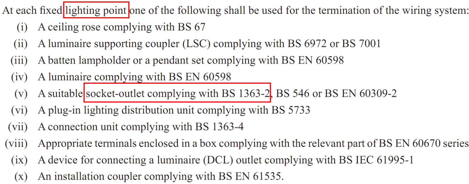

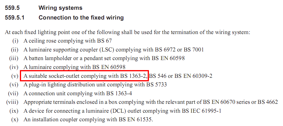

The regulations are a little vague on this
No they aren't:
Works well so was wondering before inviting electricians back to quote for more work, whether or not the same thing can be done
Yes - it'll be fine.
Take absolutely no notice of anybody who pops up to vent their obsession about it being a bad practice that ought to be, and one day will be, forbidden.
The other method is to use a socket supply fused down to rating of switch if under 13A and have a simple switched socket, there are remote controls available for sockets, I use a pair for my bedside lights, so I can switch off/on with in my case a remote control.
Is the same as (v) a suitable socket-outlet complying with etc.
What it does not say is a socket to BS 1363-2 can be fitted to a 6 amp lighting circuit. To be fair the tread does not say that is what they want to do, it does not say what type of plug is fitted to the lights.
