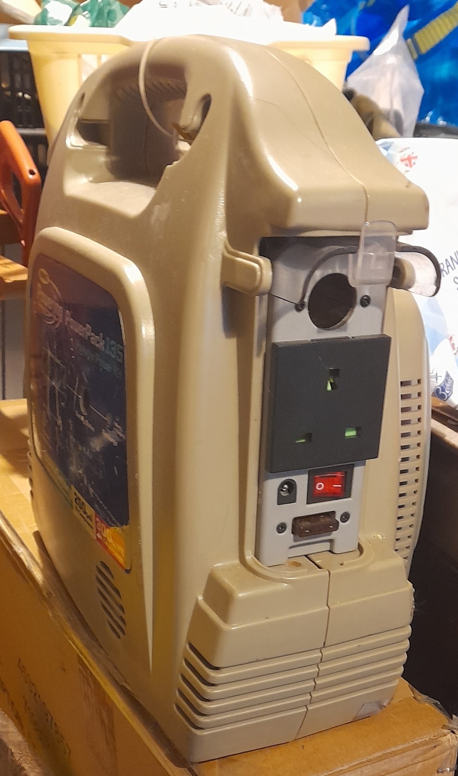

As to solar fed into a battery, and the battery supplying independent sockets, not connected to the grid, verse solar with no battery being connected to grid, it will depend on how you can use the battery.
So if I was to put the battery in a box just outside the kitchen, and run my fridge/freezer and freezers from the battery, with a timed connection to charge with off-peak I could likely use more of the solar than feeding it into the grid.
Except in my case I already have a second MPAN number, so would/I paid 12p/kWh for export anyway.
So the big question is, if you have a battery with say 4 socket outlets, how easy is it to run extension leads to equipment to use that power?
The problem with a battery is ensuring it is charged for essential equipment. But a supply turned on at dusk, and off say 2 hours latter, which most smart sockets can do, would ensure always fully charged 2 hours after dusk, so if it can last to dusk the next day, any solar will mean it charges less at next dusk, and there is no limit on solar, inverter, or battery size, and it does not need fitting by an electrician.
The advantage of a pro fitted system, is the battery and inverter supplies all. Where if DIY fitted, it only supplies where you have run extension leads to.
My kitchen has a void behind the units, so extension leads could be run out of sight, too much power for cooker, but depending on battery pack used, it could supply everything else, and could be fitted now, not need to wait until 27 August. And it can be configued as I want, not just what the kit allows, I had considered the idea as could use battery packs which could be used with other things, like a picnic. But in the main this old unit Back-up-power.jpg is not used that much, so likely neither would a new unit.
