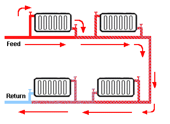

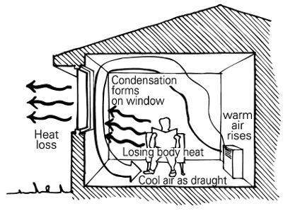

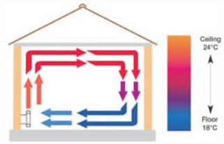

That is also now questionable. We were shownalthough the radiators could theoretically be positioned as far as possible from windows etc, in practice by far the most common location is actually 'under the window'!
as how the radiators worked, but this was before double glazing. Under the window is often good for furniture placement, often a problem with curtains wrong side of radiator, but it also means the thermostat is against a cold wall, which is OK once the thermals have established themselves, but until that point the thermostat is at a lower temperature to the room in general.
had the input to the radiator at the top and output at the bottom, this assists thermal flow, but places the TRV where it is directly heated by the radiator, to one side at the bottom is likely the best place to sample the whole rooms' temperature.It may be 'questionable' but 'under the window' remains by far the most common location for radiators. Indeed, given that the only sensible location for radiators is around the periphery of a room, even with double (or triple) glazing, I imagine that the window is likely to still be colder than any of the other walls, isn't it?That is also now questionable. We were shown <images> as how the radiators worked, but this was before double glazing. Under the window is often good for furniture placement, often a problem with curtains wrong side of radiator, ....
True, but that is likely to result in more rapid heating up' of the room, isn't it?but it also means the thermostat is against a cold wall, which is OK once the thermals have established themselves, but until that point the thermostat is at a lower temperature to the room in general.
The TRV does not have to be at the 'input' side of the radiator. One can have the input to the top of the radiator and the TRV at the bottom.The old system had the input to the radiator at the top and output at the bottom, this assists thermal flow, but places the TRV where it is directly heated by the radiator, to one side at the bottom is likely the best place to sample the whole rooms' temperature.

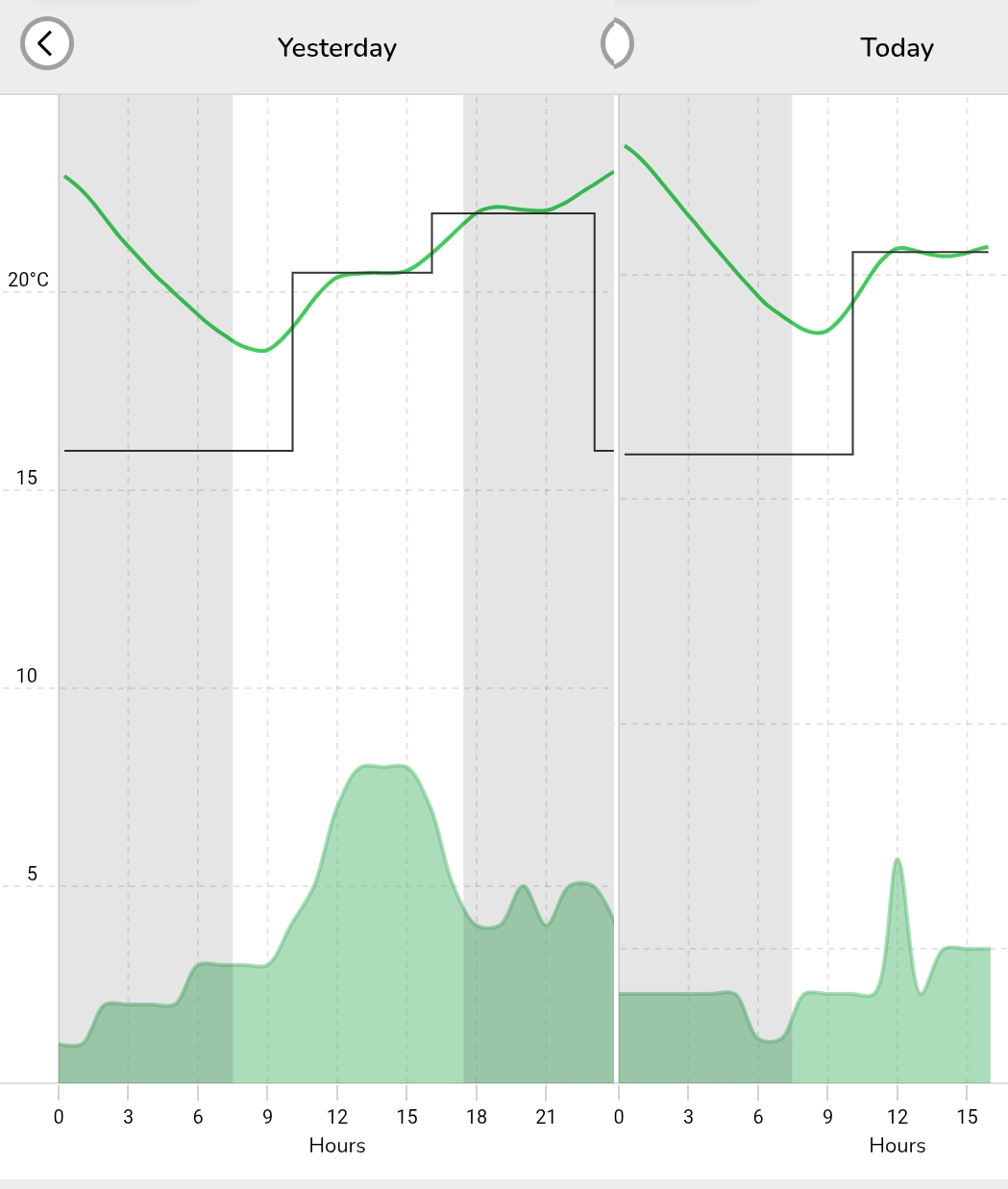

however, the point is, still at 17°C when it turned back on again at 9 am, so unlikely to have any problem due to hysteresis, but with my first house, having the heating off for 3 hours caused a massive temperature drop.Maybe, but I made the point because a lot of people seem to think (wrongly) that TRV has to be on input, or wven that both input and output have to be at the bottom (since that seems to have become the norm, domestically).The whole input, output, top, bottom is an unanswered question, I found harder to trim the lock shield valve when the TRV is on the output, tended to over shoot more. But have found what really happens, is not the same as what we think will happen.
