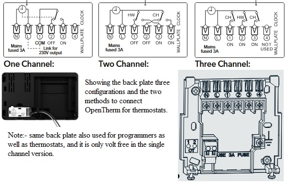

So the whole way the modulating boiler works requires gradual turning of zones on/off, or many zones, the EPH I know do a thermostat which can be set to master and many slaves, but most thermostats even when they have OpenTherm, say it should not be used with multi-zone versions of the thermostat, EPH seems to be the odd one out. Wiser do a three channel hub, and Hive have some way to link thermostats, I think the universal base
is asking for problems where the same base can take a volt free and non volt free hub/thermostat/programmer, and it is a pain to test, as once hub is fitted you can't access terminals.But today with a modulating boiler, one has little option, if you want it to modulate correctly and gain the latent heat but to control all with the TRV heads, which, if one feels the new laws require time settings for the zones, the only option is to use electronic heads.
