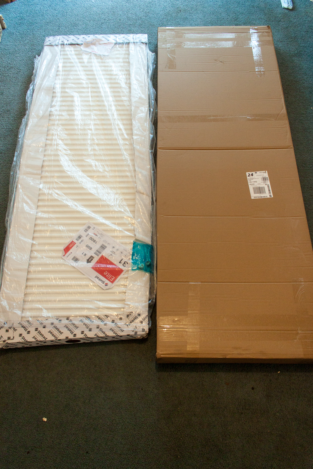

Update, so the new rad arrived from Toolstation/barlo (Quinn).
Well first things first, look at the packaging difference.....
On the Left, the stelrad with a loose plastic cover, and two thin strips of cardboard down the sides and two thin strips top and bottom. No other protection for transit.
On the left Right, a thick cardboard box containing the radiator form Barlo....what is inside you ask?
Well.....

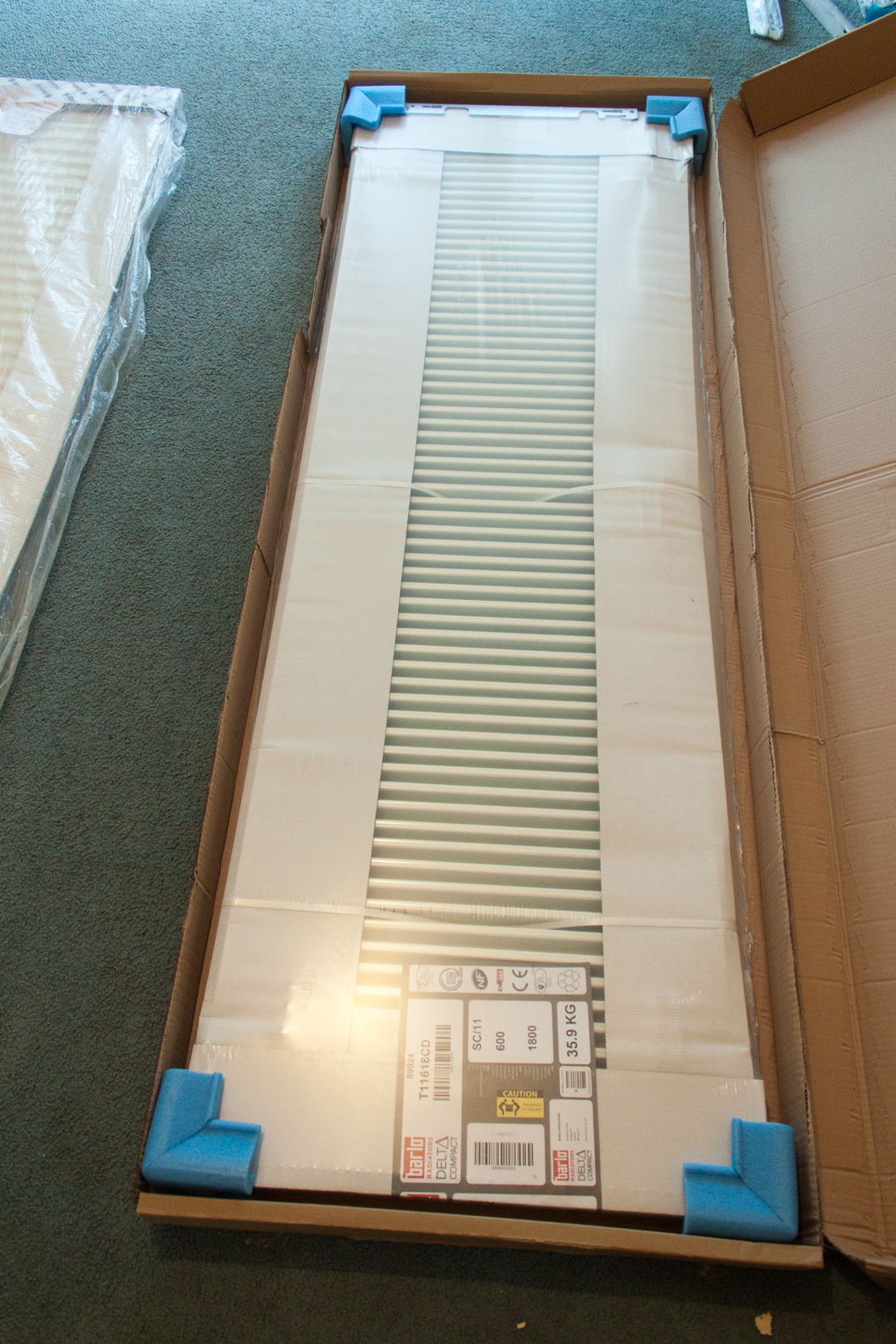

A radiator covered in carboard protection held in place by cable ties with a tight fitting shrink-wrapped cover fitted in a box with large foam corner protectors!
Looking good so far.....
Out of the box all looked great.........

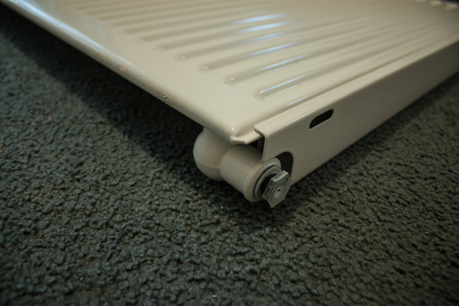

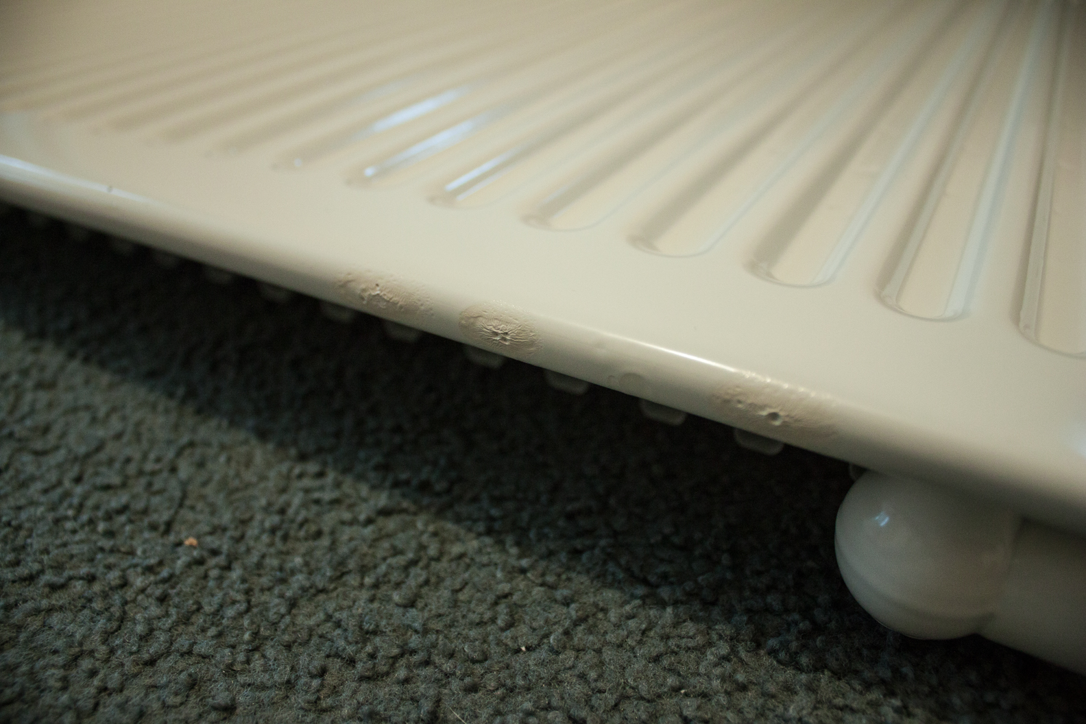

There is however a small area of concern, it is on the bottom, so not noticeable.....but there is, seemingly a paint defect....
Due to how it has all been packaged, I am a bit annoyed....again....
but....thoughts?
Can you see it?
Here is a close-up....
So, thoughts? Just a paint defect? Out of sight out of mind?
Or would this be cause for concern....

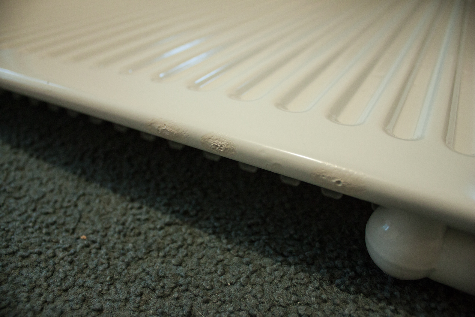

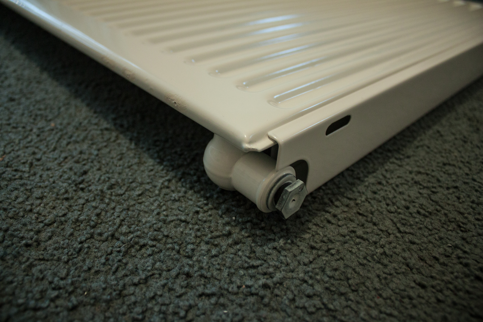

but....thoughts?
Can you see it?
Well it wouldnt look so good if it was used the other way up as a round top
As a potential customer I would not want those fitted.
If a tradesman fitted them in that condition he would likely not be working for me again. (not that I would need someone else to do something as simple as fit a radiator for me).

Hopefully this is a one off defect. The more I look at it, the less happy I am with it.
It does have a brownish tinge to it so I suppose I do not know what is going on beneath. Although it could just be a slight yellowing of the paint in those spots where it seems to have not taken properly.
