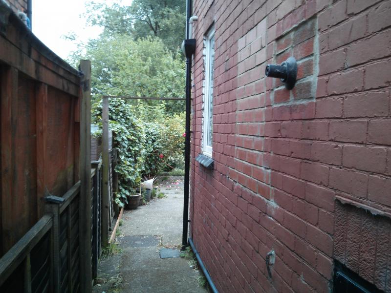

Hi all,
Had a look through the search results but I have to admit I'd given up after 2 pages!
Just want to know if anyone can confirm that Plume Management Kits can or cannot be fitted by a DIYer?
As is often the case, there are conflicting comments on this and other forums. The reason for requiring one is I intend on constructing a polycarbonate roof along the side of my house parallel to next door's similar set up. It's just to store wellies, bikes etc out of the rain really. Also, our flue currently doesn't appear to be 2.5m from next door - is this a legal requirement or just "hot air"?
Not too bothered either way though as next door's flue plumes right in to our back door so we can't leave it open!!
Cheers

Do you have a calibrated FGA?
You probably know that I don't have one Dan!
But I wouldn't have thought one was required to redirect the vapour a foot above where it is currently extracting from. No modifications whatsoever to the internal workings of the boiler or the like.
Surely the annual service covers the analysis of the flue gasses, which I assume are measured within the boiler's own gas analysis test point, as opposed to being accessed externally?

This is very easy for me to digest - I would have ensured that any modifications would have been in line with the guidance in the manual (along with relevant information provided with said PMK).
Although, if a calibrated FGA were required, I have located numerous companies who can offer a short term hire of one of their devices at a significantly lower cost than paying someone a few hours labour to install the PMK!!
I'd still much prefer to stand back and admire my own work though.....
