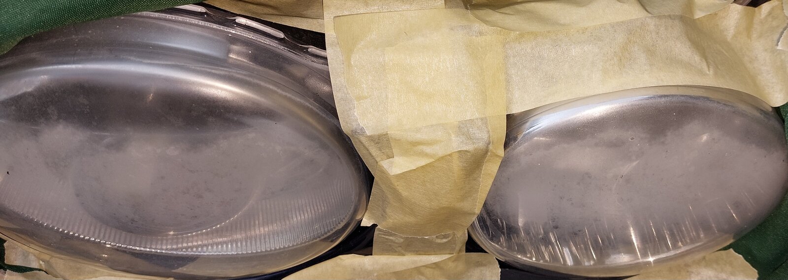

I have oxidation or tarnishing on the "glass" of my headlamps.
Polishing it off is slow and tedious. I bought a buffing wheel made of cotton disks stitched together, used in an electric drill with an arbour, it polishes by holding the edge against the plastic. It tends to throw the Polish off. Is there a better way?

I've used those kits before. You might be using a bit too much compound if it's going "everywhere", but some splattering of the surroundings is inevitable, I'm afraid. The buffing mop that came with my kit is more of a sort of "toweling" affair though, like the polishing bonnets you get for some car polishers.

For the best results I tend to find it's worth an hour wet and drying them from 400 grit upwards to 1200 grit then polish, if it's for one of my cars then ill normally ask the local bodyshop to clear coat them too
Coating is important. They're coated from the factory, but once the coating has failed and they go dull, they'll do so again, very quickly, without another UV resistant coating.

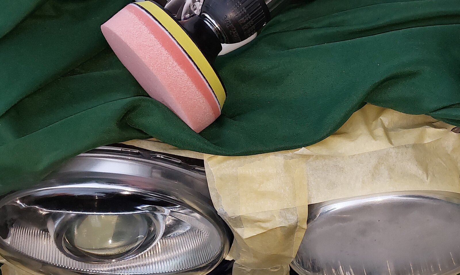

I've been looking at buffing sets
I think I need a rubber disc with arbour, and pads or bonnets to put on it.

My various buffing kits have arrived.

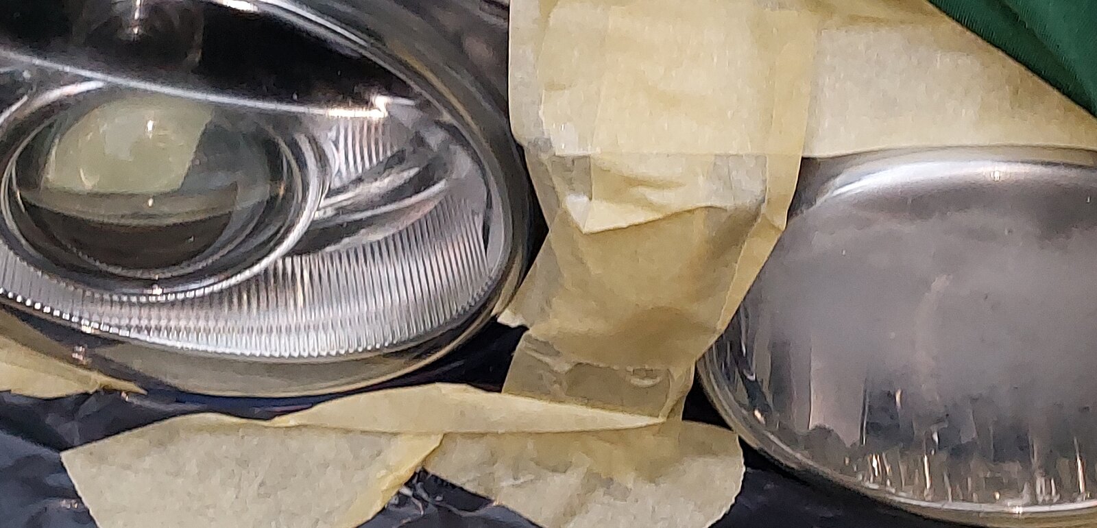

I got the best results with the foam pads, which attach to the rubber backing disk with velcro.
It is much faster and easier than the cotton mops, and does not throw off drops of polish.

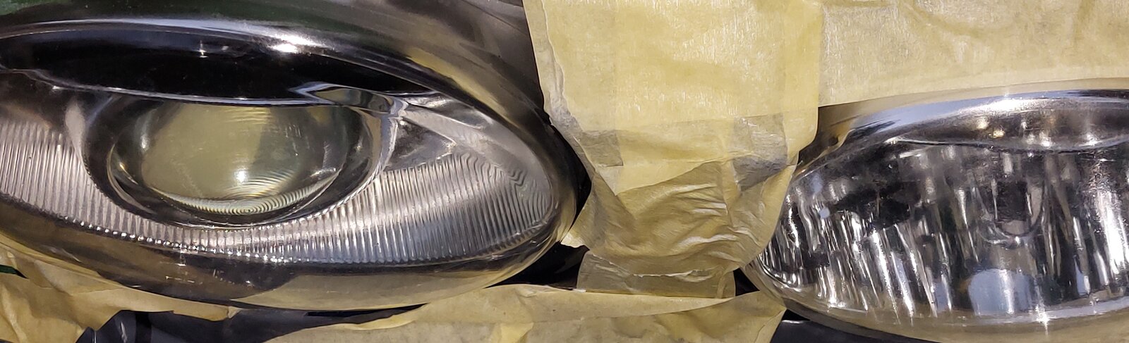

I find the results satisfactory.
The protective lacquer I can only find in aerosol cans, so I will have to mask the car very thoroughly and do it on a still day.
