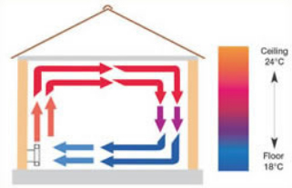

Hot water likely no, but this is the standard picture of how a radiator works.

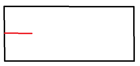

So if we take a long tank with an immersion at one side, no reason why it should not do the same, so we are looking as the shape of the water tank. And put some dividers in the tank, or split it into two tanks and the flow could be increased.
Hot water likely no, but this is the standard picture of how a radiator works. <image> So if we take a long tank with an immersion at one side, no reason why it should not do the same, so we are looking as the shape of the water tank. And put some dividers in the tank, or split it into two tanks and the flow could be increased.
Sure, but that's not really the question, since the diagram shows the radiator at the bottom of the wall/room.
What if the radiator were mounted half-way up the wall (which is the sort of situation the Poll question was asking about)? Would you then expect appreciable heating of air below the radiator to happen?

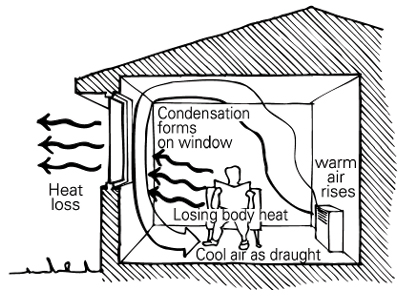

Over the years many diagrams have been produced to show air flow,
they do not take into account all items, and with double glazing and cavity wall insulation there must have been changes, but to stop the general flow as shown and leave a layer of cold air at the bottom the heater would need to be a fair way up the wall.
There are problems, like having the wall thermostat 90° wall to radiator, measuring the air just under the radiator would be best, so measuring return air, but measure just slightly to one side seems to work very well. i.e. the TRV.
There are still problems, reverse to picture we tend to put radiators under the window, which means until the flow has initiated, the TRV head is cooler than the room in general, due to being next to a cold wall, and some can be paired with a wall thermostat to get around this problem.
There is also the law problem, where they give the height of items to be viewed and items to be manually adjusted, these heights may not be the right height to sense room temperature. So I am sitting back to the window, and the sun has heated my desk thermometer showing 30°C behind me and low down the TRV is showing 20°C, and across the room the wall thermostat is showing 22°C the heating is not running, The desk thermometer can show rapid cooling when a cloud comes over, so I assume a lot of inferred heating, rather than air temperature.
But in general we want cool and hot spots in the room, to heat a cold window must waste heat when we do not sit in the window, but further into the room, and simple curtains can change the way the room is heated.
We do in the main want air movement, which is a problem with UFH as it does not circulate the air, as all the floor is heated.

If the tank has a heater like this 1772544916823.pngthen even halfway up, it is likely to start a circulation, so we are looking at the shape of the container, and a rooms shape is not the same as a water tanks shape, we use a water tank shaped like a cylinder because we want it to not circulate, with some tea boilers we put baffles in them to stop the circulation so we get repeated cups of tea with a tap near bottom of the tank, we design the vessel so cold at the top and hot at the bottom, reverse to nature.
With the back boiler we wanted a tall tank and the water would be hottest at the top, and the water was circulated by the boiler putting hot into the top and drawing cold from the bottom, latter we used hot coils, so the water did not mix, but my childhood house, there was no hot coil, the Aga heated the actual water which came out of the taps, and the water did not suddenly go cold, but was more gradual as one ran a bath.
Today the digrams are more theoretical, the diagram here shows one tank, Torrent pipe example.PNG in real life there were two massive tanks upstairs so if there were a mains failure the water would still flow from back boiler to tank, and the floor was reinforced to take the weight.
