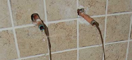

Have come across newly installed showers with poor flow,its either flow reduction in the shower mixer valve or the hot & cold water feeds are restricted.
Turn off hot&cold water,remove mixer valve,get someone :cautious: to hold a bucket in front of the pipe/connection stubs.Fully Turn on hot & cold water and measure the flow rate if necessary.
Pic below shows poor flow.
Person holding bucket will now be very wet :!:
if there is good flow on both connections then the restriction is in the shower mixer valve.
