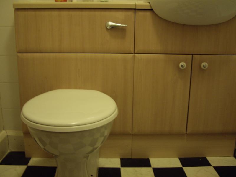

About 2 years ago, we changed the toilet for a built in type with the flush mechanism concealed in the housing unit, as shown in the picture
The flush efficiency was never very good and in an attempt to improve this, I recently changed the pipe connecting the cistern to the pan: the old pipe coupled the cistern to the pan via a right angle bend, and the new pipe has a curved radius
With a single action to the flush lever, the water does appear to flow into the pan at a reasonable rate, and empties the reservoir completely.
However, the flush results have been getting worse and often the waste is not removed
It is possible to get the waste removed in the majority of cases, but only by doing either of the following:
a) pump the flush lever many times until the water in the reservoir is exhausted
b) pour a bucket of water into the pan
The cistern is a Thomas Dudley Ltd Turbo 88 WC Syphon
Obviously this is not satisfactory, and I am looking for any suggestions to improve this
Thanks for reading and any help
If it is a close coupled toilet they are never very good at clearing all the pan contents! :(
Are you sure there is no blockage further down the line?
If you have to pump the lever, it usually means that the diaphram in the siphon is split or deformed.
Andy.:cool:
As Carlo pointed out
Will be observed by the pan partially filling on flush and slow to drain.
Are there any tree roots close to soil waste pipe runs, conifers are worse for this ;)

do you put anything in the cistern - such as chemical cleaning blocks? it could be that something is lodged in the syphon and is restricting the flow. may even be part of a shredded diaphragm

Comparing the ground floor toilet (good) and first floor toilet (poor) the cistern on the ground floor has a fall of about 12 inches to the pan, while on the first floor, the fall is only about 6 inches
The water definitely flows into the ground floor pan much faster than for the first floor pan; also the gap under the rim is wider on the ground floor pan
Finally, the down pipe on the ground floor pan is very short into the pan, while on the first floor pan it inserts a long way
Clutching at straws a bit, but are any of these likely to be the cause
Thanks for reading and replies
Geoff
There, I think lies your answer. It seems more likely to be the design of the pan than any fault with the appliance. The old high level cisterns used to give a shorter, but devastatingly effective flush! Basically, the higher the cistern, the greater the force of the flush.
In your case it seems there is simply insufficient power in the flush to clear the contents of the pan, only long term solution would probably be to change the pan. Or, if as Bahco suggests, it is close coupled its likely the pan and cistern would have to be replaced as a unit. Seems with the advent of 6 litre flushes and modern pans, the idea of saving water is not effective in practice as two or more flushes are often required to clear the contents of the pan. (Another bright idea from Brussels I believe....)

Yeh that's a "Low Level" cistern you've got then. With a flush pipe connecting the cistern to the pan. One thing to try would be reattach the cistern higher up the wall, and install a flush pipe with a longer vertical run, giving you more head (so to speak) and a better flush.
Hg - Do you have a long(ish) near horizontal run to the soil stack? In my experience this can have a marked effect on how efficiently waste is disposed of. Nothing wrong with the flush, but the pipework is too flat to get an efficient siphonic action going.
Alz0r
I think resiting the cistern is a non starter - if the image shows correctly, you can see that the cistern is of the concealed type and sits in a unit. This was purchased as a complete package from Homebase and the pan is a "Monte Carlo" Back to Wall Pan
