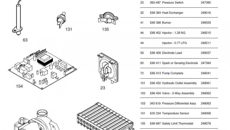

the order numbers are also different. See items 131 & 135 from the image attached.

You need to compare the ch sensor and the dhw sensor, not the overheat stat.

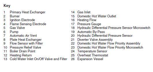

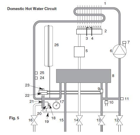

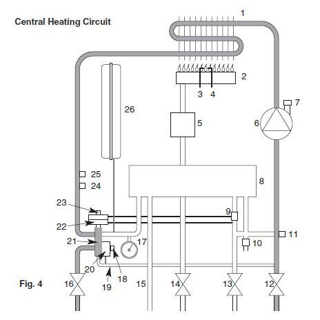

I haven't been able to find a separate sensor for CH and DHW. The diagrams only show one single sensor (no. 24 on the diagram) which is used for both modes of operation. Am I missing something?
Hi Josh,
do you mean whether there is a diverter valve? There is one which directs the water to be heated to either be the CH water or run in a closed circuit when doing DHW (see diagrams below). I would say the pump runs all the time on either CH or DHW, since it is the same circuit apart from the plate exchanger.

The microswitch is actuated by a pin which comes out of the diverter valve when heating is required. Normally the pin is inside the diverter valve when no CH is required, but it sticks out actuating the microswitch when the CH is activated.
