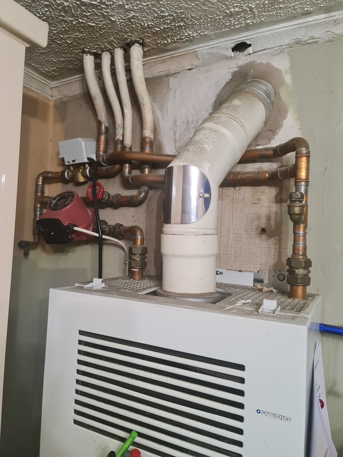

No that is not how it should be wired, it is possible but very unusual to have gravity HW with a zone valve on the system, are you sure you have gravity HW ? post some pics of the boiler the pump and the pipes coming out of the top of your boiler

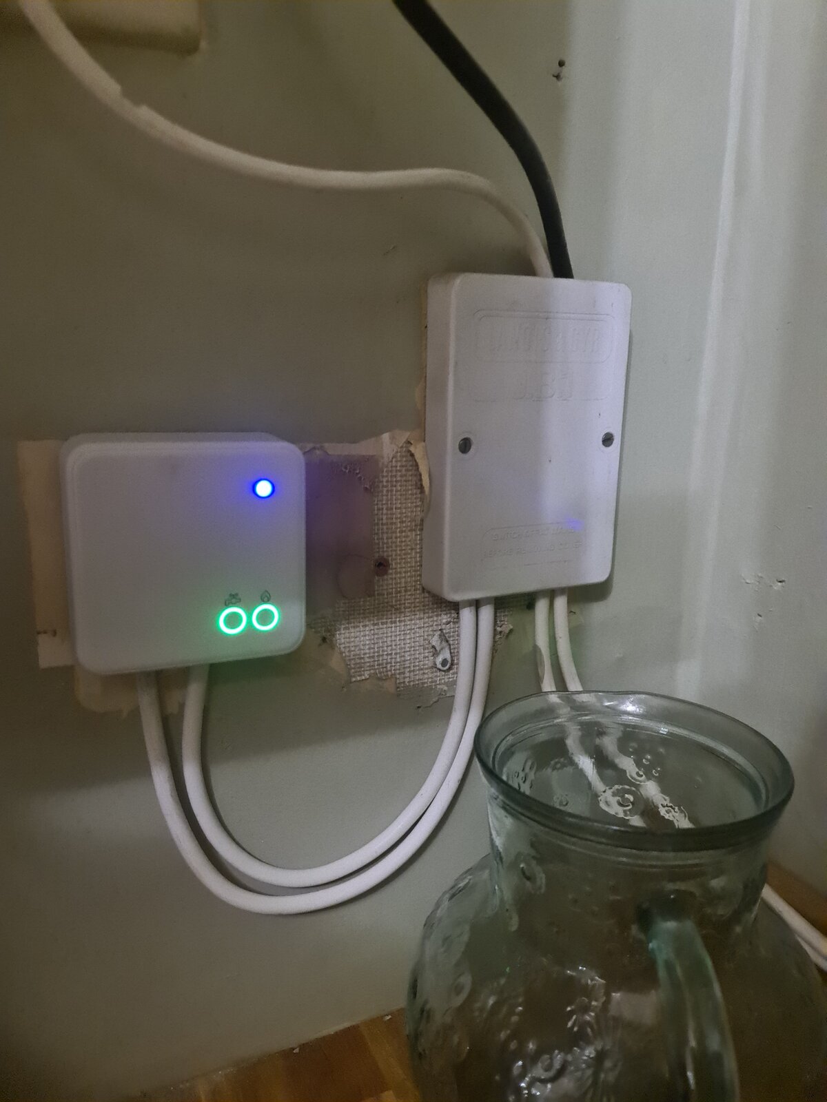

So here you go. Top of boiler pipe work. I have a junction box, the controls (formally the switchmaster now hive) are wired into it. Live and neutral wired to the junction box via the controller Motorised valve to the junction box, junction box to the boiler. There is also a wire from the junction box going up stairs which a assume goes to the hot water tank. The pump is on the hot water and the motorised valve on the heating. I checked and I could hear the motorised valve close when I selected hot water without heating.
As suspected you DO NOT have Gravity HW system, you have a botch, show a pic of the wiring in the boiler and the wiring centre and your hive , it is not wired correctly and not set correctly
