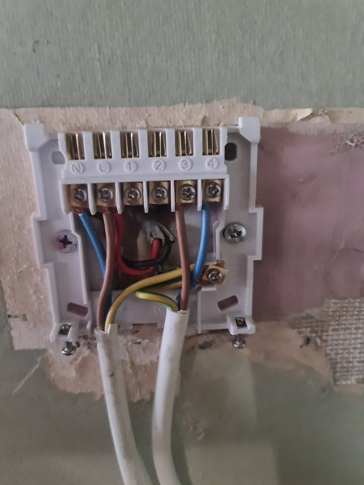

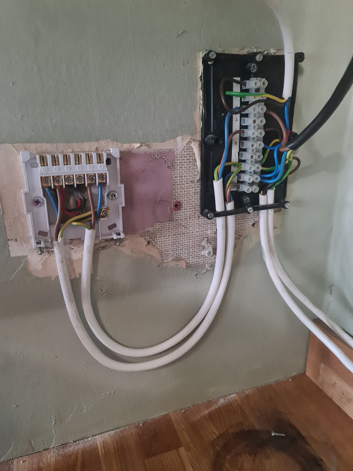

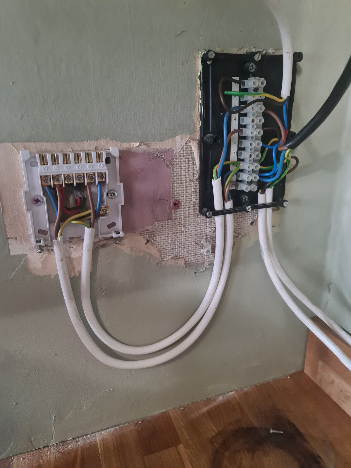

So some explanation may help:
Hive left cable permanent live and neutral, right cable HW on and CH on

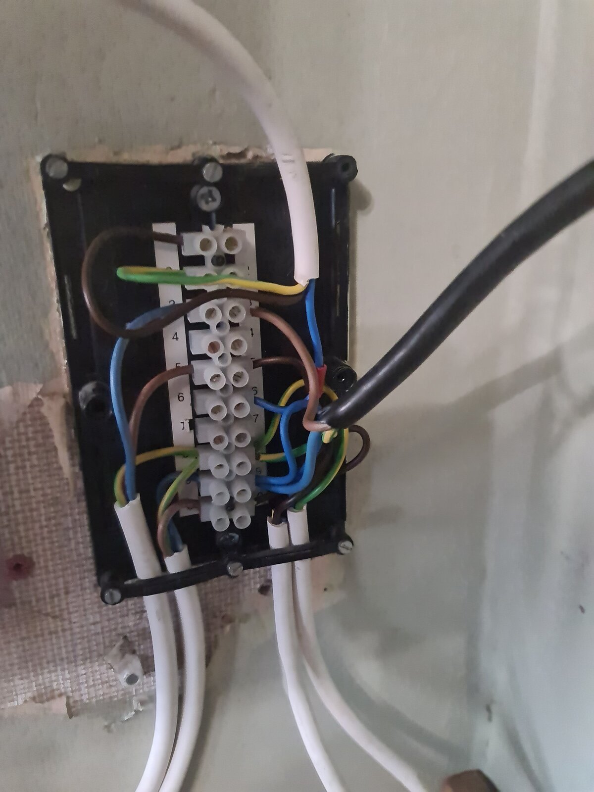

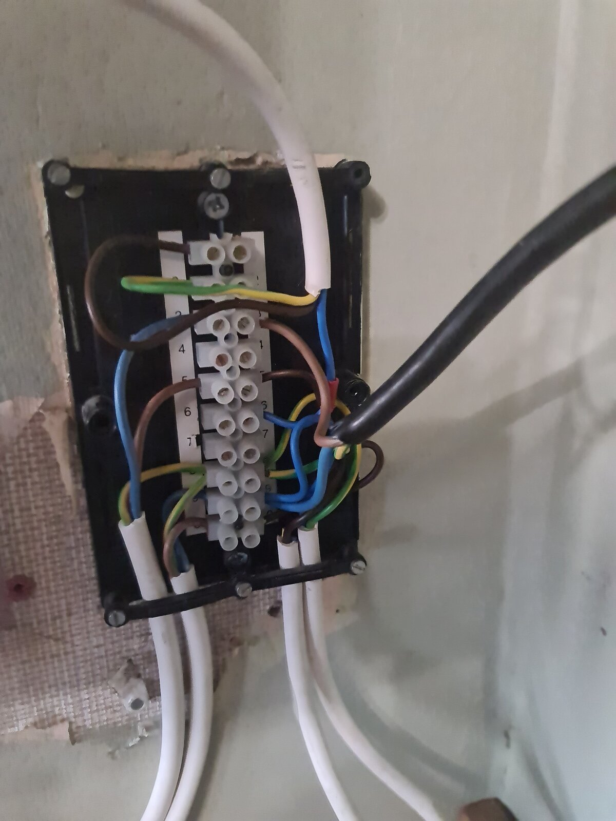

Junction box:
Bottom left furthest left HW on and CH on, inner left permanent live and neutral.
Top left hot water tank
Top right mechanical valve
Bottom right go to the boiler.

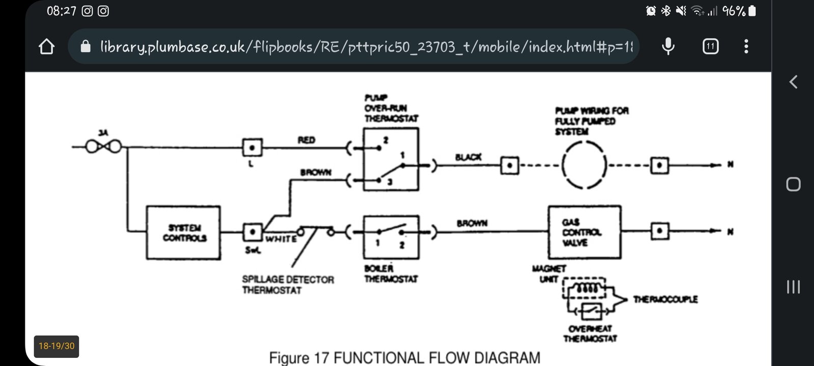

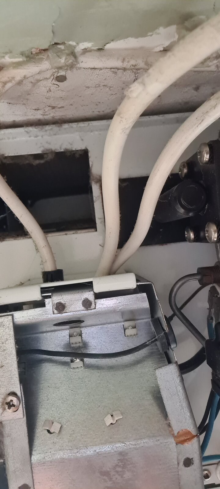

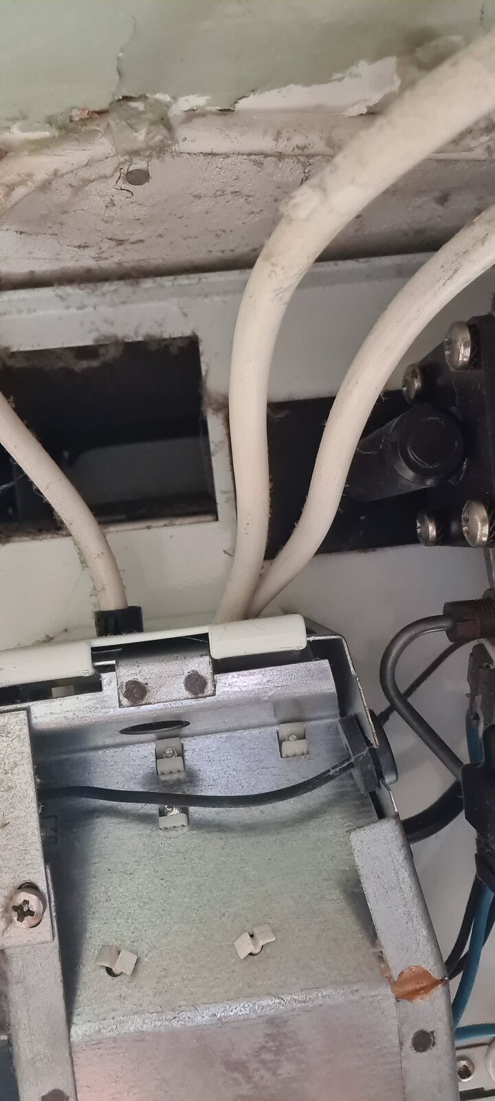

Hi everyone, so I've tried something for fault diagnostic purposes. I electrically disconnected the motorised valve and used the manual override. Still have the same fault, so I'm thinking (happy to be wrong) that with the valve disconnected and the controller replaced, it rules out external inputs and it means it's a boiler problem.
So some more info. A boiler guy came round yesterday and diagnosed the problem as a PCB, we've subsequently worked out there isn't a PCB. Now what are peoples thoughts? I was thinking about the pump overrun thermostat, I wasn't sure because how would it fire up the boiler. I am wondering if it's broken down and putting a live back though (via brown wire in the diagram below)
Contrary to your assumptions earlier your motorised valve does open on heating demand, when the Ghost on you refer to does the pump only run, or does the boiler actually fire at the same time ?
