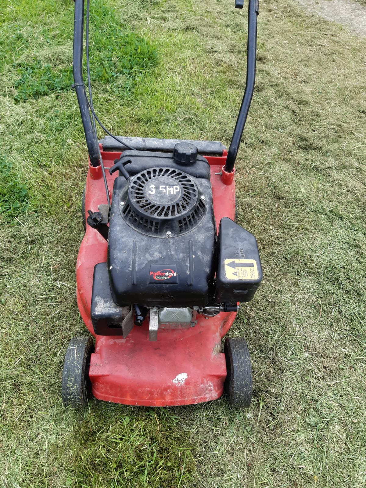

my Power devil 3.5 Hp petrol mower stats from first pull but stops again after few second. any idea why and how it can be fixed.

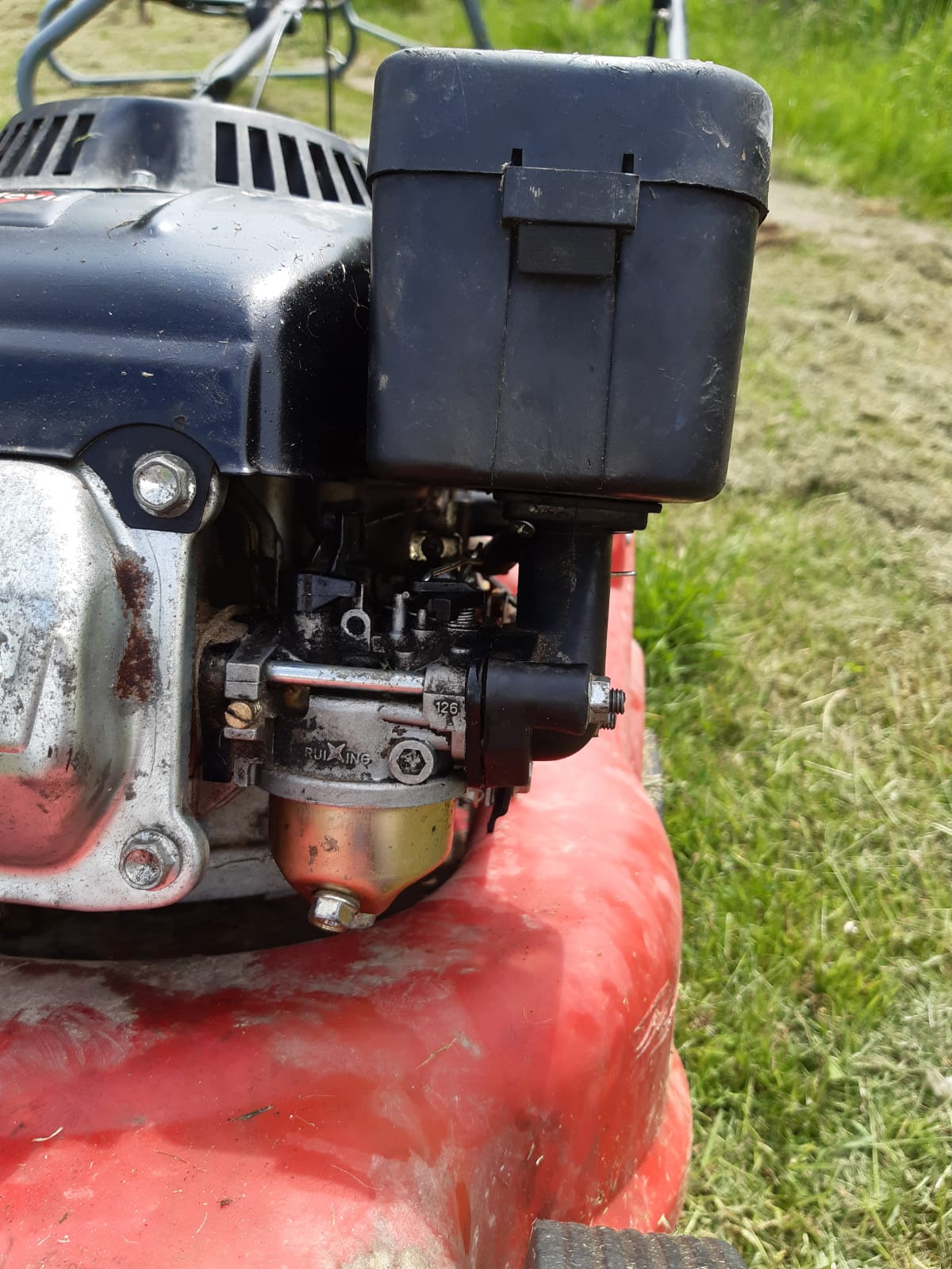

Picture of the carburettor area if you can please.....does it have a large primer bulb on the top of the air filter, making it a Ruixing carburettor?

here is some pics
Yep, thats a Ruixing carburettor, dead easy to work on but you'll need a can of carb cleaner standing by. Take the air cleaner off, and clean all of the crap off the outside before unbolting it from the engine.
You'll need a 10mm spanner and a plain screwdriver with a 6mm blade to get the jets out.
