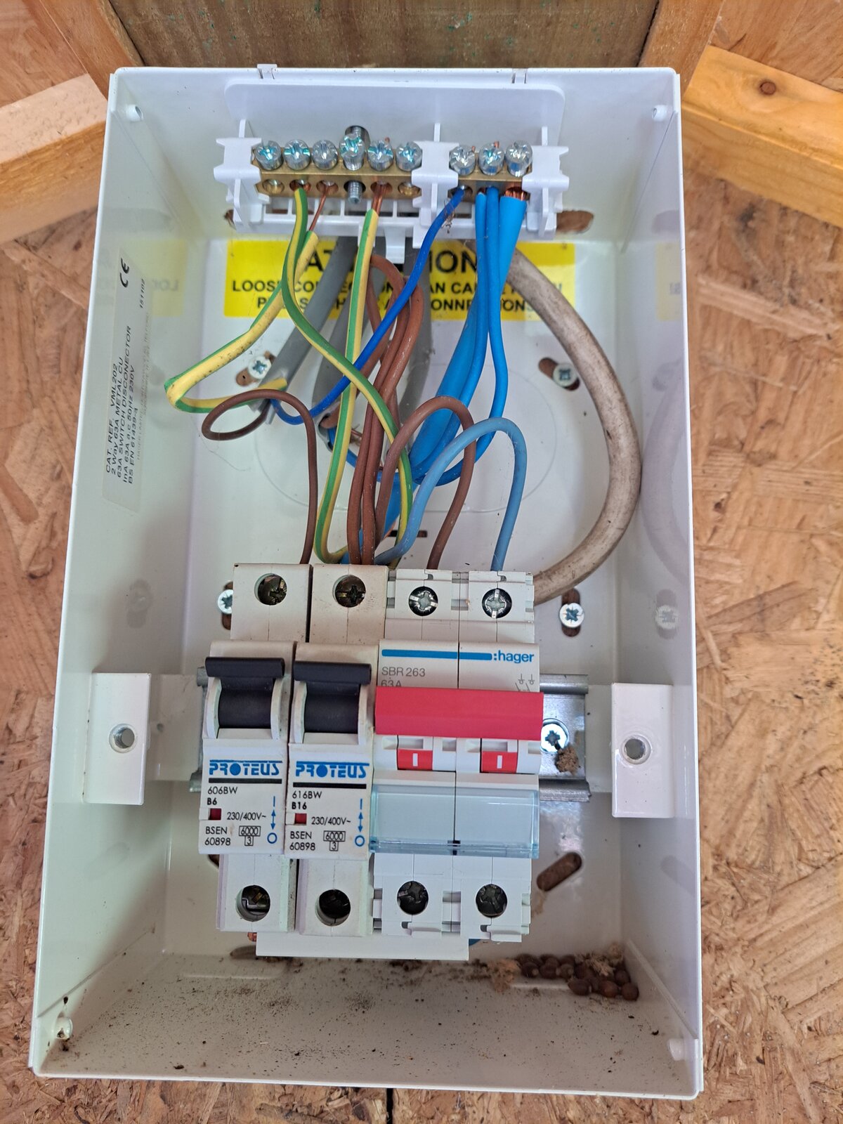

hi experts, but stuck here changed a light B6 tripped but not socket B16, now nothing coming on after on off a few times, sockets not coming on even if leave B6 off, feed coming from house to cabin and was fine before trip. Any help welcome

Just noticed the thread title:
"also should the to live and natural go in bottom?"​
The Line and Neutral supply conductors should go in the top of the main switch.
hmm thanks all, the live wire in the RCD had burned removed and now fixed.
