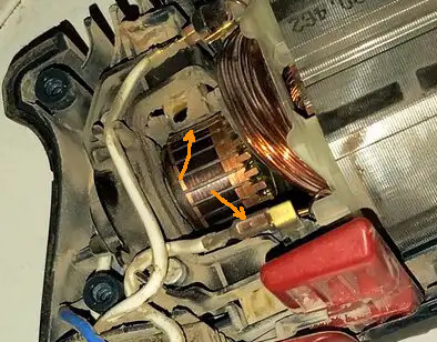

Where are the brushes on the drill please?
The brushes are the carbon blocks than connect power to the rotor. They press against the commutator, which is the segmented copper ring at the left hand end of the rotor (the bit that spins!) They are pressed against the commutator by the springs that push them into the brush holder
The connections to the brushes are shown in SUNRAY's post with the white line. If you don't get any continuity between those points ( turn the drill by hand whilst you check) then it's likely the brushes are worn or jammed in their holders, thus not making contact.

So between the two white wires I got 0ohms well 00.6 is that close enough. I can't get a reading in the live and neutral incoming I think I'd need to pull the wires out.
It could be the fault of course but I take to be a good sign.
