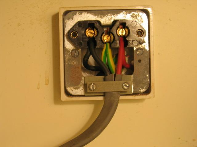

Hi all,
In preparation for installing a new gas hob (using a standard plug with
a 3A fuse) I need a 13A socket under the worktop.
There is currently a ceramic hob in its place, powered by
(what I believe to be) a 30A supply.
I need to install the socket ready for the gas hob commissioning,
but without disconnecting the ceramic hob, which will be in use in
the meantime.
What's the neatest way to do this?

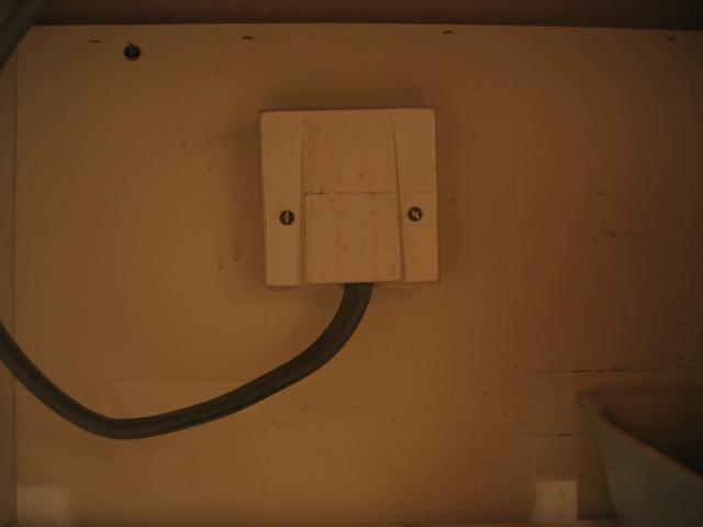

Here's a picture of what's underneath the worktop at the moment.
The cable goes to the ceramic hob.
Thanks in advance.
The normal way is the replace the cooker connection unit with a socket at the time when the hob is replaced.
Since it will likely come under Part P and to add a socket before the hob is disconnected would mean replacing the back box with a double to take both the cooker connection unit and 13A socket really it's a non starter.
I guess you could fit a socket the day before. And put a plug on the end of the hob cable.
Tape up the hob switches so only one is used in the mean time, so it don't blow the fuse in the plug.
One way if you can manage with one hob ring over night.

Why can't you swap the outlet plate for a socket or switched FCU just before the guy(s) installing the gas hob arrive?

Thanks, that's a good idea. I was thinking of preparing the socket
long before the gas guys arrived, but it may have to be done this way.
The gas guys already said "we're not electricians" so it would probably
be up to me to disconnect the existing hob anyway.
