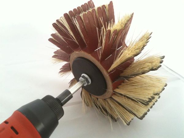

There used to be an industrial sander called an Engis head which was basically a wheel with outward facing brush segments at intervals interleaved with loadings of slashed sandpaper. They were purpose made to sand awkward shapes in the furniture industry as well as for stripping awkward shapes like stair handrails, turned newels, etc (when they would be used on a flexible drive shaft and portable motor). Whilst they were originally designed for use on a double ended polishing machine (basically a slowed down d/e grinder) I've seen a number of similar, but smaller, portable versions over the years. B&D even made a DIY version in the 1980s and Makita still do a trade version (albeit at around £400) and Metabo do a version aimed mainly at industrial metalworking, but I'll have a poke around and see if there is still a drill-mountable model out there
Edit: There is a sort of relatively low cost DIY version of the Engis head out there called the Eco-Flex profile sanding head which may or may not be suitable for your sanding needs, depending on how many profile or round bits you are sanding. Needs a corded drill and a thick leather glove, though
Yeah, I have ordered a set of 'flap disks' for my drill. Essentially the same thing, but nice to know the proper names. Should the ones I have ordered be a load of rubbish, which is quite likely, I'll have a search for the real deal.
I wouldn't bother searching for Engis heads too hard - the last one I bought, about 18 or 20 years back was more than £150 (I was workshop based, then), and in any case Engis got taken over so the name has changed. The slash loadings for that head were about £40 or £50 a box, but they are industrial and I was just trying to illustrate the principle.
At one time I did have the B&D DIY sander at home which was very similar, only lightweight, however it did do the job on the spindles on a Victorian house I was refurbing for myself quite well. For some reason, though, they never caught on in the UK and B&D dropped them by the 90s(?). The type of head I referenced looks very similar to the B&D heads, so should work in the same way - start with P60 or P80 grit then move up to P100 or P120 (for exterior work it probably isn't worth going any finer). Just make sure that you don't over sand - keep the head moving all the time and use a multitool or hand sand to get into really tight corners as brush backed heads can round over sharp edges all too easily if you aren't paying attention. I'd also recommend wearing a thick glove on the hand which is nearest the sanding head as what strips lacquer finishes will also be good at stripping skin!
