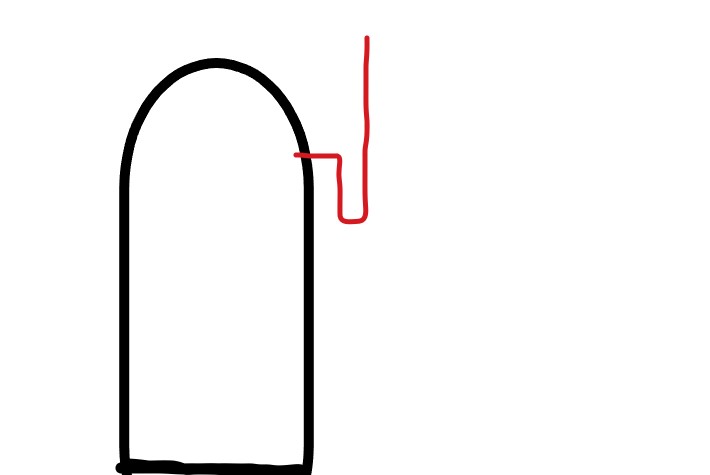

Hi i have a few issues with my Thermal store heat from leaking away via reverse thermosyphon, ie hot water is rising from flow to thermal store up the pipe in loft out to boiler outside when pump and boiler are off. Can you recommend the best non return or check valve, I have a few leftover Drayton ZA5 valves would prefer simplest and best for flow thankyou.

The thermal store is possibly 1ft higher over the external boiler from ground level (taking into account floor dpc/screed etc. All i know is when the WBS is running and the boiler is OFF one pipe is hot one is warm. The boiler is OFF at the isolator.
Re image below you can see i have some issues here(!), yes the pipework is a bit non standard as its still being developed, pumps are now both horizontal.
Seems i have multiple issues as the Central heating flow feed is heat leaking as is the Boiler flow pipe. I think what is exasperating this is the flow from the WBS is pumped via Ladomatt and it seems the water going in the top of the store via the flow input is flowing straight out again up the Boiler flow via thermosyphon up into loft cooling coming down into boiler on external wall.
As suggested i feel my solution here is to drop both CH and Boiler circuits down 15 inches before they go up. My only other concern is both these circuits are running through the day, will the residual hot water in the vertical sections in the wall (both flow Boiler flow and CH Flow go UP into loft) still cause enough gravity to pull cooler water from the bottom of the U or inverted loop and start to siphon again.
The boiler flow should have what I know to be a london loop. The pipe drops down below the store connection about 300mm and the rises up and then connects to the store.
Ahh, interesting setup. You need to keep the thermosyphon going in the woodburner circuit, the London loop sounds like a good lowtech solution to backfeeding up to the (gas) boiler in the loft. I'm sutprised you don't have motorised valves on the CH circuit- that would prevent that uncontrolled heating effect.

Yes this is why I posted on here pondering on whether to use loop or a few drayton ZA5 control valves.
With only a foot differential the Laddomat is pretty essential....
Loop or motorised valve- on the boiler flow the loop is (IMHO) a better fix- no moving parts, no changes to control circuits but may be a faff to retrofit. Motorised valve will work but you'll need to integrate it into the control system & cater for any pump overrun on the boiler. On the CH flow I'd go motorised valve purely for the additional control (this is assuming you have adequate heatloss arrangements elsewhere for the woodburner). Honeywell are a more reliable valve....
