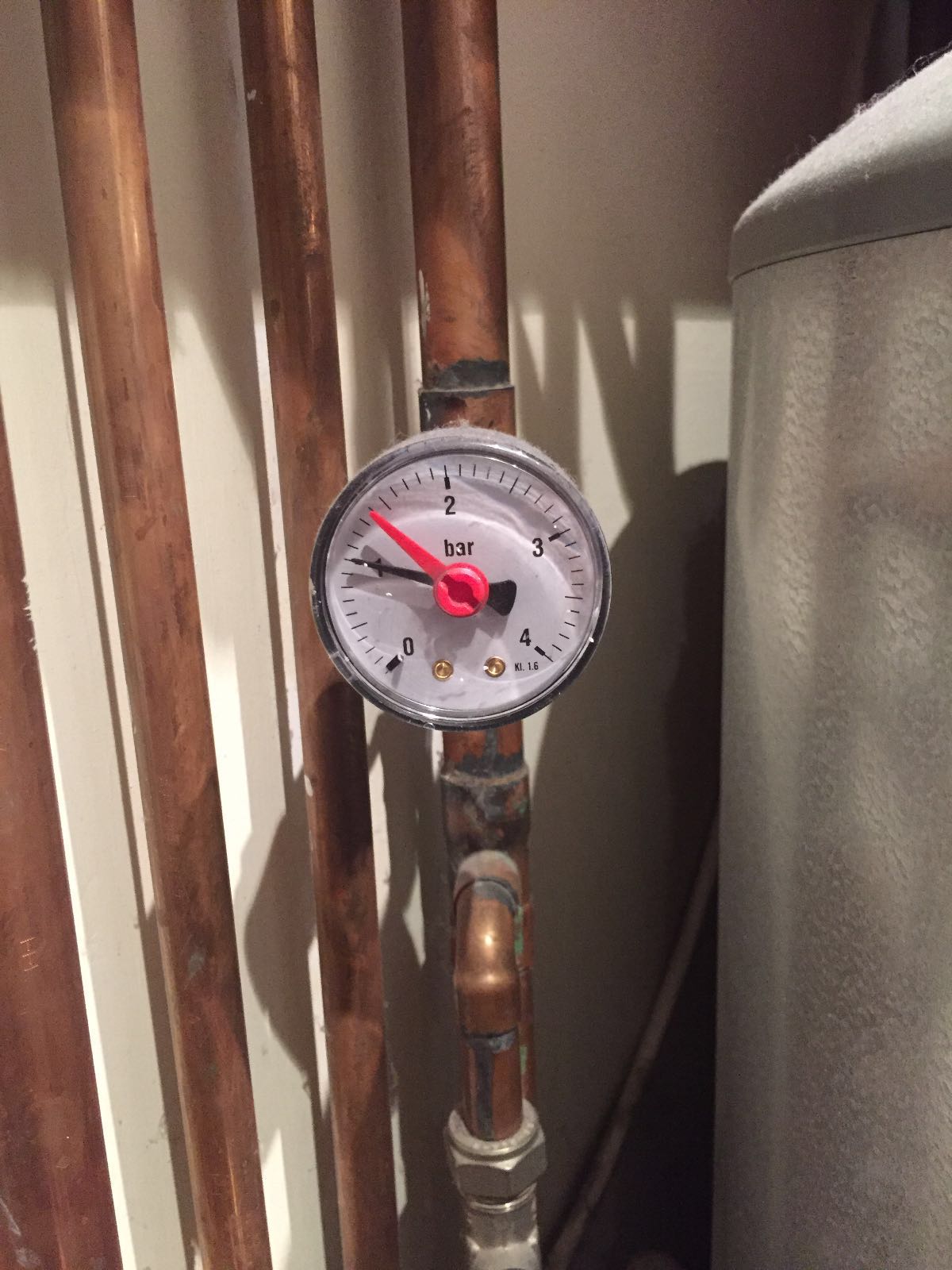

Not a scoobie until I get over there and investigate hands on. Heres a partial pic if that helps.

Not sure, but I thinks it's an unvented cylinder, in which case, you need to turns the mains stop cock off to stop water flowing through it.
Well as the hot tiles didnt cool down when the boiler was shut down for a couple of hours, even when all rads were cold, Im guessing that the leak is coming from the feed from the hot tank to either the shower or the sink, so my first test was going to be shut boiler down, and run hot taps until they run cold, then see if tiles cool down. That way I at least know what line is leaking.
