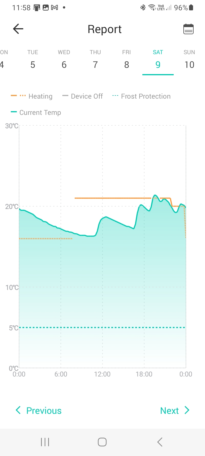

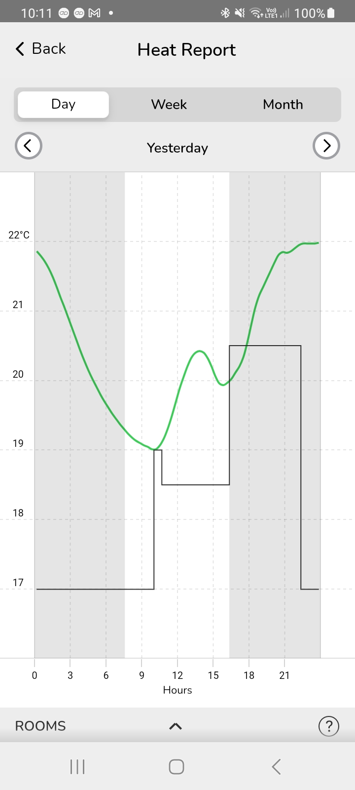

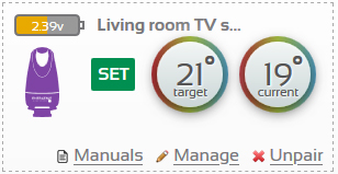

Be it the TRV or the wall thermostat, today most do report how the room temperature has responded, one does not care if radiator hot, cold, or warm, what one does care about is the room temperature, and how closely it follows your settings, so my living room thermostats show 1731665710073.jpeg at TRV and 1731665685476.jpeg at wall thermostat, as said oil heating so it does not modulate, if I look at living room temperatures now, above fire place 19ºC, wall thermostat, 19ºC, west TRV 19ºC and south TRV 18ºC this is actually unusual I thought I would be quoting very different temperatures through the room, I was going to point out how hard it is to get a room at an even temperature. Hall TRV 16ºC and wall thermostat 17.5ºC very rare to see them all so close.
