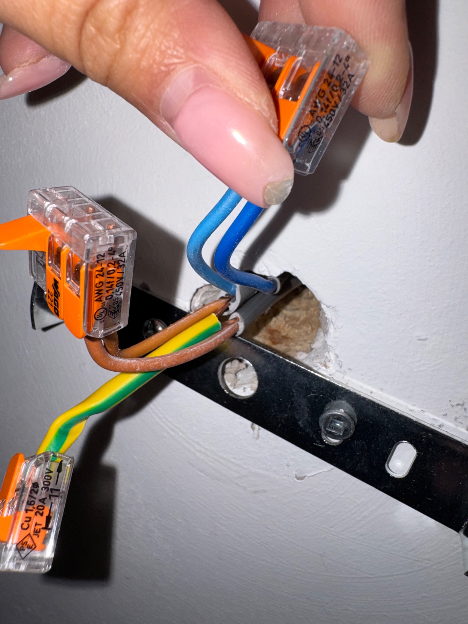

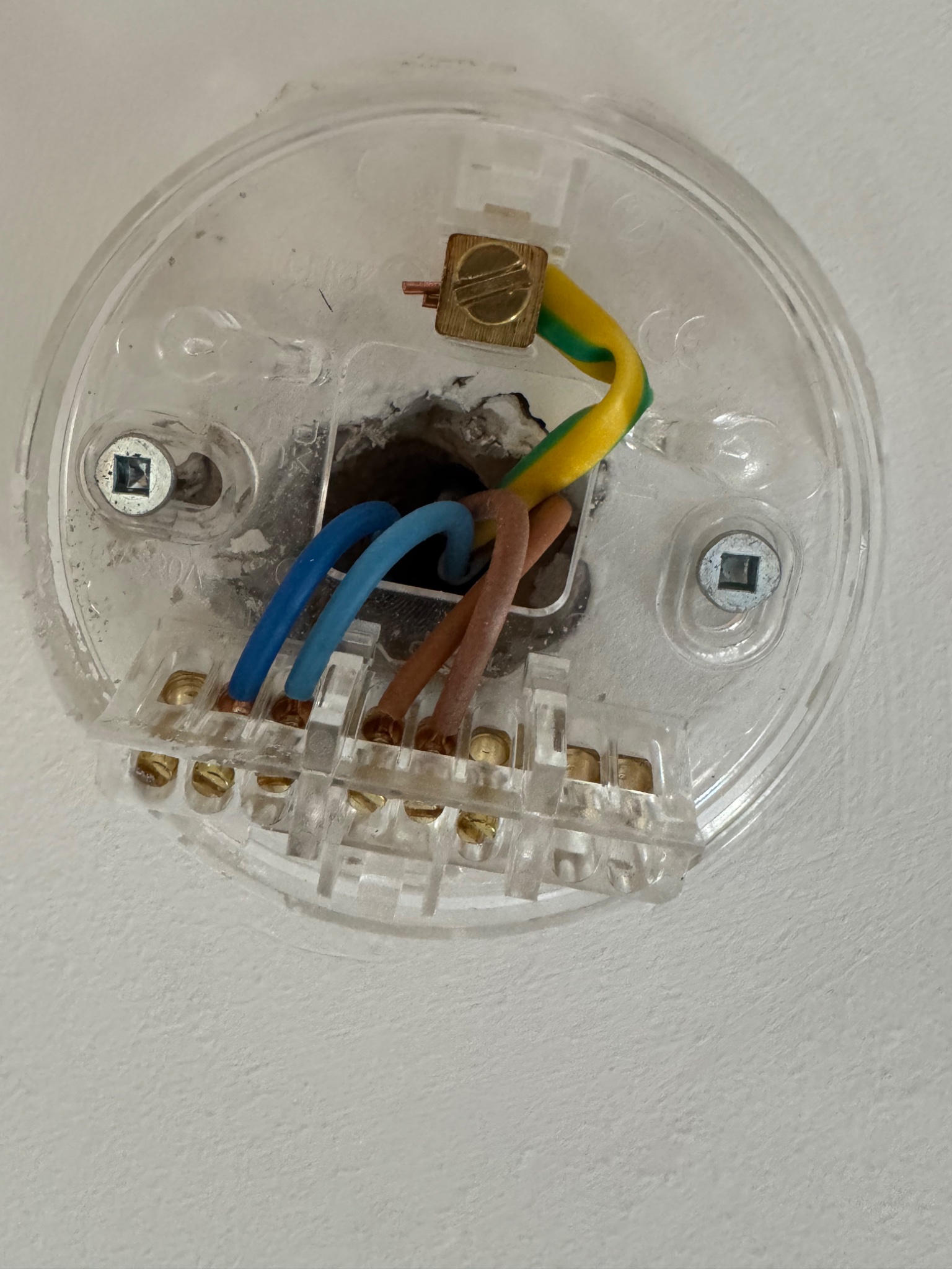

I have a UK two-way switched hallway lighting circuit with two ceiling roses. I’ve successfully converted the first light to a modern fitting using Wago connectors. The second ceiling rose only has:
  • 1 twin & earth cable (brown, blue, earth)
  • 1 single brown conductor with earth
  • 1 single blue conductor
The original ceiling rose had two browns together, two blues together, and no obvious wire in the L terminal. If I connect the two browns to the new light’s L terminal, the light is permanently on, while the first hallway light still switches normally.
Can anyone guide me in the right direction?

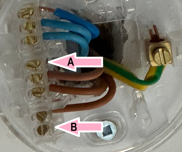

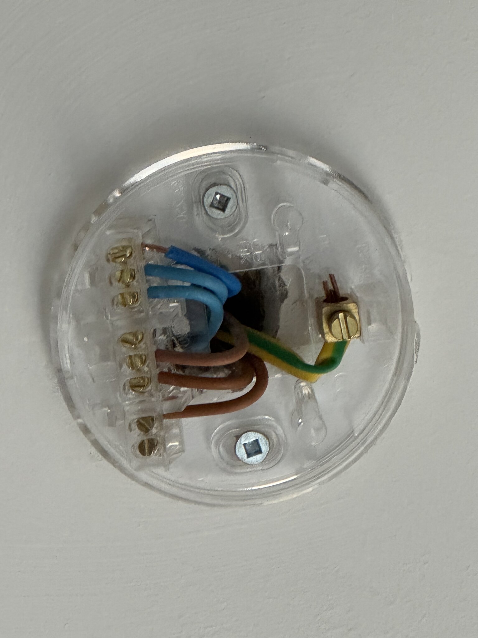

This is the other ceiling rose. I was able to get this one working because I can see there’s one brown in the live terminal. So I must be missing something with the second one. I just don’t understand how there’s only 2 brown and they’re both in the loop terminal…
It's somewhat different to normal.
Did those 2 lights work together before you started?
Where was the brown of the light connected? A or B I assume the blue was connected in the very top terminal
As things are I suspect you have mixed up 2 of the browns
EDIT: Did you check correct functionality after changing the first light but before changing the second?
EDIT2: Is there any chance these 2 lights were originally not a pair of lights on 2 way switches, I.E. 2 one way switched lights?

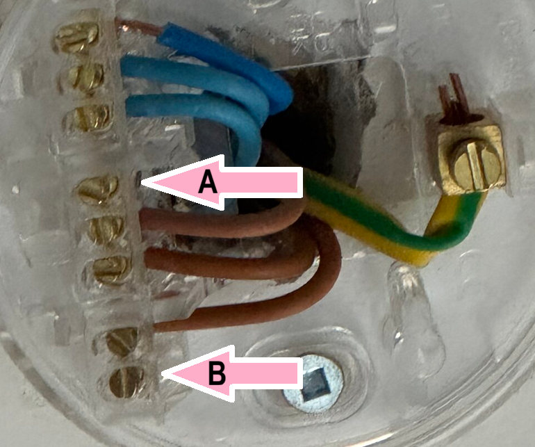

Thanks I will try switching the browns on the first rose. The light was connected to B
Before you do, does that light work as you expect it to. Can you switch it on and off in any combination from both switches?
Where was the brown of the light connected? A or B I assume the blue was connected in the very top terminal View attachment 418900
It's a very common way for it to be connected in Ireland, where this installation almost certainly is. That said the neutral at the top doesn't appear to be properly engaged in the terminal.

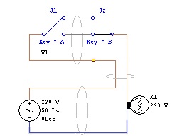

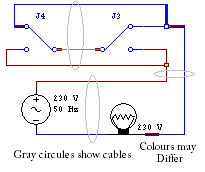

I have tried a selection of circuits but struggle to understand how that may have worked, I'm guessing there is a junction box in there somewhere.
Perhaps you could supply a schematic for future reference please.
As the screw is undone I made a guess the pendant was in the same hole and as the wire is now loose it is very likely any tension has pulled it out.
