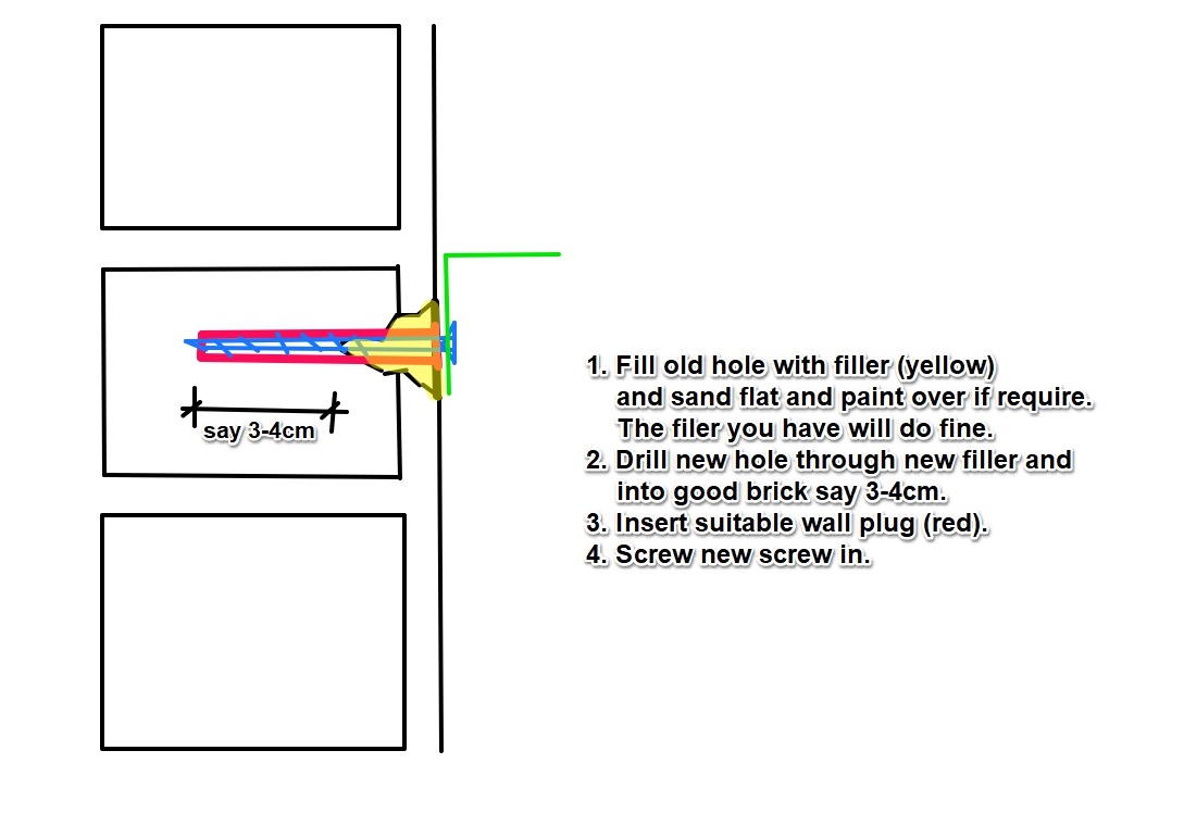

You need to drill through the filler and the plaster into the wall behind, hopefully brick or block, and insert a plug and a screw long enough to pass the load about 2 inches into it

That seems awfully thick plaster? You need to drill the brick or block - beneath the plaster, to a depth of 30 plus mm, then insert the plug into that depth and use a screw just a little short of the hole depth - in brick + plaster + bracket.
I'd like to redrill in the same location. I could move location... but would prefer not to.
You drill through the plaster and into the brick. You can drill in the same place, but deeper, unless it is cratered or crumbly.
Disregard the thickness of filler and plaster, it has no strength, so only the depth of plug and screw in the brickwork will provide support.

Filler will fill a hole, so it looks nice, for decoration.
But you want a strong mechanical fixing that will carry the weight of a curtain and pole.

I recommend filling brick wall using the following filler because it says it's for exterior use. The brick wall provides a strong foundation for the filler. Therefore the fill will work. A plaster board does not give a strong foundation. Therefore the fill will fail when load is exerted.
For my own DIY, I would filled a hole in brick wall using mortar mix (3 part sand and 1 part cement) because it's cheaper, and I have the materials already.
I thought you already have the filler? Just use that. Your local B&Q/Wicks will have ready mixed filler tubs.
