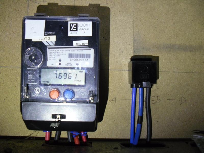

Have you had a search on the internet for the instructions for your meter or contact your meter supply they should send you one. Most econ7 meters have a boost or override button just incase you get a very cold snap. It might save you having to get up early or stay up late.

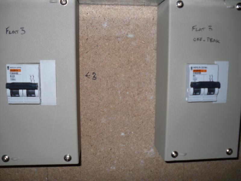

What size is that off peak switch :?:
Looks like a 40Amp to me but from a learning perspective what difference will it make?

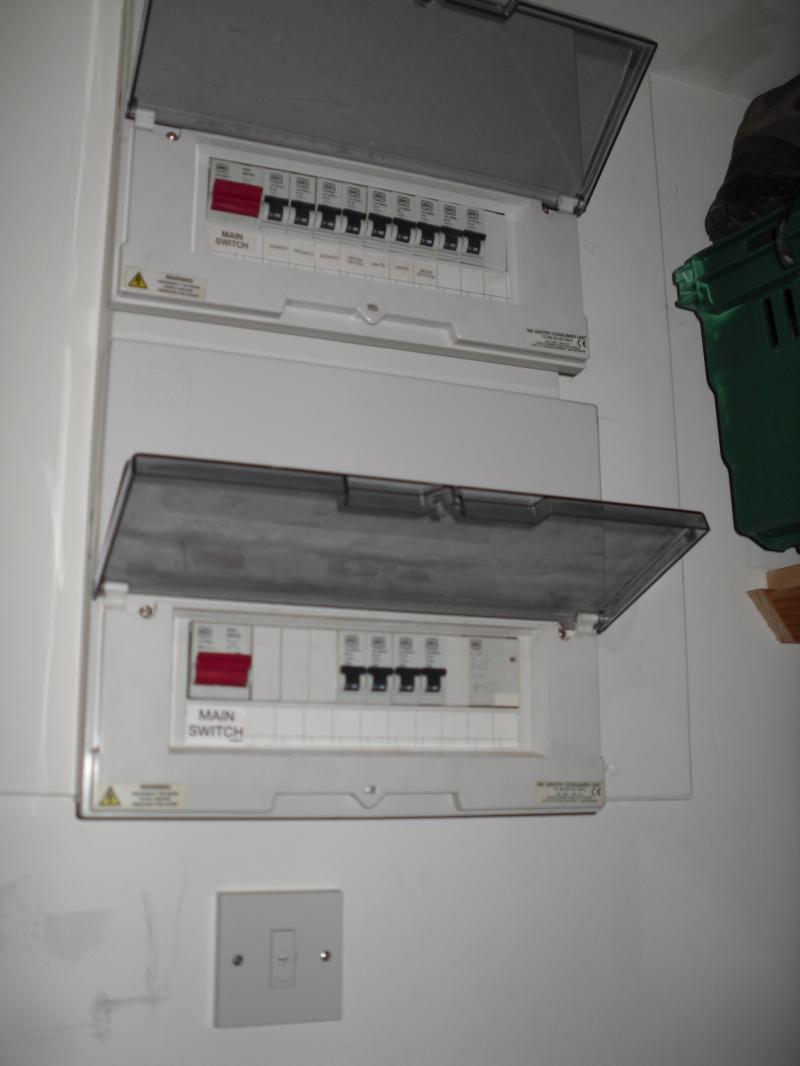

It is obviously switched on - power is getting through to the 4 panel MCB and onto the majority of the panels.
I assume it is some form of contactor switch but isn't it an all on or all off type?
I'm afraid all I can add to this is that each of the boxes in that photo have 2 switches on them. All 4 of these switches are currntly in the 'on' position.
Its the number stamped on the front, left is B63 ? right is ?
Looks to me like a B6 thats why, if so, its too small for the heater load and may be working a control circuit for the 4 pole contactor which does the 4 heaters, the meter tail may possibly going direct to the cu and a 24 hour supply.
I cannot see the reason for the contactor if the meter is timed for off peak
Never seen a boost button on an E7 meter, how does that work then?
The meter and teleswitch are probably located in a meter room, to save running two submains a signall pair is switched by the T/S to operate the contactor in the off peak DB, hence the B6 mcb
My initial thought is that one of the poles of the contactor has failed and is only making intermittent contact, needs checking out by a spark
