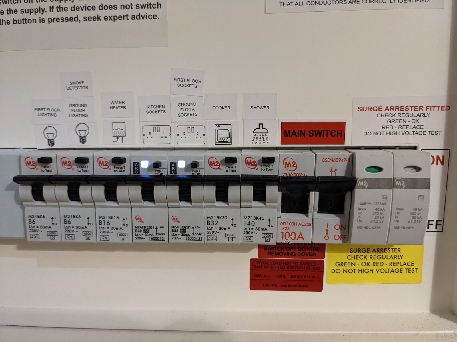

you had better tell us what is written on the device that trips.
all the letters and all the numbers
and preferably attach a photo of it
to start you off, does it say "B32?"
does it have a test button?

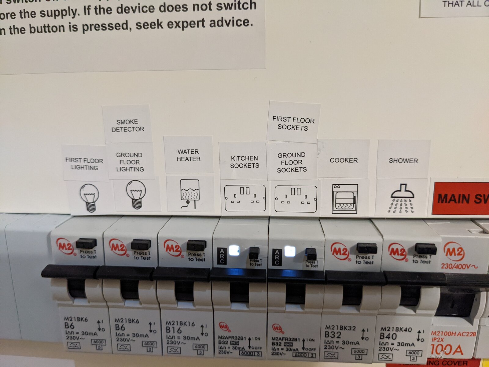

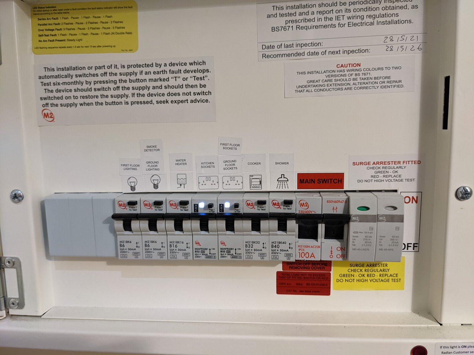

Here is a few pictures of my consumer unit set up. Is that what you mean?

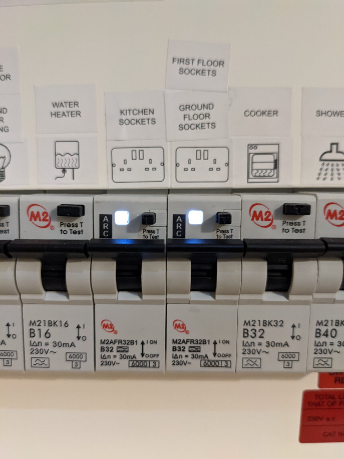

To add to what I posted above yes It does say B32 and here is a closer picture. It also says something about showing what type of fault it is by how the leds flash?

there are 7 circuit devices to the left of the main switch. all are rcbos which is good. which one(s) trip?
do you get any flashes after a trip? which pattern?

Ok so it went off tonight about 8.15 and according to the led light flashes it is saying it is an series arc fault?
from the Schneider website
A series arc occurs when electricity intermittently jumps a gap between two or more points within the same phase. An example of what may cause a series arc is if a wire is only loosely connected under the screw terminal of a wall switch, and there are very small gaps between the wire and the terminal. If the gap is small enough, an arc may occur between the wire and terminal. Because a series arc occurs within the same phase, the amount of current is no higher than the load current itself.
