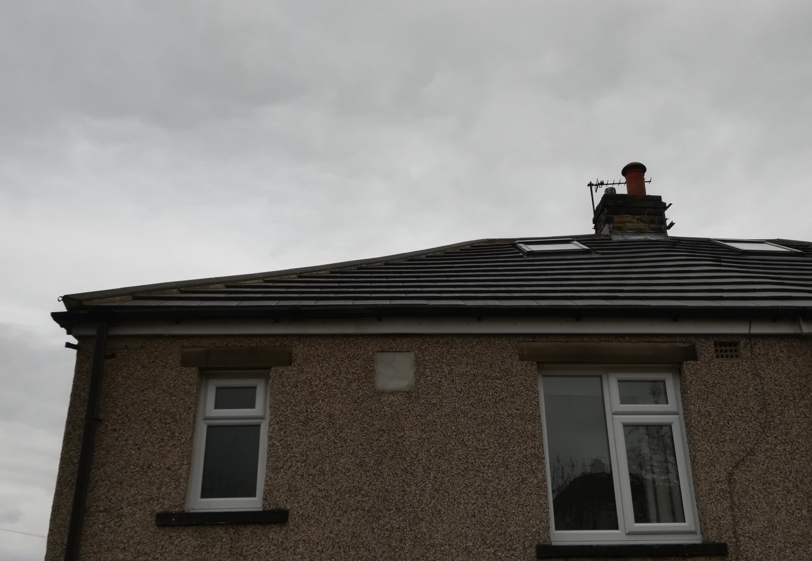

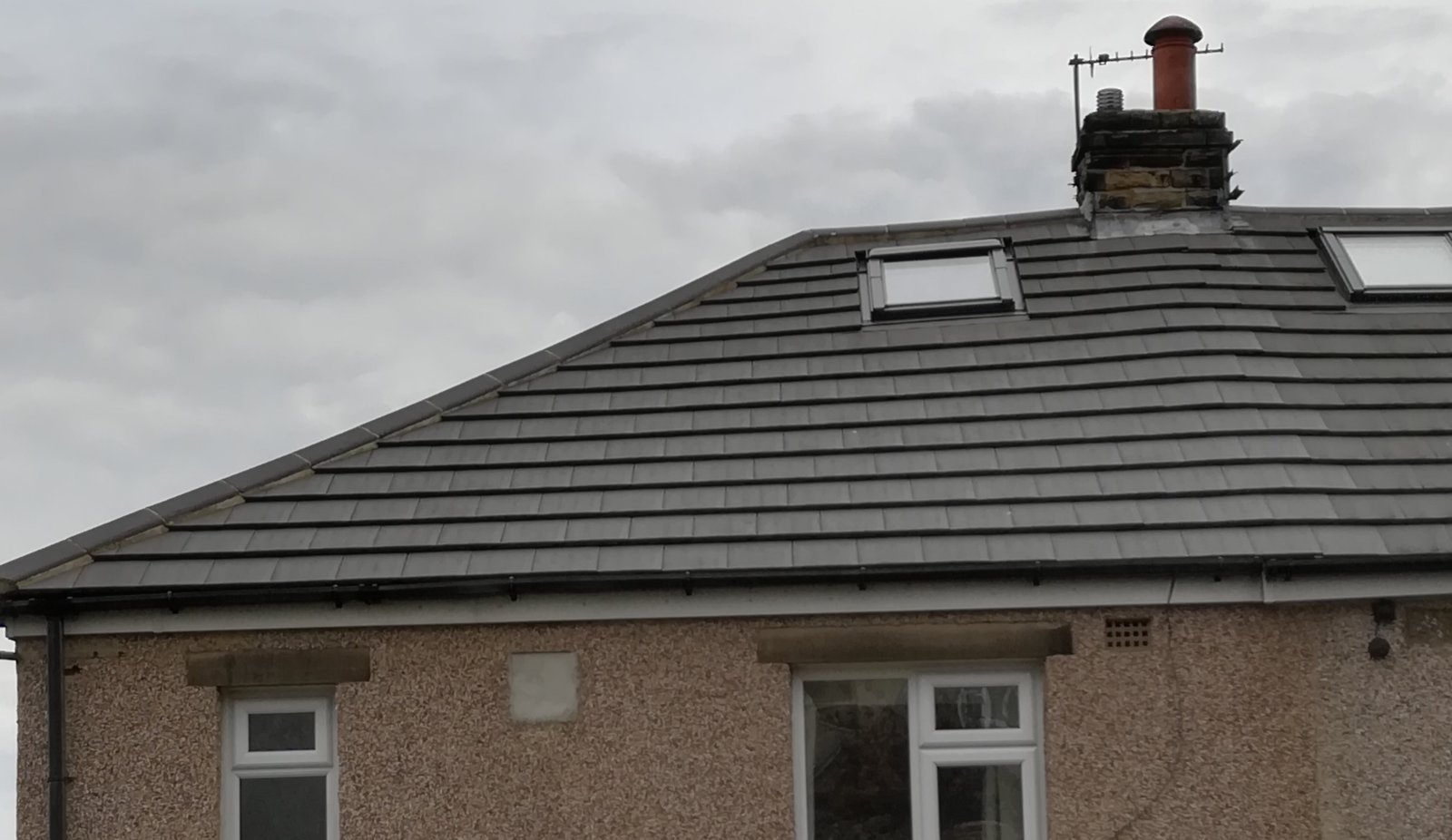

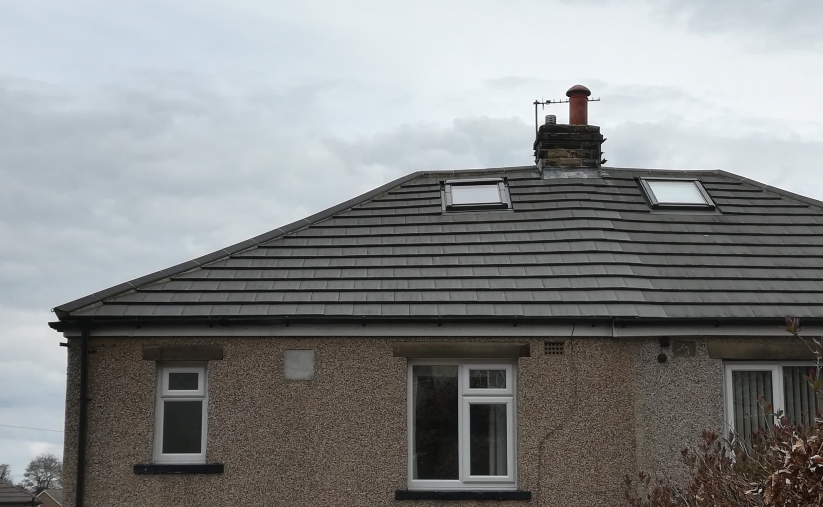

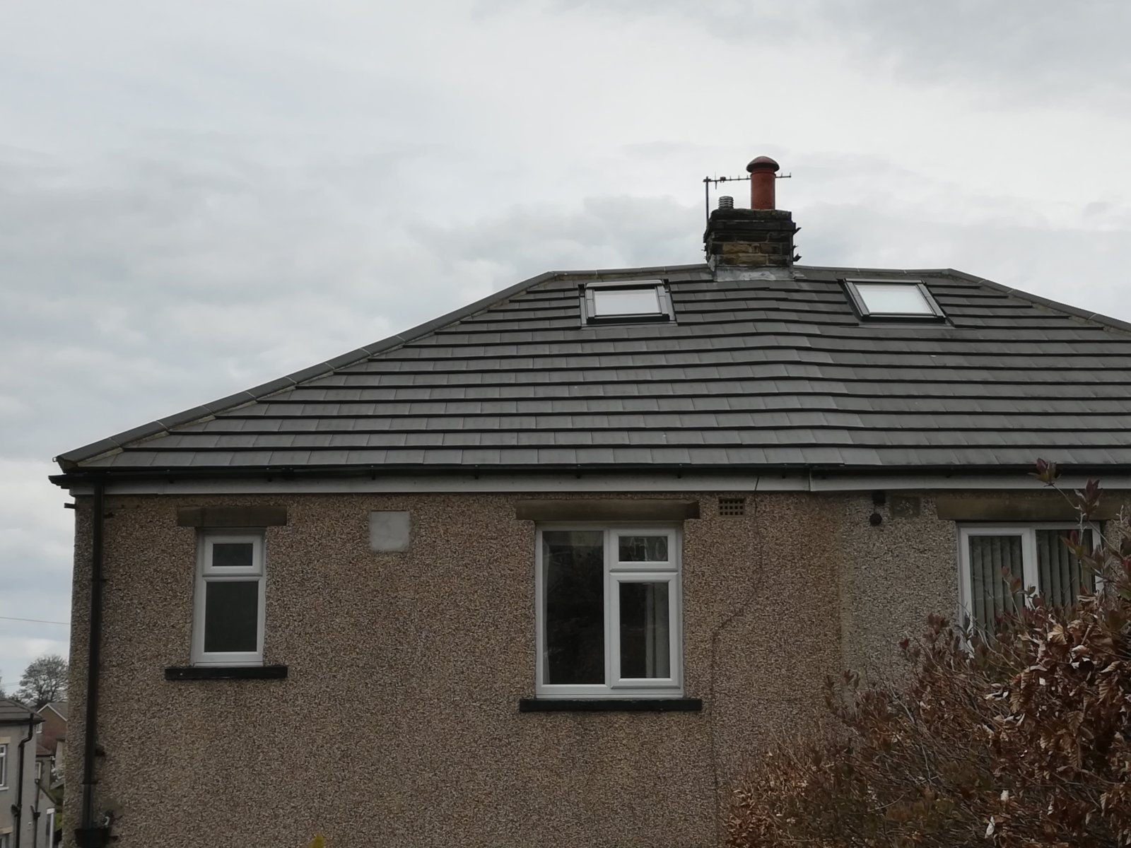

some better quality photos. The sagging is mainly noticeable on the rear of the roof.
The bow is more apparent in this photo. It is very noticeable in person.

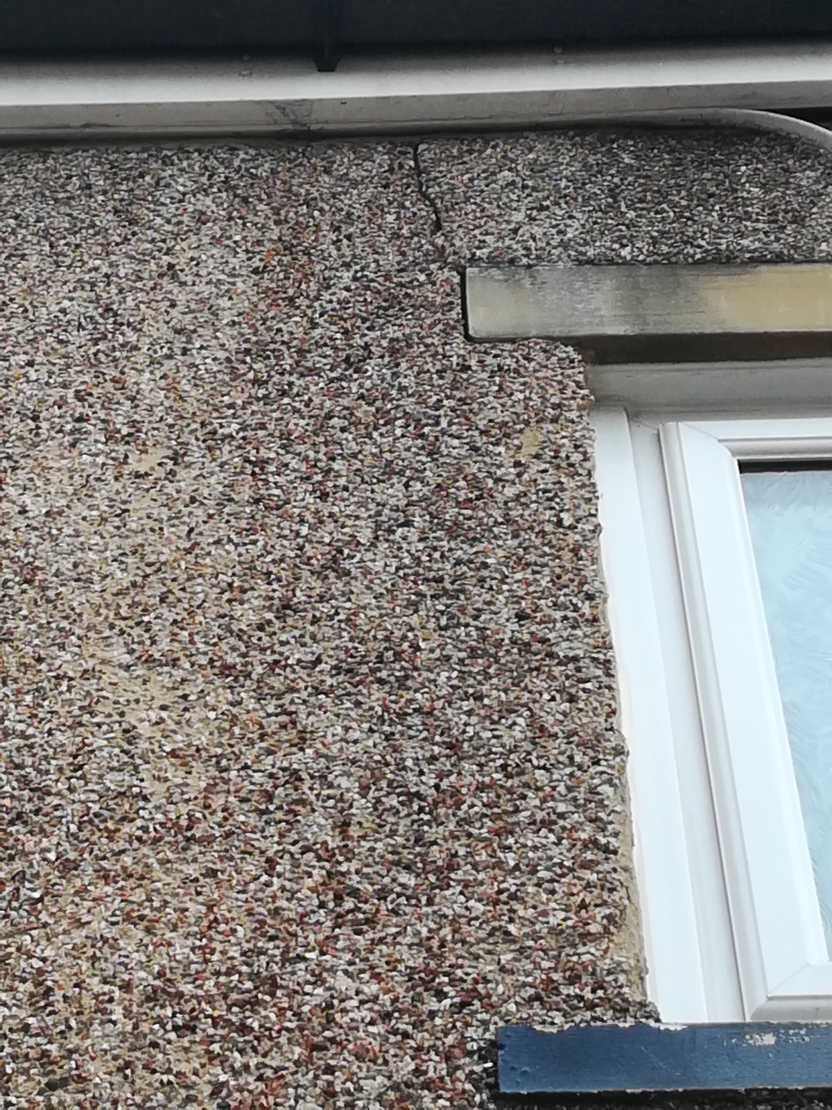

noticed this crack on the side top window. Is this because of roof spread?

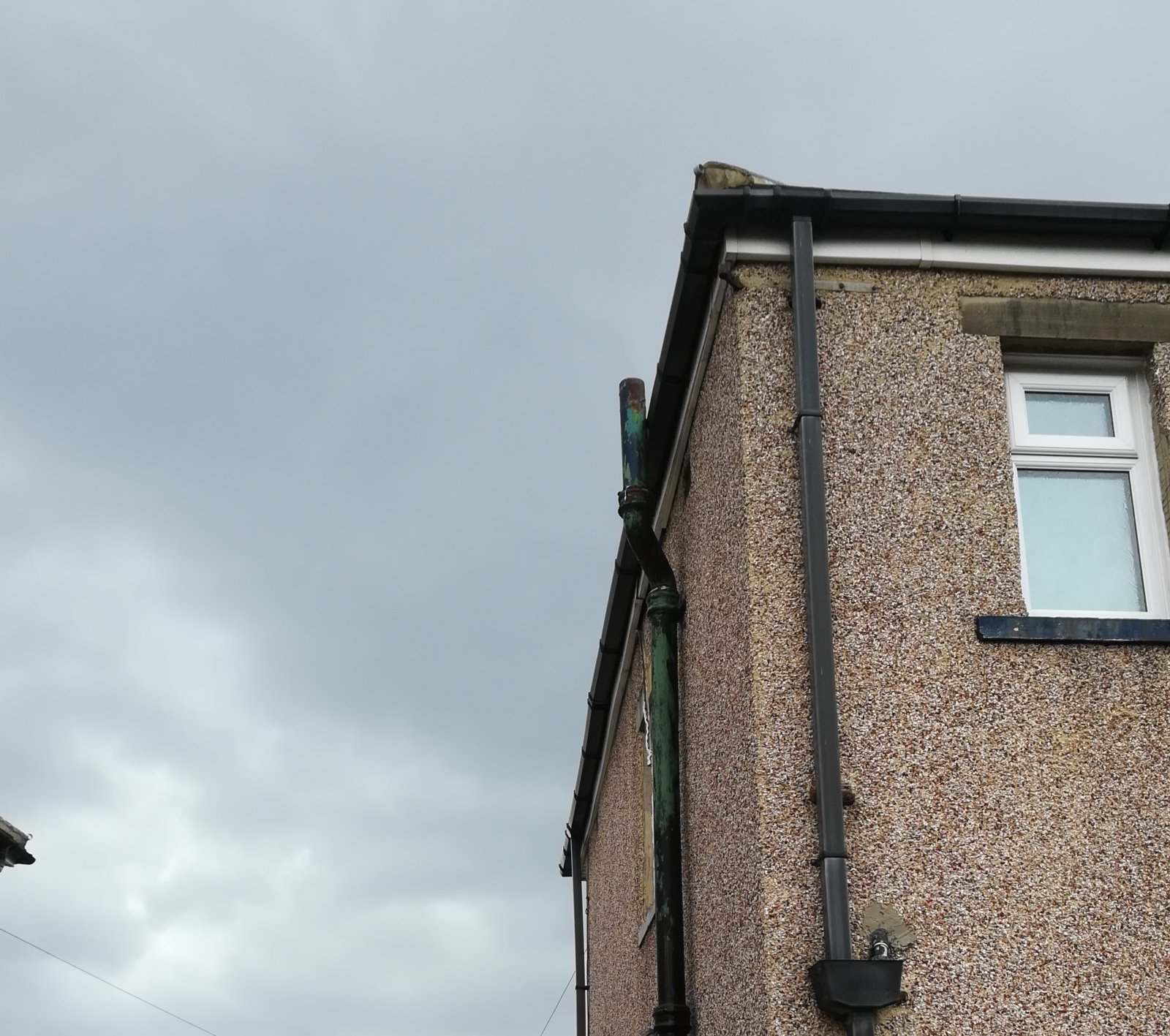

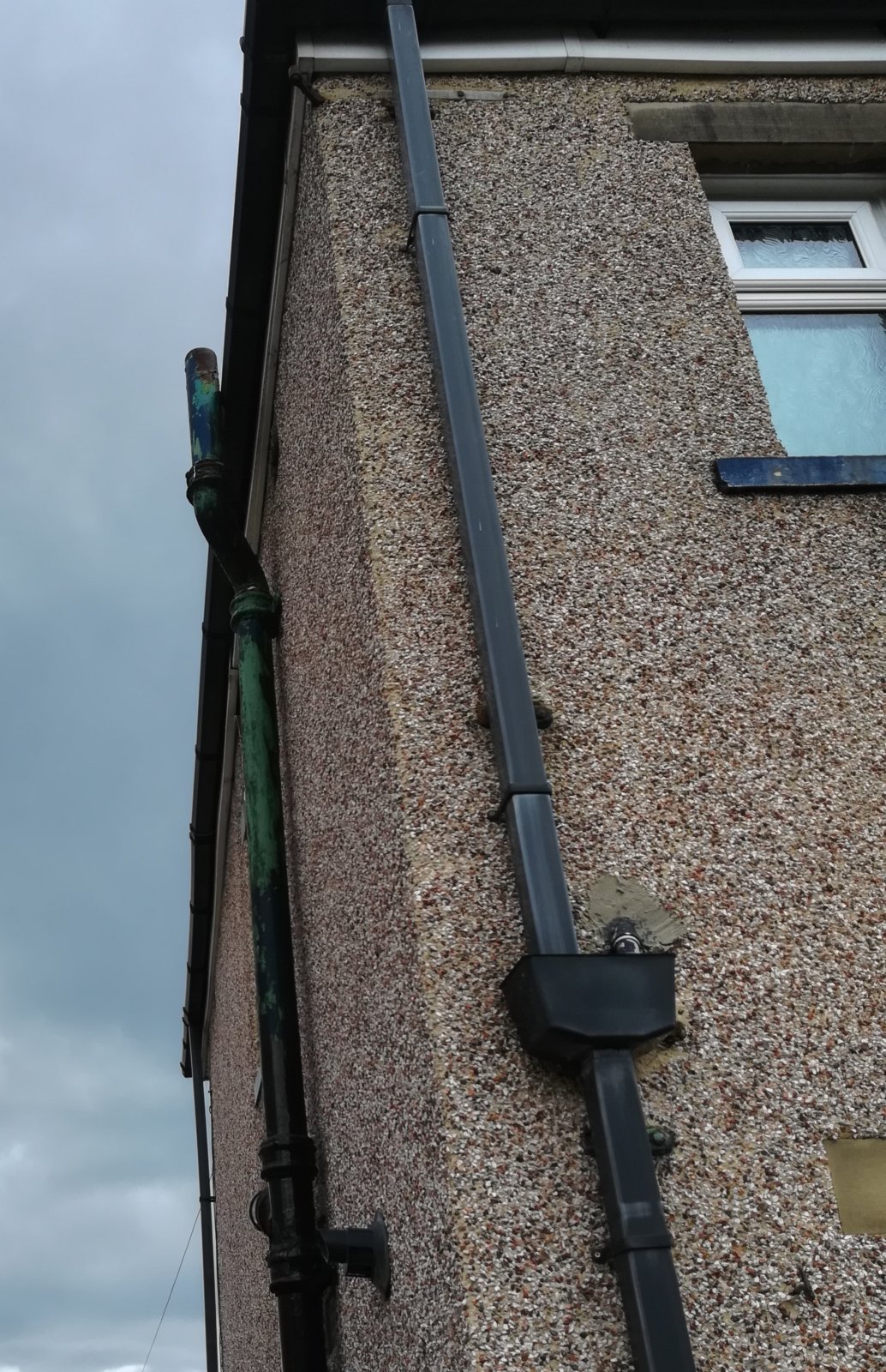

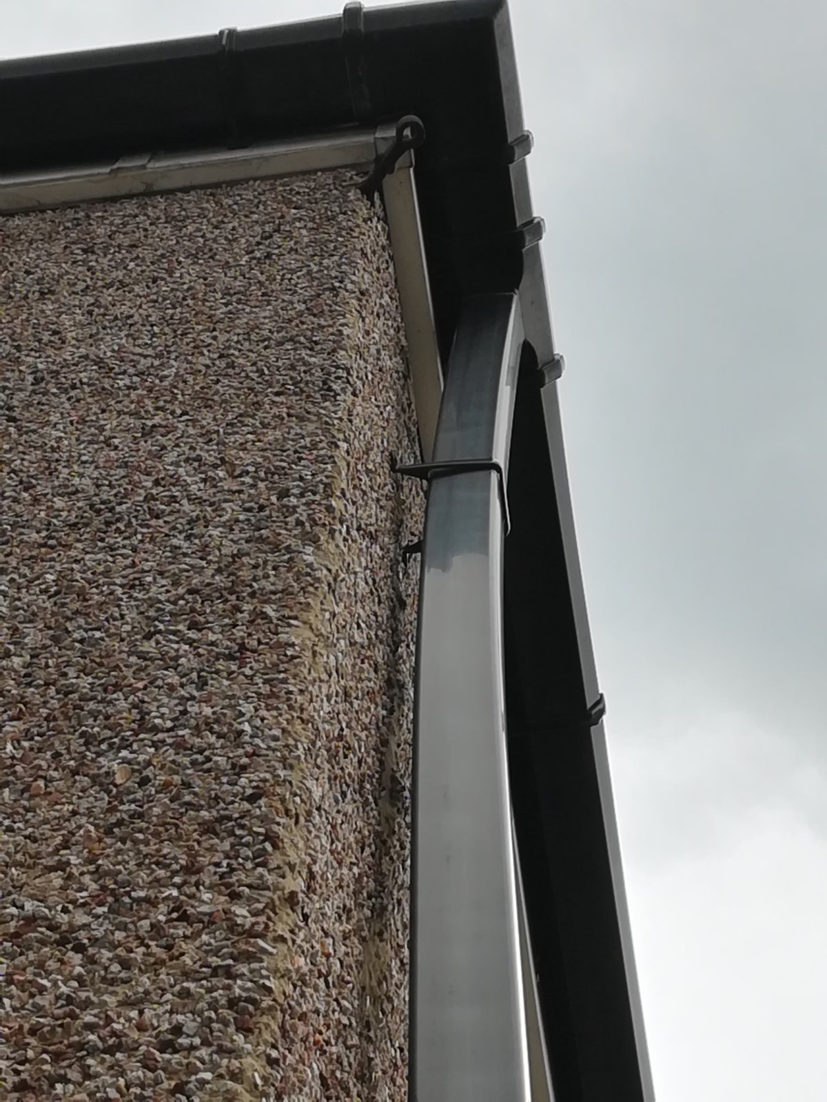

the downpipe joining the gutter is straight at the top. Don't know if this is normal. Same on the side also.
roof gutter on the side is wonky. Also the plastic soffits are coming away from the property in various positions mainly side and back. Front seems ok.
What do you guys think? Cheers
Those are later replacement gutters, fall pipes and soffits - that is just poor workmanship by whoever installed them. Both fall pipes appear to have simply been forced to spring into place, but difficult to do such a short dog-leg.
I can see the apex of each side of the roof seeming to droop down at either side from the shared chimney. I can also see what appears to be some dishing of the flat slope of the roof of both sides of the semi, worst below the Velux. The centre of the roof coming down from the chimney (over the party wall) seems straight, as if that part is very well supported. It all looks straight enough at the eaves.
I'm not sure what to make of the crack to the left of the window, but I doubt it is due to roof spread - it seems the crack is in the wrong direction for spread, unless the hipped part is spreading out.
Best get a professional opinion on it I think!
