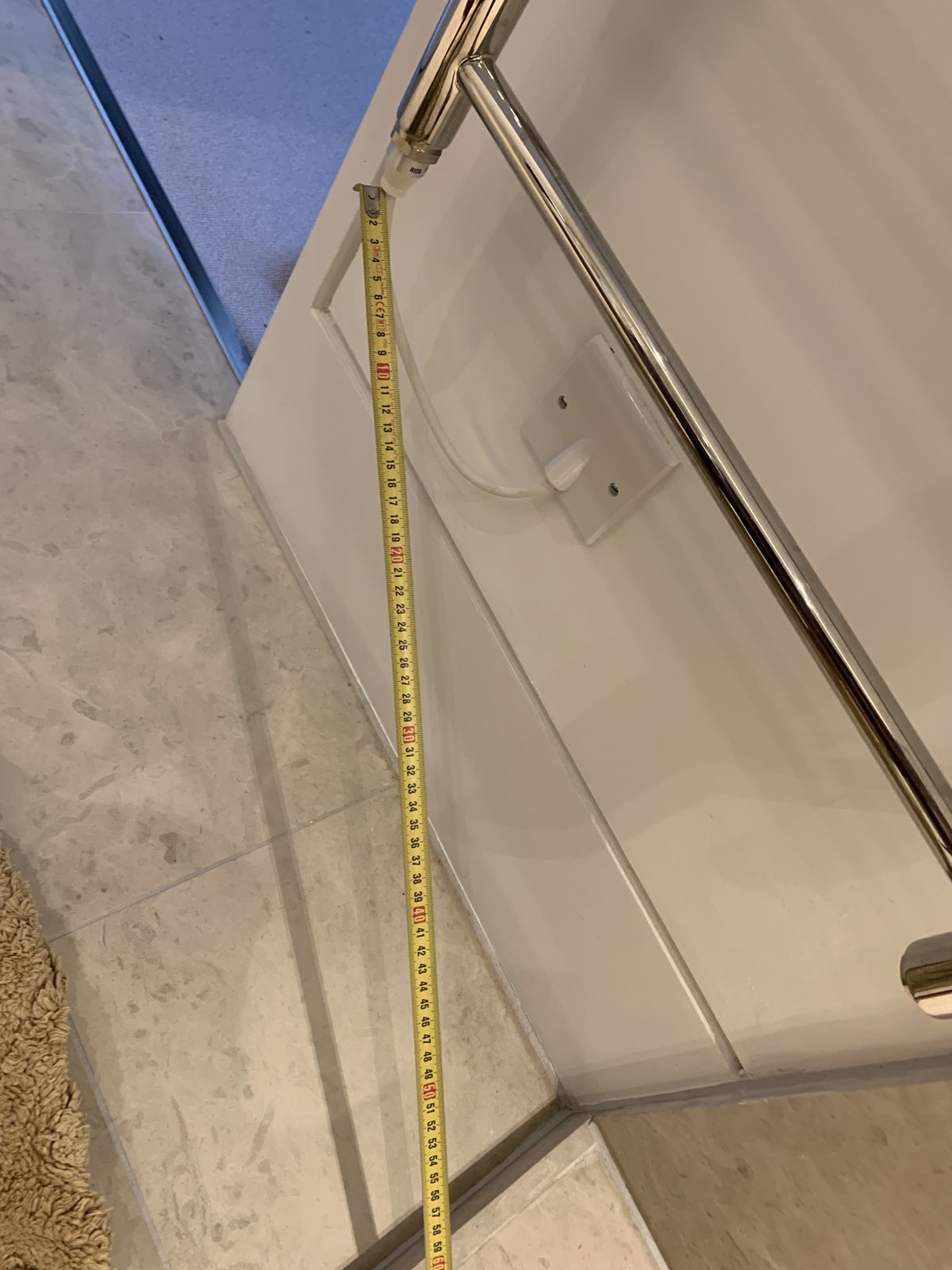

Thank you very much for the help. It’s not intentionally a wet room and the element is bang on 60cm from the edge of the shower (see pic).
If I added the timer I wanted then it’s size would eat into the 60cm so would not work.

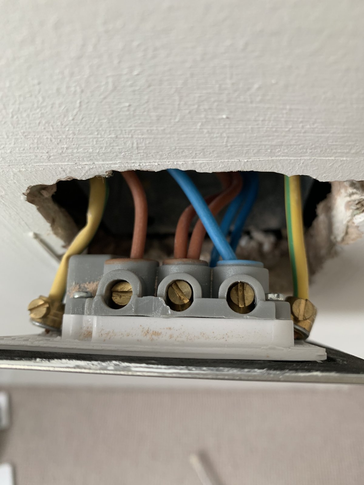

I popped open the white flex outlet and it HAS been used as a connector and it is less than 60cm to the edge of the shower. Annoyingly the flex is not long enough to pass through the wall to the fused spur switch. Do I have any other options other than to call the house builder to sort it?

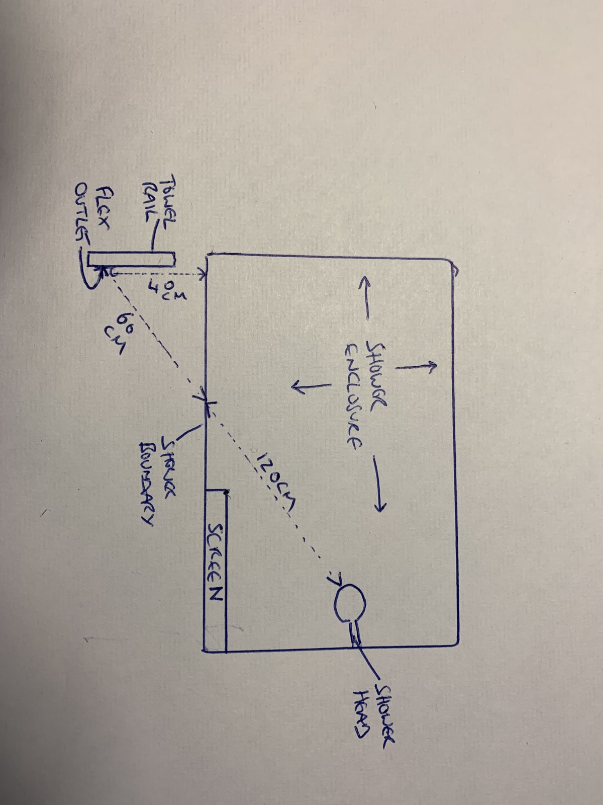

In a straight line from the plug hole (the shower head is directly above the plug hole), the flex outlet is about 180cm away including 60cm from the edge of the shower to the flex. See pic (not to scale).
But the flex outlet is still being used as a connector, is this a problem given my diagram?
This is quite interesting:
Firstly, a towel rail is allowed in zone 1 or 2.
IF you treat the room as a wet room - then >1.2m. from fixed water outlet (in a vertical plane) is outside the zones so you have no problems.
IF you treat the shower as a cubicle - then <60cm. from the edge of the cubicle is in zone 2 so, a switched accessory would not be allowed. The flex outlet being alright.
So - all in all, I would say everything is fine.

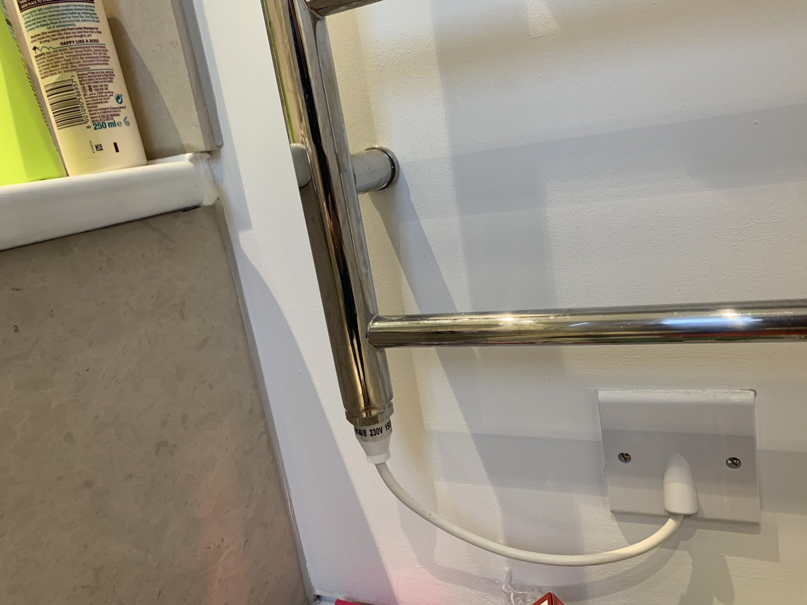

I also checked the other bathroom and same thing - see pic. That flex outlet is less than 60cm from the edge of the bath (where that shampoo bottle is) and it does have connections in it... you think this is OK too?
Yes.
No, the regulation says "In zone 2: switchgear, accessories incorporating switches or socket-outlets shall not be installed...".
Perhaps I should have realised that right away.
Yes.
Sorry if I’m being thick, but you’re saying that the regs say I shouldn’t have the flex outlet with connections in it in Zone 2? If so, then the other bathroom (the last pic I posted above) is also breaking the rules right?
No, it's only switched accessories (accessories with switches) that are not allowed.

Having pulled the fused switch spur open on the other side of the wall, there are more wires than I was expecting! So I may be back with a quick wiring question!

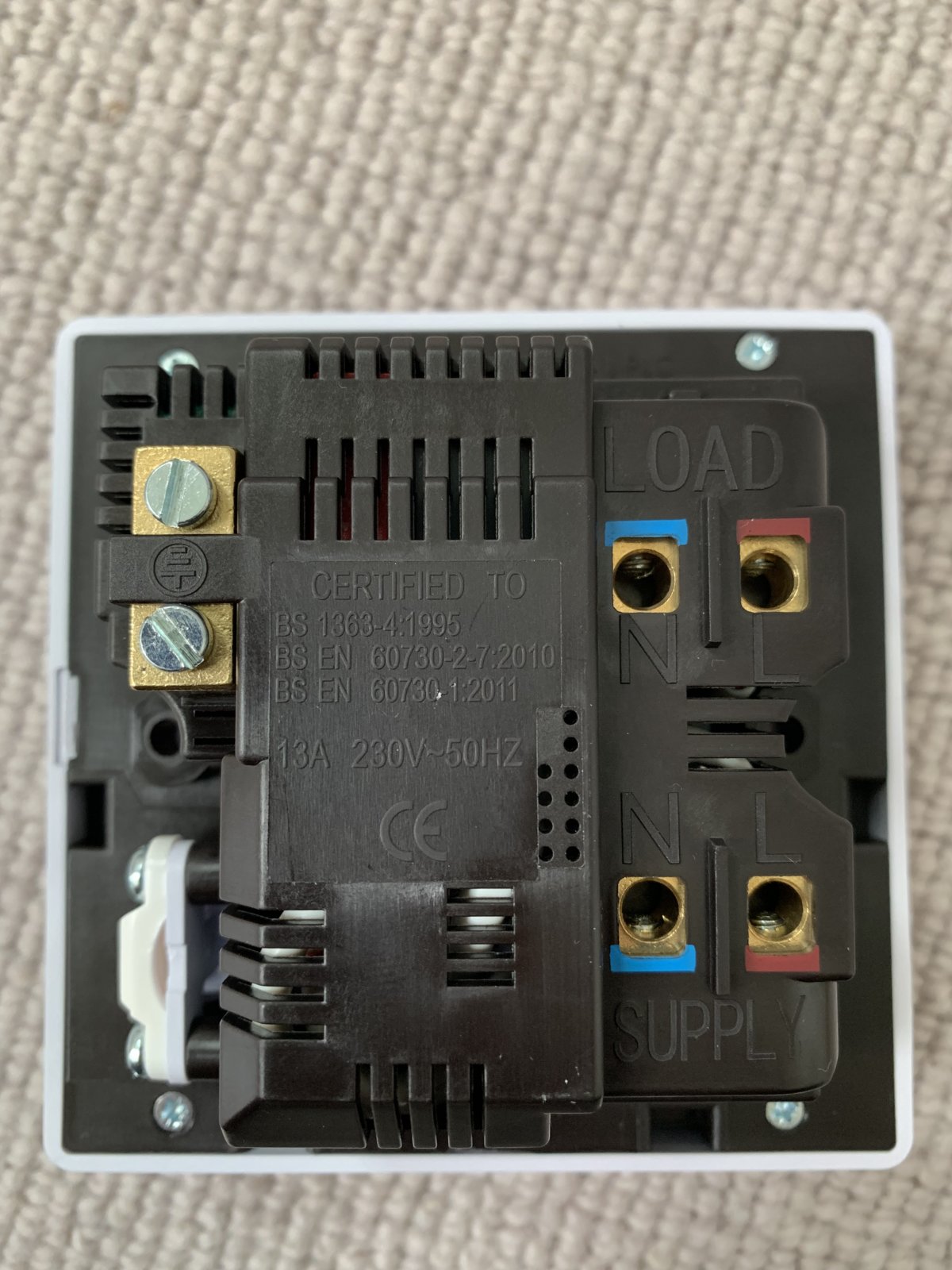

Hi again, I have now picked up my new Fused Timer Spur Switch.
On the back of the old one (showed connected in the pic) it’s labelled as to which is load/supply so should be easy for me to wire.
However there are two earth wires as you can see. I presume that I just connect these to the earth terminals on the new switch? I only ask because as you can see the old one is a metal switch and the new one, also shown in pic is not...
