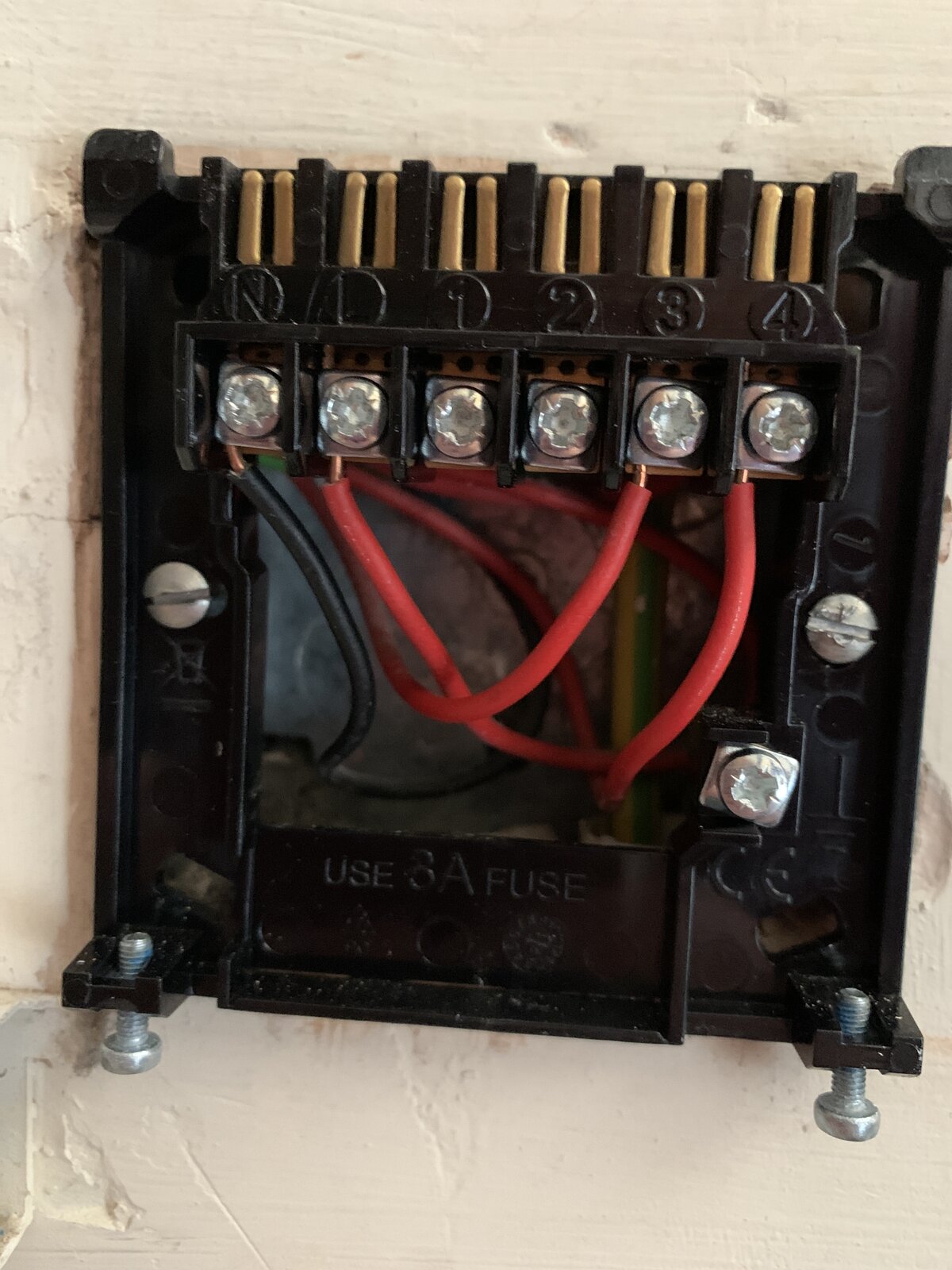

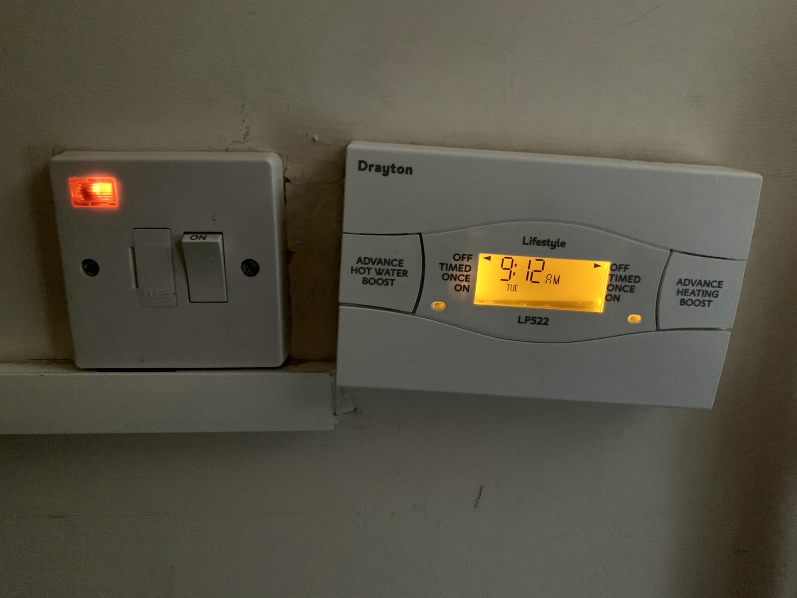

I have a simple set up with a programmer opening a motorised valve/actuator to operate the central heating. Recently the heating stoped working. The valve still open scans closes correctly but I replaced the programmer - connections were the same as the old one (N L 3 4). I get the heating to operate using the switch on the left (in the picture) but not by using the programmer. I’ve checked the correct terminals are wired. Any other ideas what might be happening.
It looks like the programmer is set to 'off' for heating and hot water. You'll need to get the arrows pointing to 'on'. You'll also need to set the 'timed' or 'once' programmes set to whatever times you want them to come on/go off before you can use them. Look in the manual or leaflet that came with the programmer.
Yes exactly! And the heating is working. I can operate the heating using the single switch.
The switch to the left appears to be the switched fused connection unit that sends power to the programmer. So if you select heating via the programmer, what happens?
Nothing happens. If the fused switch is on the heating comes on even if the programmer is in the off position. Power also goes to the programmer.

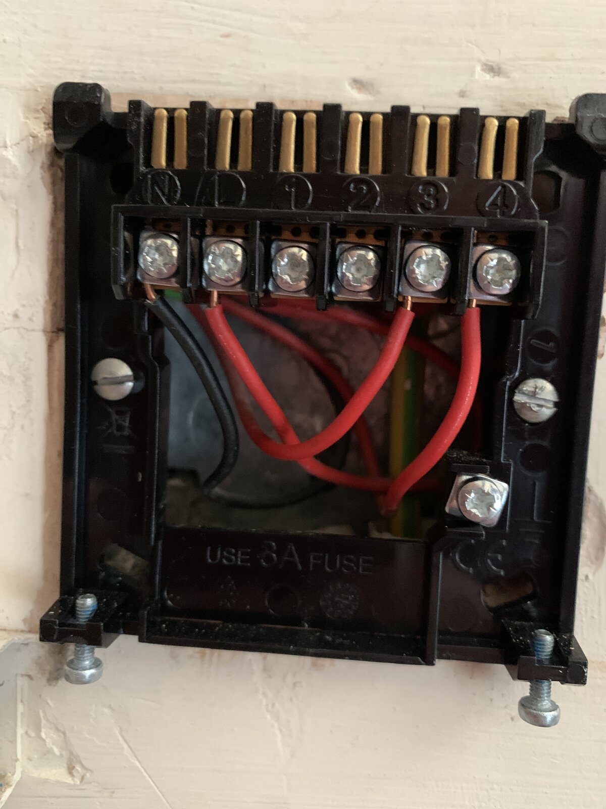

Sounds like a wiring fault or motorised valve failure. Did the same happen before you changed the programmer? Can you post a photo of programmer wiring?
Yes. It happened with the old programmer. So I thought the programmer was faulty so put a new one in. But still the same issue.

With so many options a picture of the programmer alone does not really help, even the wiring does not help that much as plumbers it seems are colour blind and even seen green/yellow wires used for line, where really should be only used for earth. And it seems they don't carry brown or blue sleeving as often a blue wire used for line.
The one thing we can consider as having correct colours is the motorised valve, cable fitted by the manufacturer so in the main we work back from the wiring centre where the motorised valve is fitted.
So more of a description so we know what plan is being used, and picture of wiring centre wiring, and programmer wiring etc.
