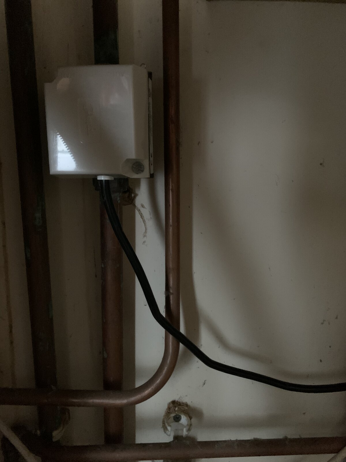

Well, it shouldn’t, so must be getting a switched live feed from the fcu
I agree it shouldn't but seems far more likely line feed is from the motorised valve.

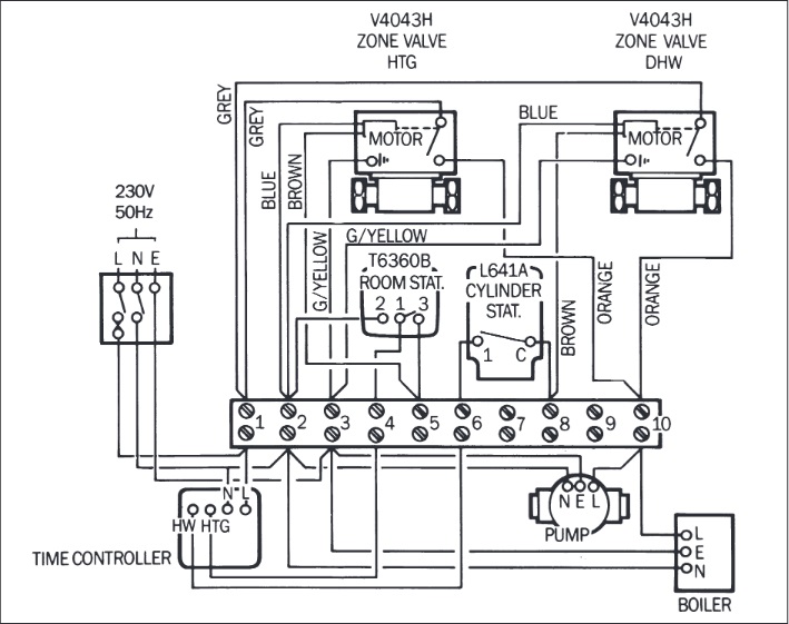

Standard S Plan

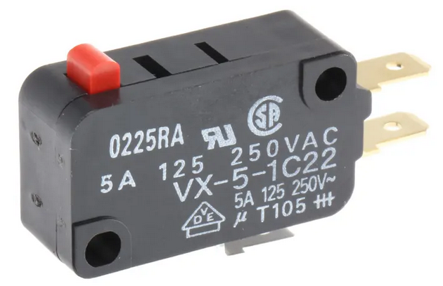

So line to 1, on to grey, grey to orange, which fires boiler. The V3 micro switch upload_2022-4-5_14-57-25.png can easy stick in, so next question is when you switch on/off at the programmer does the motorised valve move? Often you can feel if the valve has opened using the bleeding lever and feel the resistance on the lever.
You can't easy change the micro switch, need to change whole head, but common fault for switch to stick in.

This leads me to look at the wiring centre, i.e some thing where a mistake could easy be made.

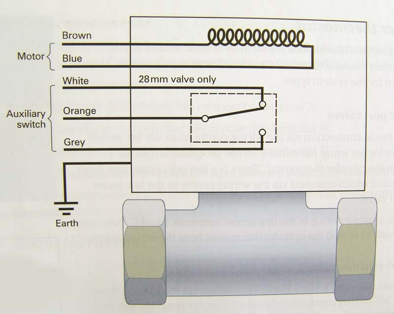

I am considering two faults, either the brown to motorised valve has been put in wrong hole in the wiring centre, or the motorised valve has change over contacts upload_2022-4-5_21-5-49.png and white and grey mixed up.
I am assuming you have some common sense and so looking for an easy error for some one with some sense to make, rewiring a switched FCU does not seem to be some thing some one could do in error, so this points to the wiring centre, where much easier to make an error.

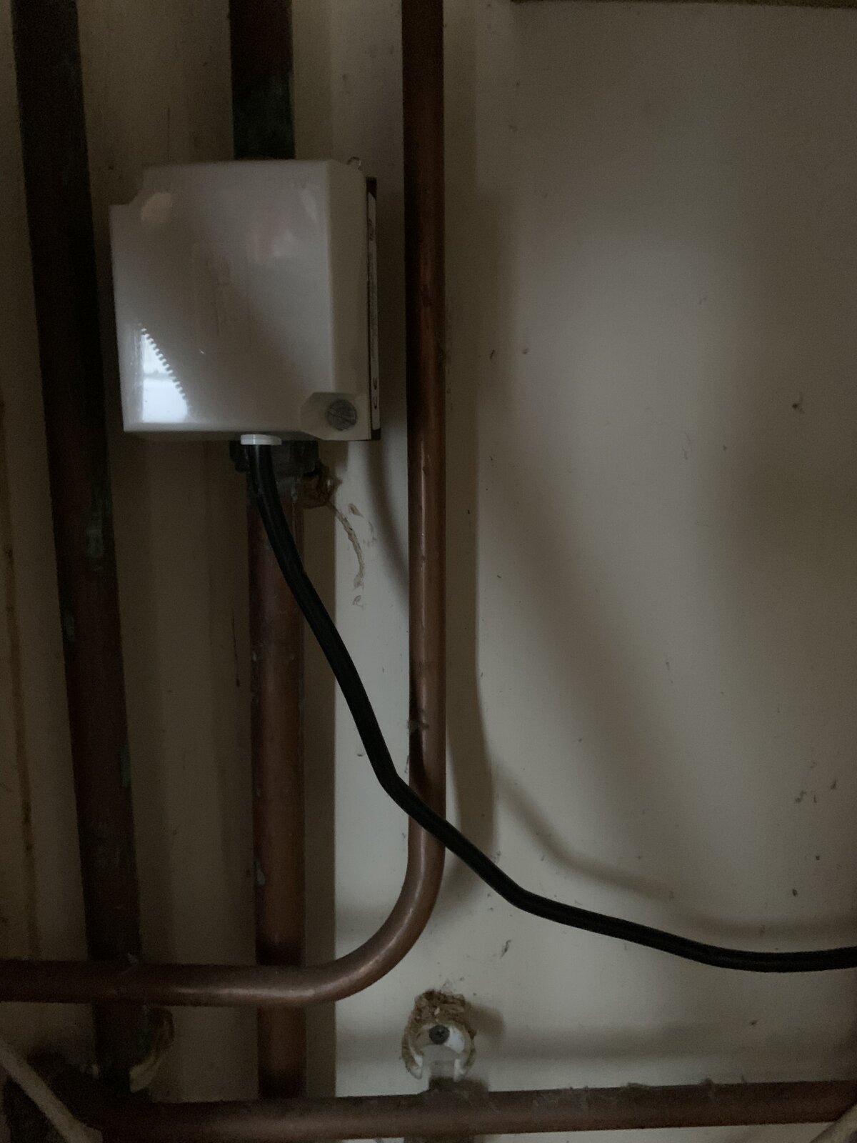

post a pic of the motorised valve you mention, I think you have 2 not 1, your wiring pic isnt very clear but looks like an S PLAN so you will have 2 x motorised valves
The original installation had 2, but this was changed some time ago so now only 1.

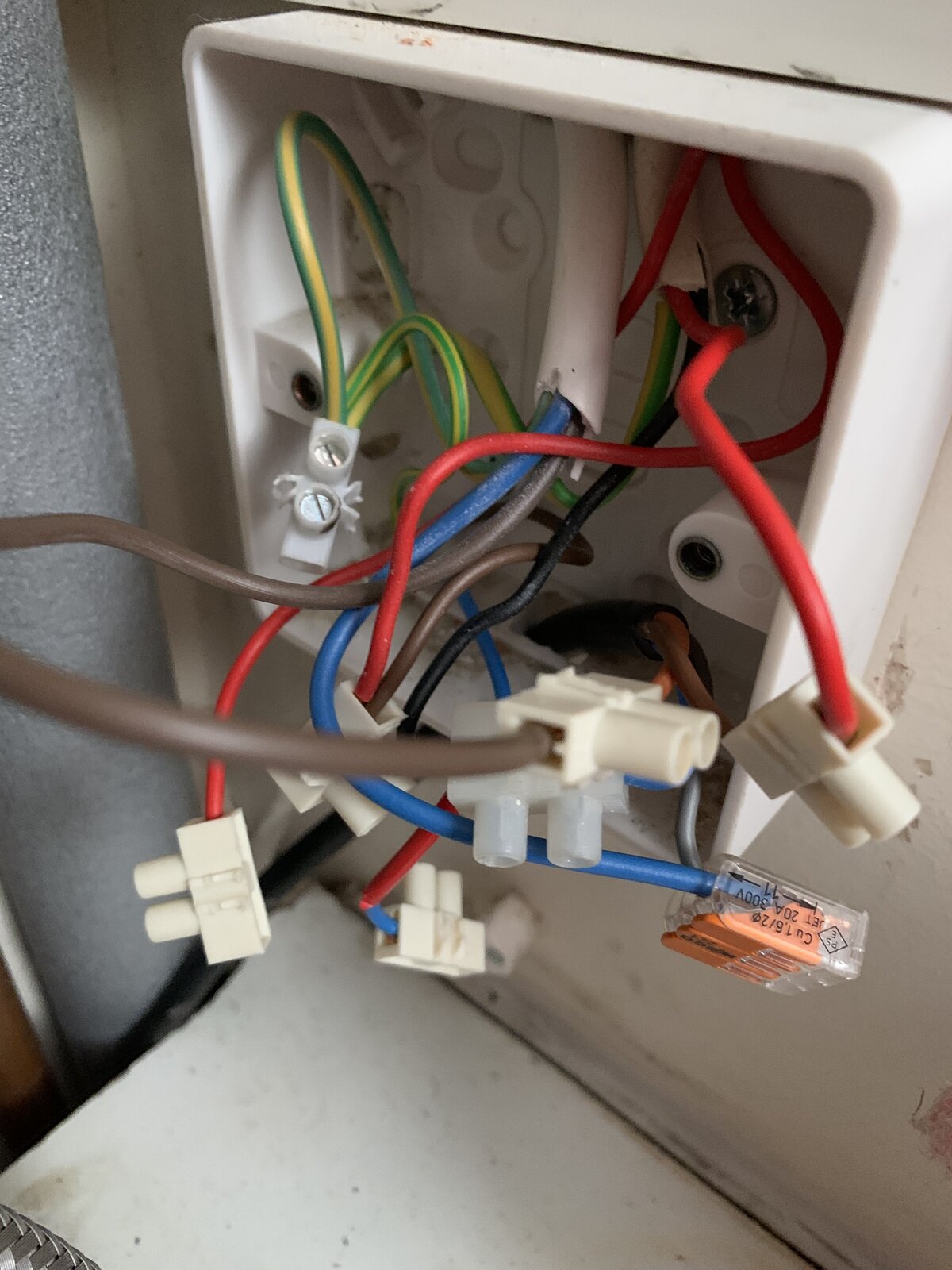

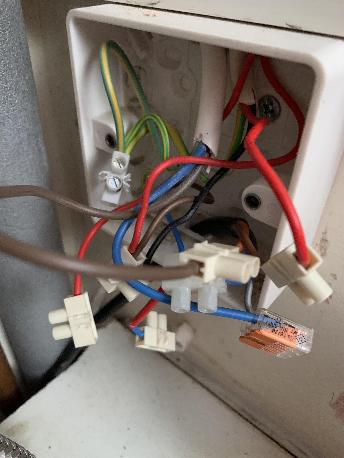

This might be why it’s working the way it is. Can you post a photo of motorised valve and inside wiring center?
That is a total mess, your programmer is wired for S plan, which requires 2 x motorised valves, you say you only have 1 so it will never work correctly
