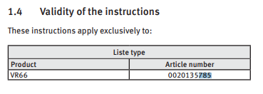

Mine is, problem is the label only says VR66 (and manual) so it can be confusing for some. I bought a new after my post you saw previously.

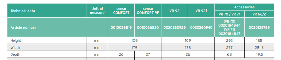

Model: 0020135785
Are you sure you are not thinking VR65.
Ive checked the spec sheet and it shows allowed model number. (this was the VRT not VRC) but anyway it used to confirm part numbers
This is a cut from the VR66 manual, the front page just says VR66 but it all talks about the correct part number.
The part numbers haven't changed so will be the correct part number, but probably not the newer version. It needs the /2 label as shown in the sensohome picture you've posted. I'm not 100% sure there in circulation yet. It may work but its not the one its designed for so could have compatability issues.
