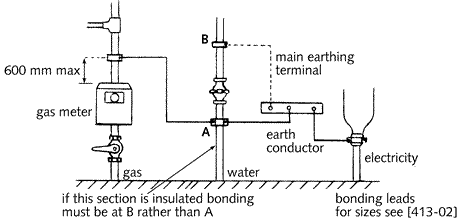

It doesn't matter how far away they are - incoming service pipes must be bonded to the main earth terminal:

The supply pipe coming in is not the issue with regard to bonding - it is what is on the consumer side: after the meter or stopcock.
If these are copper/metal, they will need bonding, basically as close as poss. to the meter or cock.

Bonding of gas and water supplies is not done to improve the electrical earth. It may do this, but it is really the other way round. It is done to make sure the supplies are at the same voltage as the electrical earth system. Connecting an earth rod directly to the water supply where it enters the house would actually make matters worse.
The electrical earth should have its own dedicated method of connecting it to the outside world earth. Here this seems to be by connecting it to the cable sheath coming in. That is how it is intended to work, and should be fine. There is one point alongside where your electrical supply comes in which is the official reference earth for the whole house.

No. In fact to measure it you have to disconnect the main equipotential bonding - which is there, as stated previously to make sure that all means of bringing an earth potential into the property are at the same earth potential.

If a pipe entering the building is plastic, then it is not providing a path to earth, and therefore nothing connected to it can provide a path to earth, so there is no need to bond subsequent metal pipes to ensure that they are at the same potential as the installation earth....
