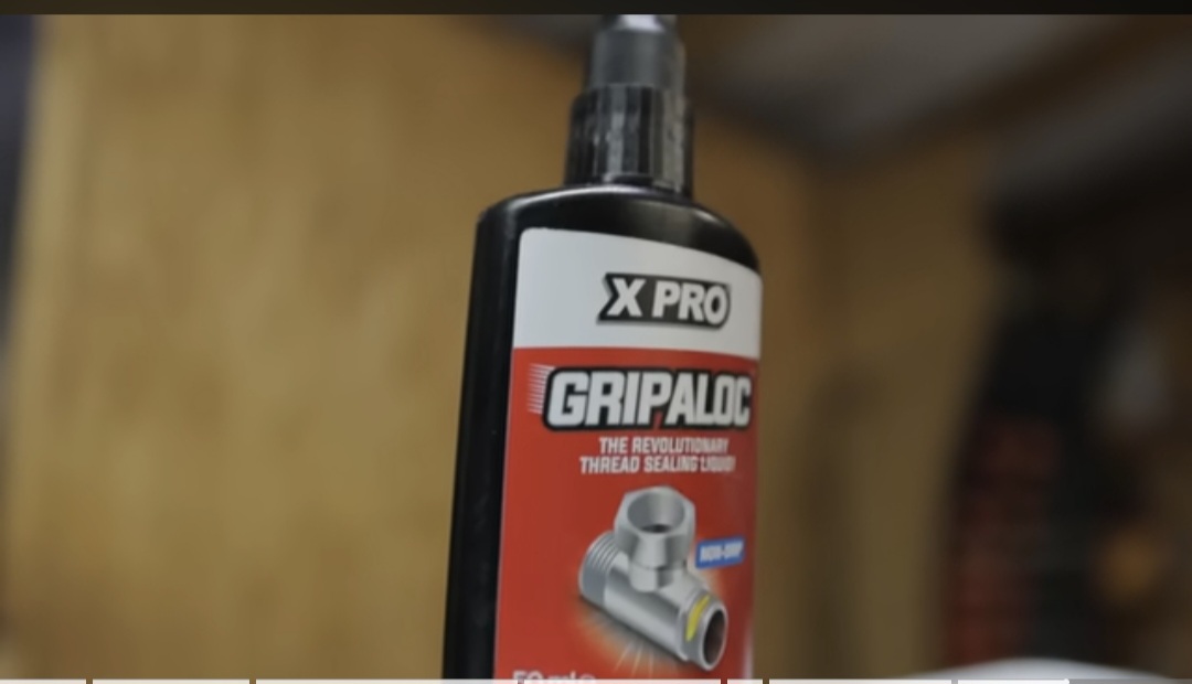

Is the liquid as good or better than ptfe tape for rad tails? Also when fitting copper, should ptfe tape be wrapped around the olive?

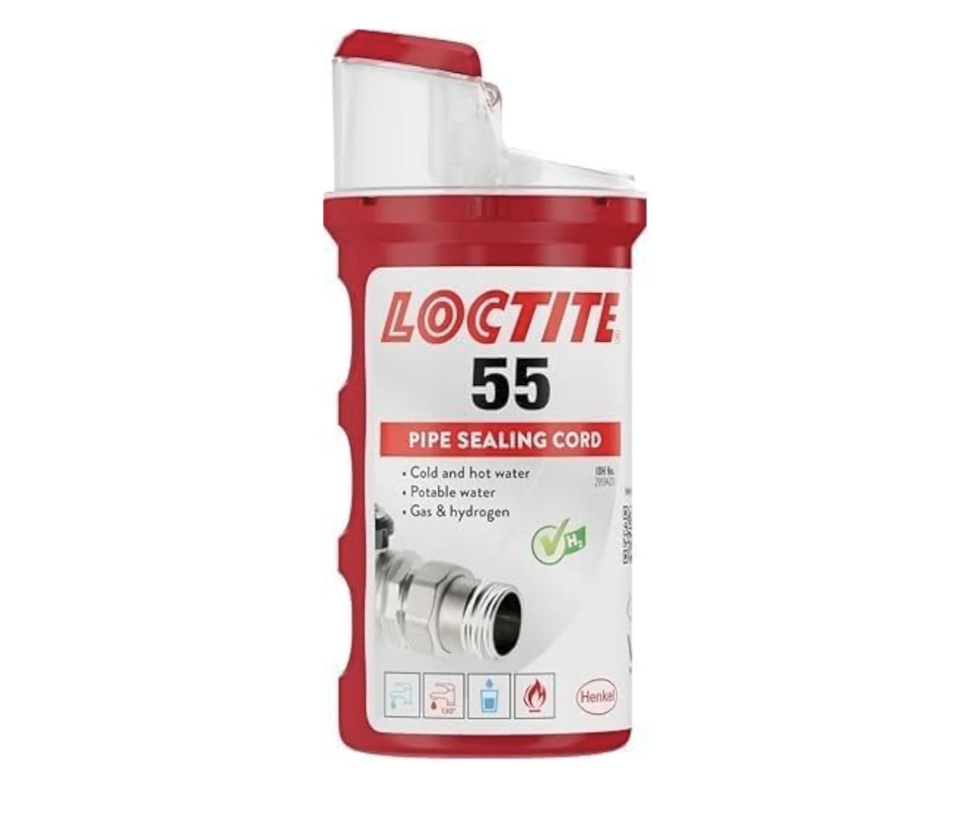

Loctite 55 dont use anything else.

Liquid PTFE works well in new pipework but not if there is moisture in the pipe and you need to put a tiny blob inside the fitting as well the same as you do for threadlock.
Loctite 55 is great stuff but can look very untidy when fitted to rad tails unless you cut the excess back afterwards
