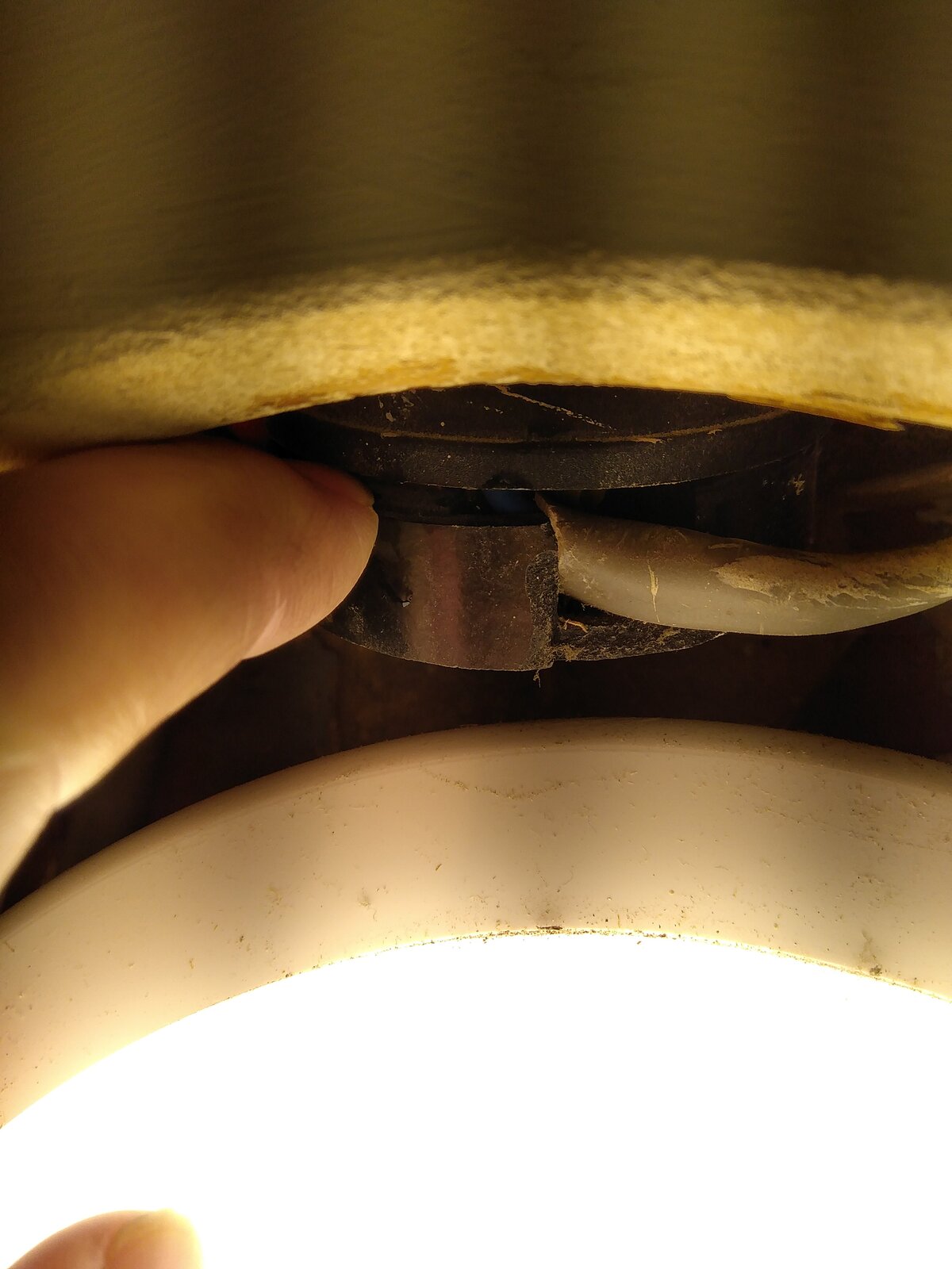

I went for a quick pint on a local High Street pub this Afternoon (first time in several months) and have finally taken a picture I have wanted to post on here for a long while.
The JB is fed from two Pre-Harmonised T+E cables with a short piece of Harmonised T+E feeding the light immediately below.
Although everything I can see myself with it is not totally obvious in the photo, there a several issues about it.
The lid is not properly secured (the finger you see in the photo is mine!), you can see a glimpse of blue insulation but a bit further to the right, you can see brown and red conductors in the same terminal (i.e. Line conductors), although not visible in the photo.
This is just a case of me thinking this situation is not exactly ideal is it?, but there again it is a pub so say no more.
